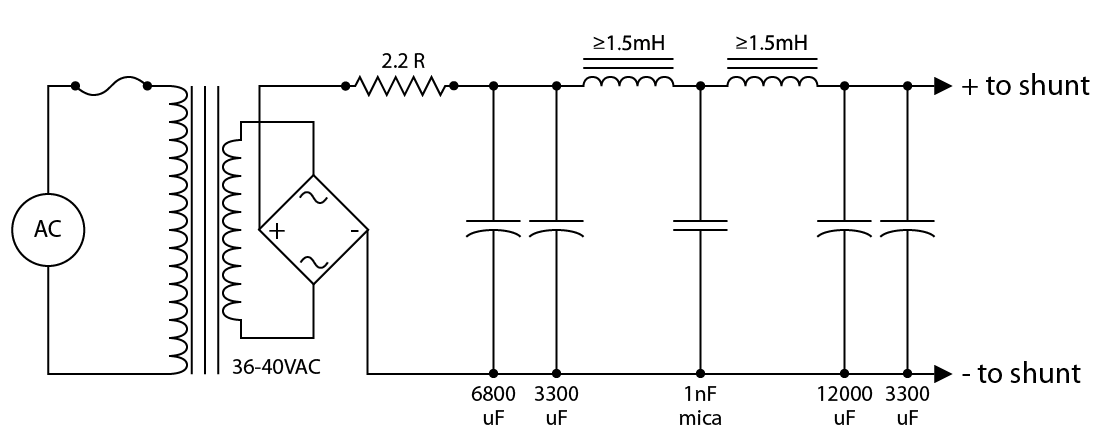

I am gathering parts for the 1.2R shunt and the pre-shunt filter.

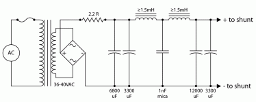

A while back, SGregory spelled out his filter, no schematic. I made a schematic of it, attached. How does it look? SGregory, care to comment? Does one need that many uF's to adequately pre-filter?!?

for the 1.2R shunt and the pre-shunt filter..........I made a schematic of it, attached. How does it look?
The rCLcLC PSU would work pretty well feeding straight into a the RIAA stage. You have ~25mF and two inductors in there for good ripple and interference attenuation.
You are going to use a Shunt regulator between the PSU and the RIAA. I think you can cut back significantly on the cost/bulk of the PSU.
That little 1nF in the middle seems a nice touch. Another (or bigger) across the secondary and across the primary might give even more attenuation.

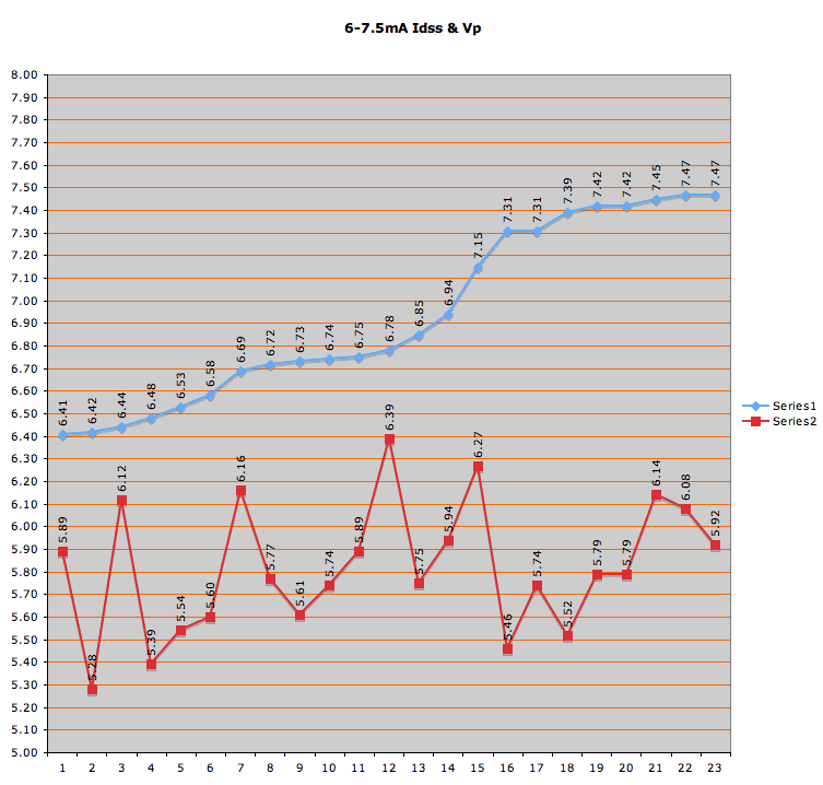

I'm in the process of measuring Vp on all my 2SK170's. Doing the 9mA Idss batch at present. Vp's seem to be falling in the 0.5-0.65 VDC range overall, with occasional spikes to 0.7vdc.
Test- same conditions as Idss tests- ~10 min. per jfet to settle. Ambient ~70'F. 9VDC w/ 1M res from source to ground.
Attached is a screen shot of my 6.5 to 7.5mA Idss batch. Idss- blue; Vp- red.
PLEASE NOTE- in the below chart, I multiplied Vp x10, so it can be on the same chart as Idss; makes for easier comparison.

Almost done with the sorting. Decided to have a 1% tolerance in pairs (on Idss and Vp). This way, I get a dozen pairs to use..I got a friend that might like one built. If I went to 0.5% it would be only 3-4 pairs.

If you can't detect any trend, i.e. the points are scattered all over the place, then your measurement technique is swamping the differences.
I do see a general pattern, on average Vp increases with Idss. 8-8.5mA averages ~.62 mV; 8.5-9 ~.64mV; 9-9.5mA ~.65mV. But there is a large variance, I would say 10%+ between some values. I can post the Vp results later. The 6-6.5mA range I posted earlier had the most variance of Vp.
I would say it takes around 5 min. for the Vp to stabilize. Usually starts ~15% above final settled value. Some settle faster than others.
Do you think this ~10% variance is caused by my measure technique?

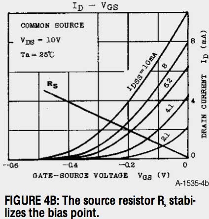

Pay more attention to IDSS matching I would trust. It should have a general smooth trend for more -Vp as IDSS rises than those peaks. Maybe some samples would need more than 1M to go really OFF?
I do see a trend. Some need more to turn off; I'm hoping this test will show that.
As the operating point is very close to Vgs = 0; small changes in Vp aren't going to really affect much, just slightly change the curve slope. Idss seems much more important (kind of like plate current in tubes). We're not operating the jfets way down at the bottom of the transconductance curve (aka cutoff in tube parlance).
