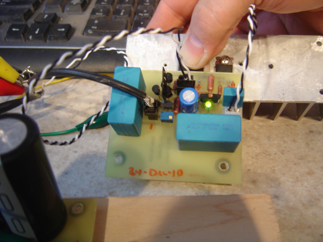

Attached are photo's of the new power supply and V1.2R for my simplistic. After a brief break to play with some of my kids gifts, I am going to breadboard it and fire it up.

I will post a schematic shortly. Right now I am majoring in trouble shooting as I can't seem to get the V1.2R to light up properly. It seems that Q5 is full on dropping the rail to 1 volt.

Trouble Shooting Complete. I have no idea how the error checking routine in eagle allowed me to have a trace error, but it did. Once I corrected it in the software it wouldn't let me redo it? Go figure. My error. Anyhow after a little cosmetic surgery on the board, I now have two V1.2R's up and ready for install.
They hold voltage very well and have no hint of oscilation under resistive simulated load.

The sink on the error amp BJT is a good reason it holds voltage well. Amusingly, the loop gain simulation shows it on the verge of oscillation, as I have shown in the regs thread. When everybody who have copied the 1.2R by now has it working easier than 1.2 on first attempt layout. Its nice I did the mods before I analysed them, bcs otherwise I would have skipped it. Its likely that the real parts and layout behave differently enough. Repeatable so far in a positive way in this case.
It certainly shows no issue of oscilation. My V1.2 was a bear if you recall and had to increase the gate resistor to get it to stop. In this case it was only my errors that prevented a perfect start-up.
FYI, I was able to dial the voltage from 14Volts to 54Volts. In all cases it was stable.

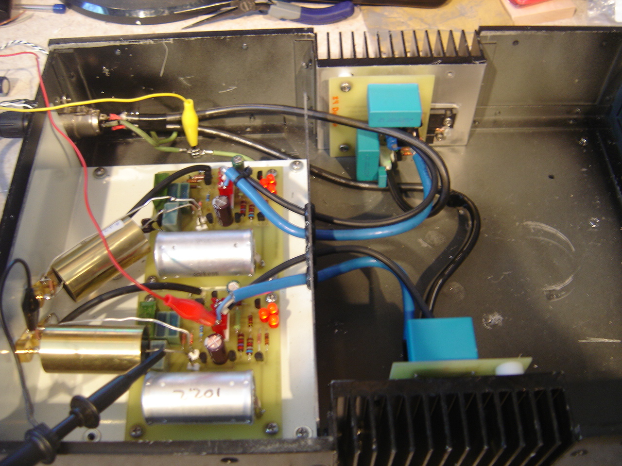

Putting the 103R on this arm is something that I wanted to do. I will wait until I get the Nanook arm up and running to do it however. For Me with 10 thumbs for fingers, installing a cartridge is nerve racking.
In the meantime, letting the system warm-up to give a serious listen. The V1.2R lives in its new home. The RIAA head amp is dead quite even at full volume. I was a little concerned at first until I cleaned the stylus ;-).
