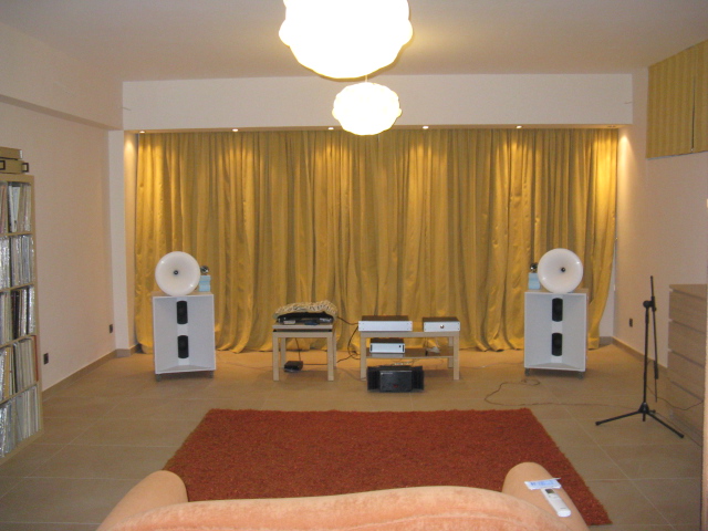

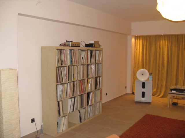

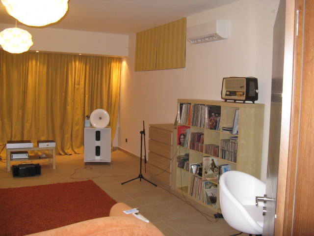

Ok Salas, here are some pictures of the room.
I was planing this for some years, but had not the funds to do it.
Also, right before the entrance is my small electronic workshop!
SGregory, I didn't discuss this much with my wife! When she understood what I was doing, she was jealous and coming up with ideas too, but it was very late then! Now she is just complaining that I spend a lot of time there...

Nice for listening. Spacious enough too. You will find ways to optimise its reverberation sooner or later, the main thing is you started it.
