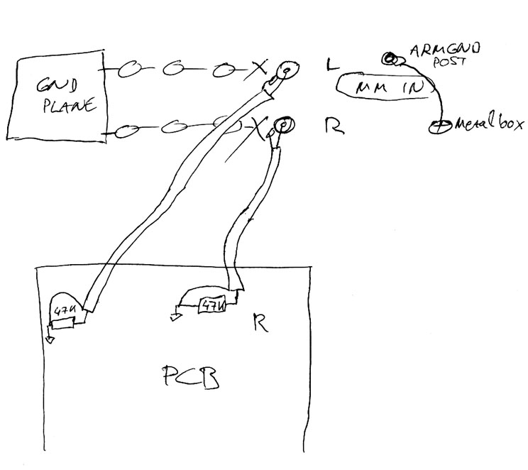

Is your arm grounded? Here is what to do for some initial hum busting, by looking at your pic. Maybe there is more to do.

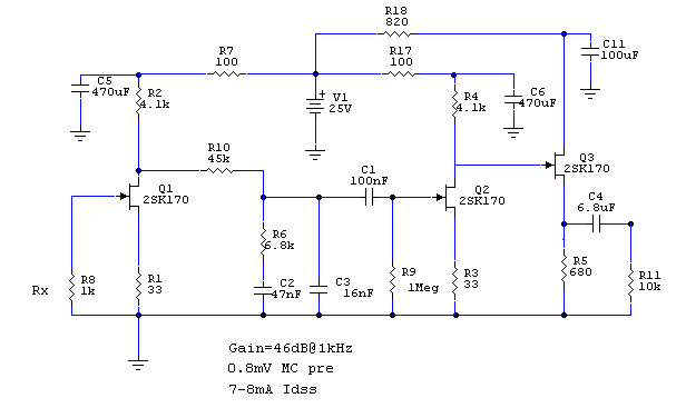

Now that I have added a buffer stage to my RIAA :cool: I'm aware that I have more gain than I need for my DL110. How much output can I get without overloading it? (33V supply, 6k8 drain and 39R source). Can I lower the gain by simply reducing the supply volts and adjusting the source resistors to keep 8V on the drains?
John
diyAudio Chief Moderator
Joined 2002
Try 21V B+. One parallel 6k8 per existing one. 3k4 resultant value for each Rload for stage 1 & 2. Rs stay 39 R. You must get 7.7V-8V Vd and proper gain. Its a rough estimation, trying to imagine your situation, try and tell me to tune it more if not ok.
Joined 2002
Ah, Jonners! I almost forgot. If you find the new gain nicely usable in your system, change the series Riaa filter original resistor (82k//82k) to a single 47k new one, the 6k8 vertical one that leads to the 47nF cap remains the same. Else it will sound toned up in treble.

B+ is now 22V, and a 910R dropper keeps the buffer nicely warm at 11mA :hot:
I had no more 6K8 res to hand, so I used 8k2 in parallel with each drain res, giving 3k7. Drains are near 8V.
Playing nicely, gain is adequate, and a +15dB modulation from my test record into the DL110 gives an output at the buffer of 1.1VRMS.
Thanks again for your help, Salas. :)

Good to know. Its nice that we hit it with one try. Happy listening!
You not only rotate your volume knob more nicely now, you listen with less noise, which is what excessive gain only contributes to a system, along a short throttle.

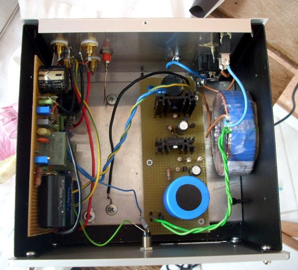

Yet another one. The non cascoded 0.5mV 2 stage version and Vbe Mosfet shunt. Michael made it for his friend that has a Pink Triangle Anniversary with a Roksan Arm. He used a Goldmund pre with phono input, but it is up for sale now.

Nice work there. This morning I built the shunt reg on stripboard, and I'll be testing later.
My hum appears to be a number of things. The armtube isn't grounded. It also seems to be caused by the TT itself! I shall build an external psu for it one day soon, and add lots of damping to the plastic underside too.
