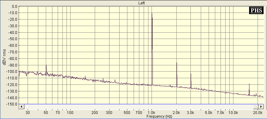

At least I can show you about the simplistic Riaa. It depends a lot on the build for harmonic noise, two box is better, on the gnd execution also. This is a typical measurement I get from the MC 56dB version. The particular chart is from a build with a V1 feeding it from very near, common to both channels with resistive Vref. The TX and rectification, main cap filter, are in another box. 0.02% THD at 0.5mV nominal input. 0dB=1VRMS. Ignore the 16kHz line, its an artifact that I get some times from my card and software.
Fun you shall have, sir.
Regarding your noise issue, the simplistic RIAA on its associated regulator proves me besides being highly musical- good favors on classical music. The dark-as-night background can be explained for the best part by the quality of regulator and for a small part by the measures I took filtering common mode noise and using soft recovery diodes. The schematic is in this thread.
I guess you will find it adequate in your system, after paying the required attention to grounding and isolation from power transformer's hum field etc. That chart is about the highest gain version, i.e. at its most noise.
