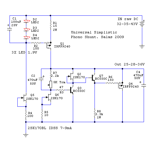

Universal Phono Versions Shunt
Given the wealth of reg manipulation ideas* and the 3 established final phono versions, I decided to do some subjective evaluations specifically with the simplistic phono as the load so to explore. Went back and forth, and felt that some minimal additions work to a good point when more can lead to alterations that work against the genuine signature of the Simplistic NJFET RIAA - Simplistic Shunt combo. We have seen some erratic noisy Zeners along the way in the thread, also some cartridge changes necessitating version jumps. So I though its better to combine flexibility and some knowledge from my subjective tests, into one Universal Simplistic Shunt schematic, able to cater for all 3 versions without Vref substitutions, just variable with a trimmer. Additional benefit is the precise B+ voltage matching ability between channels for those who make individual shunts for channels, and a little play test of B+ +/-1V for those not equipped for measuring THD so to decide their subjectively favorite operating point. I would prefer the multiturn trimmer to be substituted for a steady resistor after setting and testing long enough, securing long term reliability and assurance against the possibility of the miniature wiper becoming noisy. That's the heart of the VarVref after all.
So with this one you fit all versions and its enhanced too. Enjoy.:spin:

Nice Idea, Salas, but I cannot understand why you added Q7 and the associated R8 to the shunt v.1.
Moreover, C2 could be a good, but std elcap or must be a "premium" one as C4?
Q7 proved good for opening it up and focusing it a little more, but only when resistive loaded (R8). When I tried an active load, tone tightened up strongly in the wrong way. Its function is to drive better the shunt Mosfet's capacitive gate, and extends the flat low output impedance beyond the audio band. That subjective finding follows the simulation indications. Its not a spectacular subjective change per se, and maybe not translating in higher signal level like in line preamps with superior PSRR, but noticeable IMHO. This phono needs the least interaction between stages due to the fragile signal level and low PSRR. Low and flat reg impedance goes towards that goal. All in all this Universal has secure Vref against self noise, sports variability, better shunt gate drive, and it passed hands on test. If you don't use Q7 and R8 it will work perfectly by connecting directly from Q3 collector to R6. You can judge yourself by adding those 2 components and evaluating. Hey, its fun also. And yes, C2 must be good as Rcruz has elaborated not long ago.

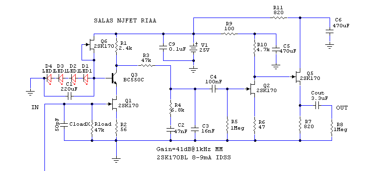

Hi, I'd like to build the attached circuit for MM and high output MC (like DL160) and have a few questions:
How much mA will one channel draw?
Q1, Q2 and Q5 have to be matched L/R, but not Q3 and Q6, right? So essentially three pairs of the 2SK170BL plus two unmatched 2SK170BL/BC550C are needed..or not?
The circuit is non-inverting, right?
Why not 47n6 and 15n9 in the RIAA network but 47n and 16n?
With a "preamp" (B1) with 25k input impedance can I use a 2u7 coupling-cap or should I use 3u3 anyway?
Thanks a lot, Dave

in a single channel, none of the transistors need to be matched. All of them should be within the designer's specification.
In a stereo pair, you are right that corresponding devices should be close in specification, but I doubt that matching is required.
The performance should be independent of small changes in parameters of the active devices.
I would select devices that are close in spec for all the active devices.
diyAudio Chief Moderator
Joined 2002
Rodeodave:
In a stereo pair you need to match the gain well and the THD roughly. Simply idss matched per position per channel, but all falling in the 8-9mA bracket is what is needed. Also, don't change the riaa values. It will subjectively detune from intended, more than you may think. For HiMC you better build the 48dB gain version. With a B1, your amp should be 0.5V sensitive to be driven full power with a Denon110/160-HiMcSimpl.-B1. Stick with 3u3 cap. Non inverting is the cct, yes.
