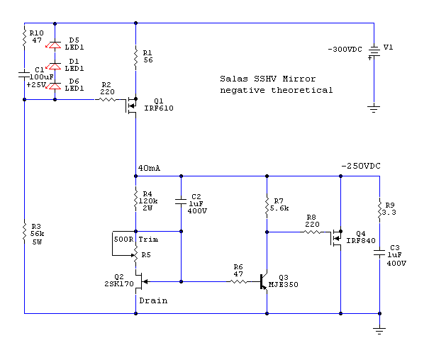

Negative supply voltage possible with SSHV2?
Back on post 1001 - http://www.diyaudio.com/forums/power-supplies/134801-simplistic-mosfet-hv-shunt-regs-23.html#post2229950 Piedsd asked if the v1 version could produce a dual-rail version of this design of +ve300V and -ve300V for an exstata headphone amp.
Salas, you produced the cct diagram below for a negative supply voltage (bottom):
Will the SSHSV2 design in the latest group buy be able to produce a negative supply voltage as above with some parts changes?
