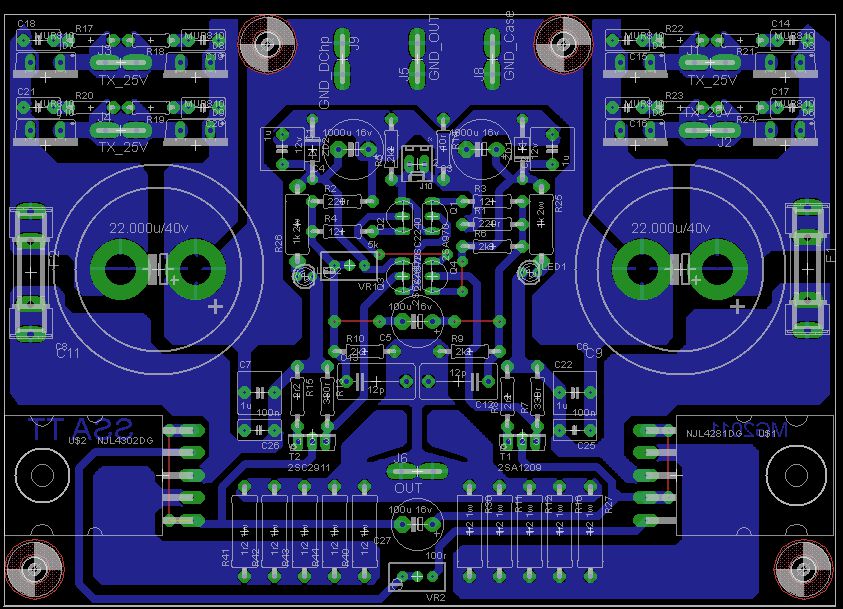

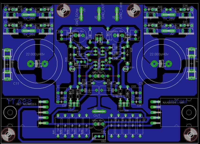

Hi Marc
Very nice PCB layout, the placement of the C7, C22, C25, C26 is now correct, also the green LEDs are good to be on a PCB for their indicating function.
C1, C2, C3, C4, C9, C11 with their layout presence are forming some kind of EMI shield to the input from the stress field of a rectifier diodes.
You should do also GND connection split as to my suggestion on the pic, in this way C9, C11 function is max efficient (100 Hz ripple rejection).
You're now good to go. ;)
Regards, Andrej :cheers:
You
LC the forum has gone out during my answer.....
I will do the modification you indicate. If work late me enough time i go for board production this month. Little more question : in the first TT schematic (that my board based on) the zener are rated 12V and in further they are rate 15V...Why?

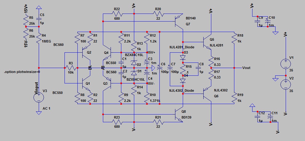

- Same for feedback resistor : 1k5 instead 2k2 in first schematic.
- Should i allow more room around driver to let the possibility of mounting To220 (2sc5171/2sa1930) part for driver or To126 device will more than sufficiant for this job?

I finally found the time to look over your sch and here are the comments:
- T1 should be BC560C
- input offset trimmer's +/- 15 V is provided by the existing two zeners, if the tracks on PCB will be longer than 2cm than you should also decouple +/- 15 V DC rails with 1 uF caps close at trimmers side
- I suggest you to supply front-end with +/-45 V regulated PSU to make max efficiency from the output stage swing according to supply rails
- in this case change R10, R11 to 1,5 kohm/2 W
- driver's gate DC voltage is app. 8V, so I suggest to change R19 to 2,2 kohm and P4 to 1 kohm
- VAS loading impedance is very high, there is practically no fT limitation by the load and most probable point of local oscillation, amp is also without any freq compensation, so I suggest you to put in small local feedback compensating capacitor (10-22 pF, will be practically tested) between collector and base of T9, T10 -
I think it is good to try this kind of output stage with drivers and outputs as mosfets. Pin layout of IRF's is adequate to standard TO-220 BJT so if there will be need to change the mosfet drivers to BJTs it will be like "piece of cake" (only some minor adjustments to Vbe multiplier).
Regards, Andrej
I think now you're good to go. ;)

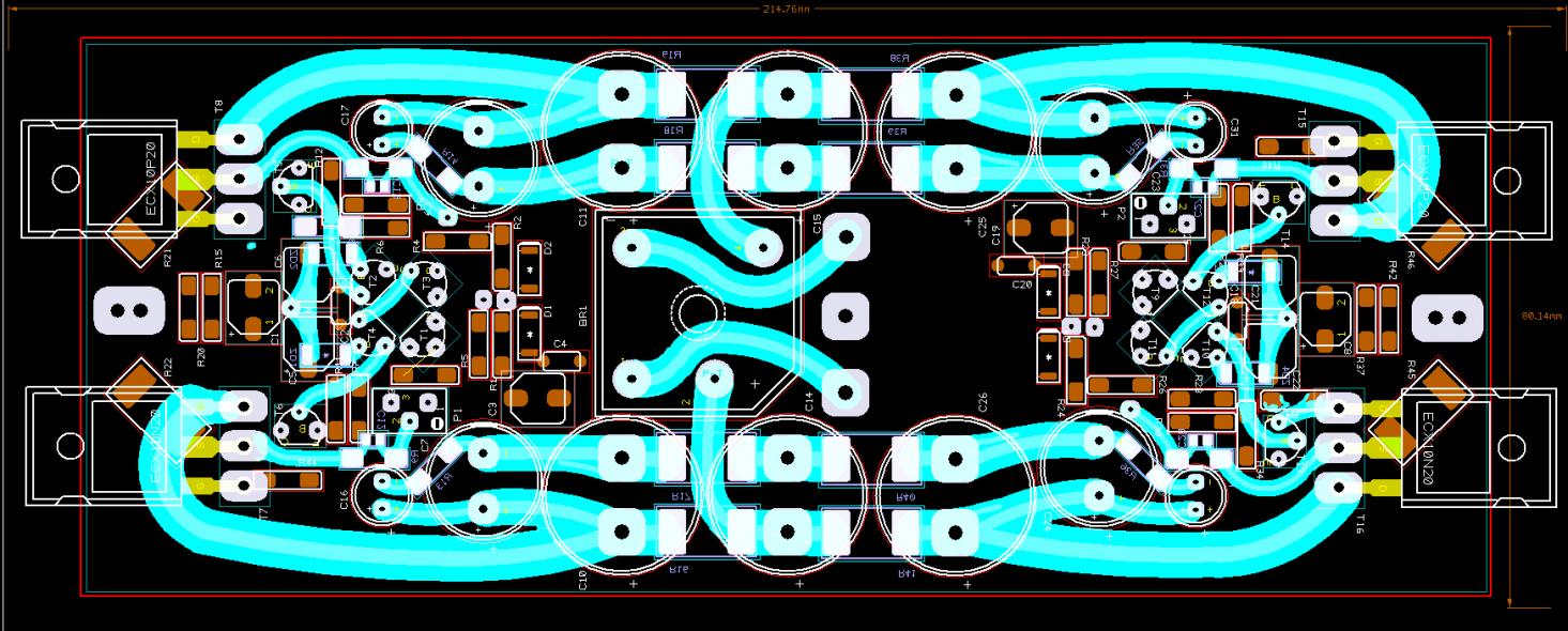

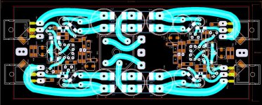

This one is in the middle of drawing phase and is a bottom layer only the top isn't displayed . . . yet . .
Need some more clear-sight nights :snail: to finish to the beta phase.
Really nice thank You guys for Yours sharp eyes and such great carry out with such a great precision, . . yes, sometimes long unsleepy nights easily introduce some unwanted errors... but for now all is under control . . . :)

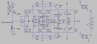

Tried some new value
Andrej,
because some value are hard to get here, so I prefer to re-use spare resistors I have now if possible.
I have change resistor value in the attached schematic and seems better is frequency response in LTspice simulation. (gain linearity, group delay, phase shift)
So can you help me check the schematic and values ? hope they are good, so that I can built them. Thanks in advance

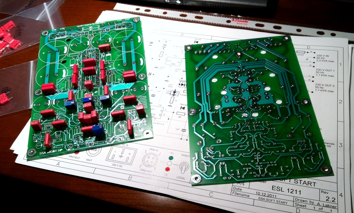

Yes it started, still awaiting for some parts ... The darn thing was tested and measured in so many ways-times on protoboards that there shouldn't be big problems. The layout and connections was also re-checked countless times, sooooo will see :xfingers:
The PCB material is 2 mm thick FR-4, copper connections thickness is exactly 0,115 mm (measured), dual layer layout with metalized holes - standard quality. Maybe only the colour will be changed into deep blue later on :earth:
