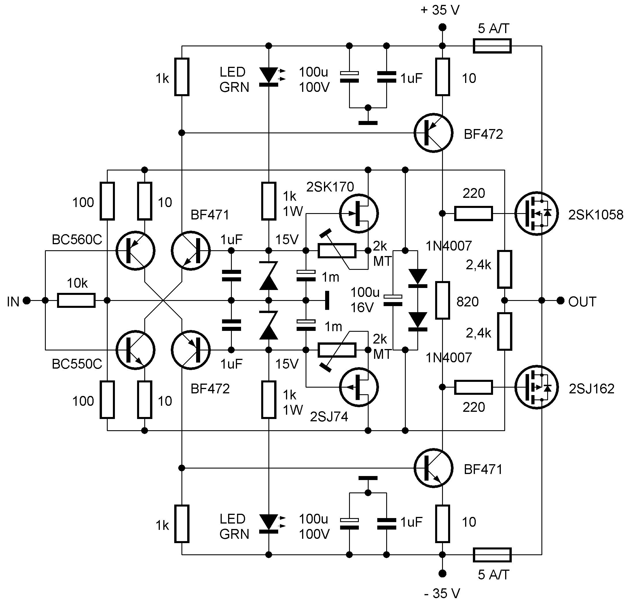

There are ~0.6V pinch off Jfets to use.;) My latfets ain't matching also, just picked out off the tube.
What I see in simulations tells me it's not just a bit of voltage drop, it changes the behaviour of the VAS. That's not to say it's bad or wrong, but for me with my limited way of thinking, it's no longer a symmetrical VAS.
diyAudio Chief Moderator
Joined 2002
Much better than a running away CFP. Irrelevant for your VAS and BJT output stage. Its another amp with same input stage topology. Did you simulate a Sziklai CFP BJT-LAT, or just dropped a JFET in your CCT and simmed? Mismatch the LATs as they really come and it blends nicely enough. If avoidable, then cool. If its a jumpy output CCT on bench, an appreciated band aid.
If the SSA was driving mosfet like my CFB with EXICON it would also be assymetric by a few volt. because of difference in the N and P channel.
So the few volt accross the JFET does not matter if the total voltage swing is +/-35V...
It will only be noticed by clipping....
By mine BIGBT outputs you actually drive the mosfets and it is interesting how nicely IRF610/9610 Vgs matches not only at threshold level but also across entire Id range, so in my case, SSA is still perfectly symmetrical amp all over. ;)
I use these BIGBT compound outputs (IRF+2SA/2SC) for more than a decade till these days and they never let me down, never noticed even a hint of a local oscillation or any kind of problems and still they can be easily expanded to provide enourmous output currents. The only thing one has to provide is NPN/PNP matching within +/-5% hFE. I guess the answer of its stability lies in BIGBT's symmetrical topology where all artefacts tends to be self canceled within positive-negative side in a balanced way, so it is natural that for a SSA topology BIGBT's are the first option of choice. :cloud9:
Its a very worthy bridge front end from the moment you get to know its traits. Such stuff usually lives on miniscule silicone area, trimmed and thermally homogenous current feedback op amp world. Was a refreshing idea you brought it back to DIY discrete world power amps Andrej. Hats off for that.:trapper:
Thanks again Salas, bipolar transistors also deserves to be a leading actor in this topology, they need a little more care and understanding than fets, but they also give back a lot. As I already once said, LTP input is not on my menu anymore. :)

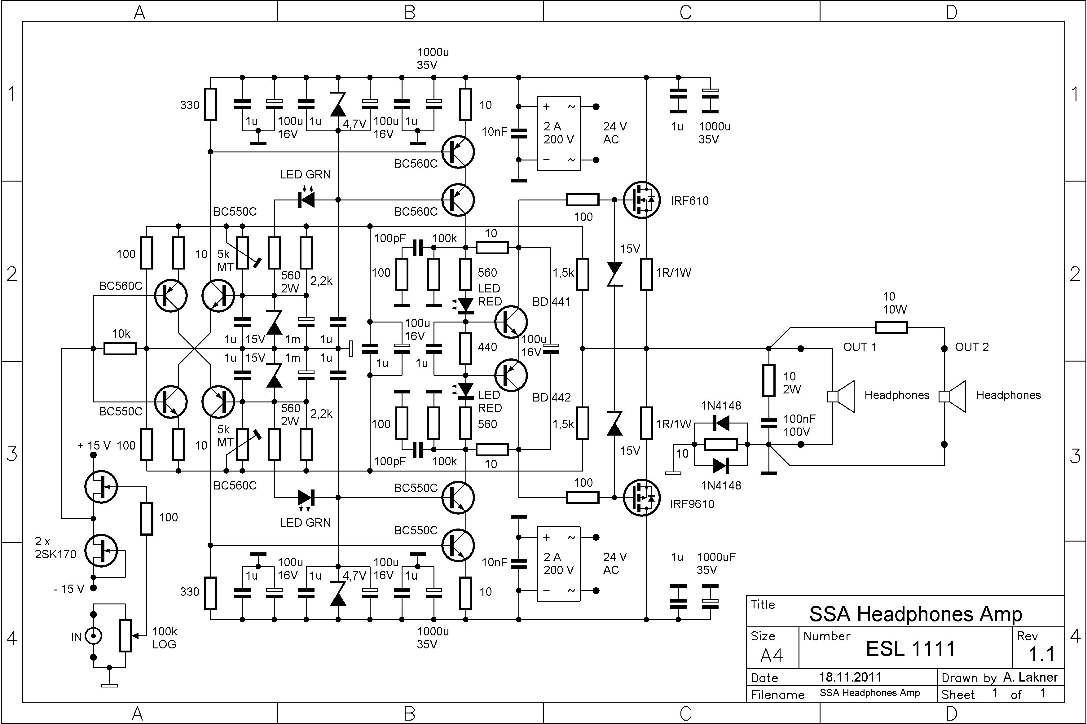

SSA Headphones Amplifier
Hi everyone,
Is there a variation of this amp that can be used to drive headphones?
Ryan
Hi Dr.H
Here's your mission target. :hphones:

LazyCat, you're a very kind contributor! I had in mind to build the big beast for my Apogee Scintilla speakers, but will start with the headphone amp, to learn, to listen, to gain understanding.
Thanks again!
Ryan
Dr. H, :cheers: -> You're on the same way as me, :nod: already :snail: collecting parts for the Balanced V12 engine for my Scintillas, and as a pudding I'll add to the collection this little marvel Headphone Amp.

SSA Basic MOS-FET version with J-FET current sources to provide supply current into SSA feedback bridge, serves to compensate collector current thermal drift of the input pair and consequently the bias of the whole amplifier. ;)
This version was inspired by Salas, based on Nico's mos-fet SSA amplifier from early of this thread. :)
