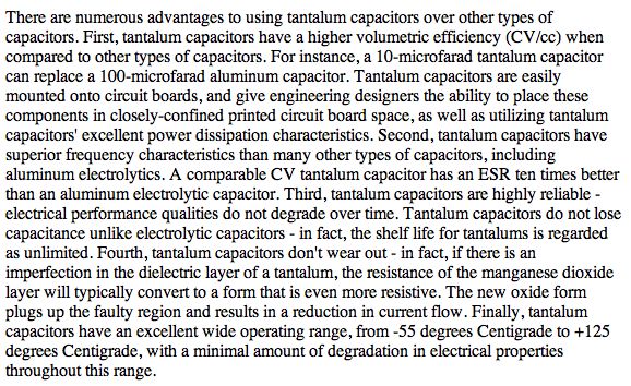

Tantamum caps aren't all bad - see attached for some notes I found on the internet >Tantalum Capacitors About - Engineers Edge
Tantamum caps aren't all bad - see attached for some notes I found on the internet.
Sure they are good for practical purposes, but for critical sound system, they are bad :D

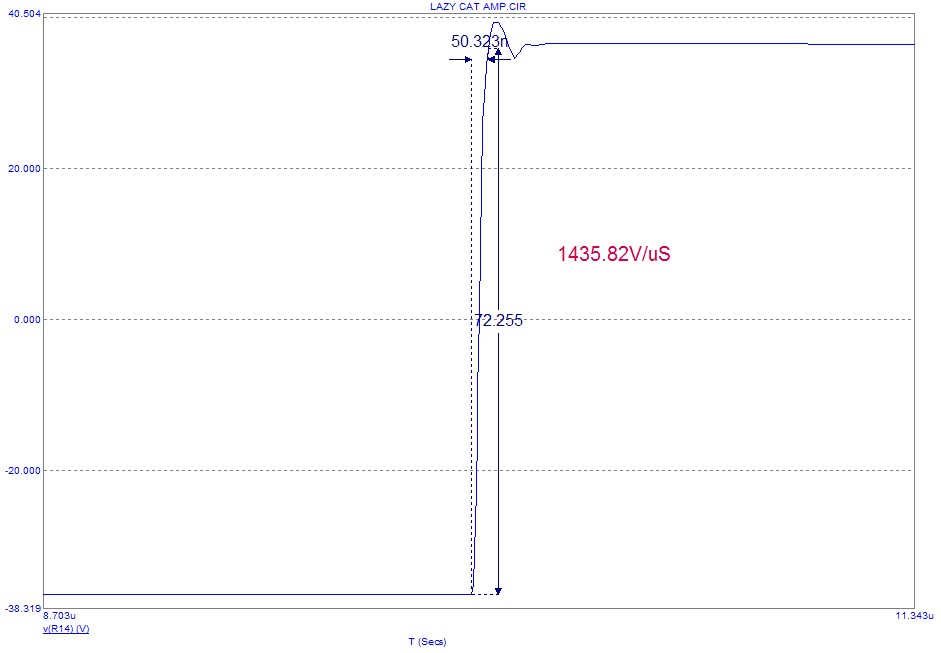

What is your definition of speed? You can tweak each component value in the amp to theoretically have slew rates of over 1000V/us, is this what you mean by speed? Problem is you start running into serious stability problems and your PCB layout has to follow the rules of a linear RF layout. It could take weeks or even months of experimenting and placing arbitrary caps between tracks to achieve this, where the black art of RF lurks - would it make much difference in the sound character between this and what we already have?
