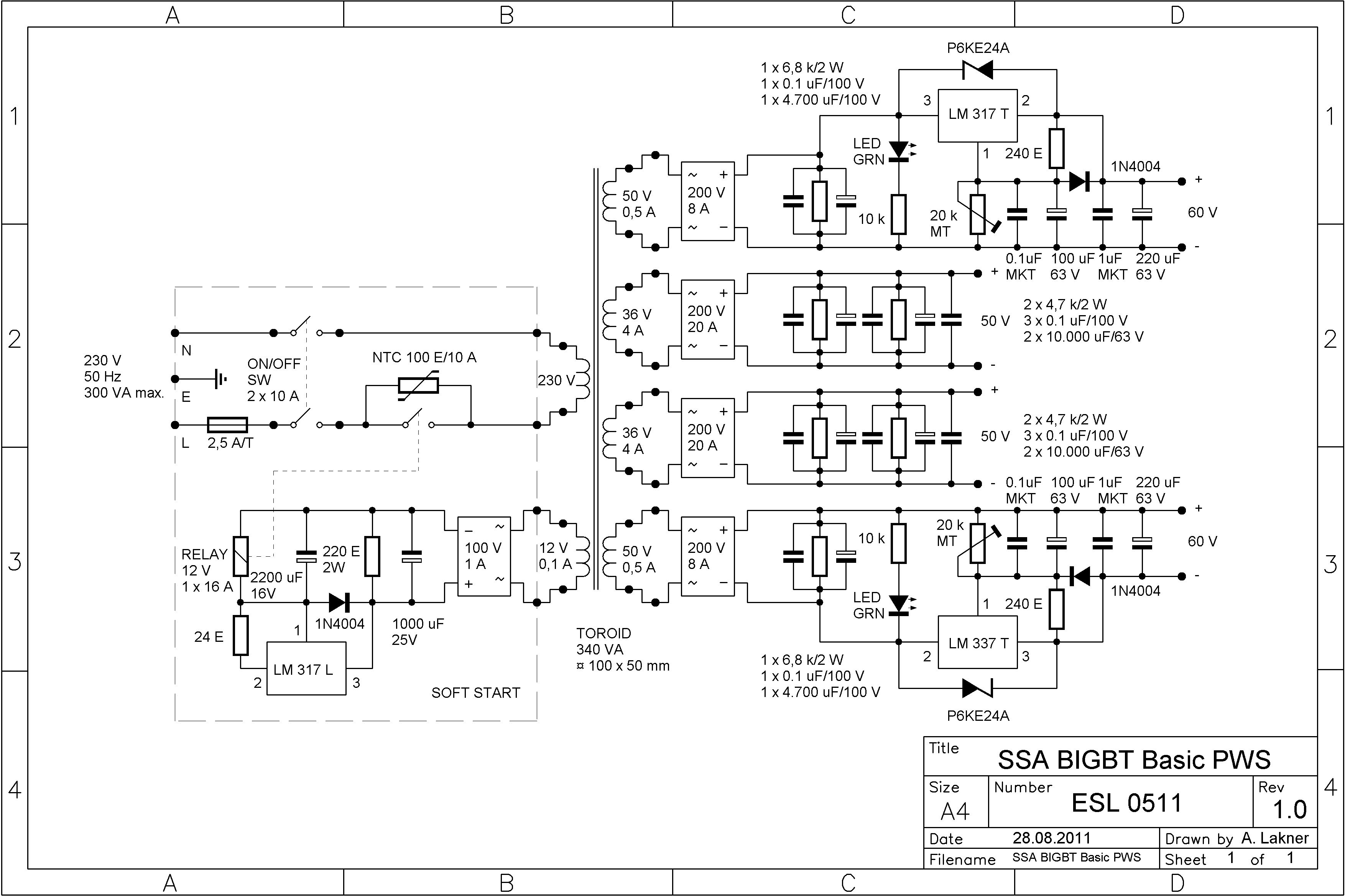

At the moment I see no reason to do any of that measures. Look Shaan, first try it and always recheck in reality what simulator's claiming. Attached schematic is my proposal for splitted power supply if you want to do it. ;)

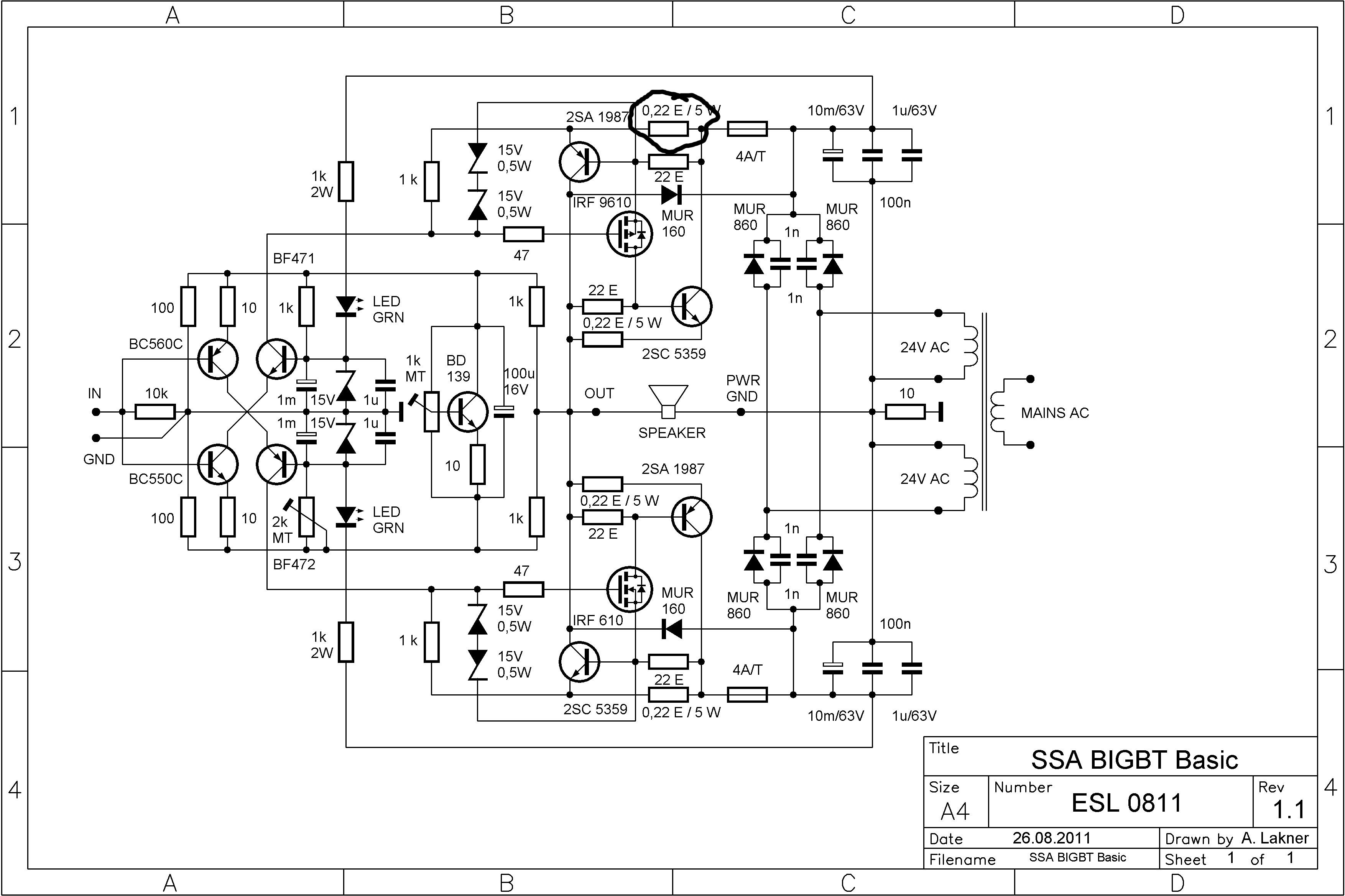

Ok I have problem with biasing it does not mater how many times i turn trimmer nothing happens, can be the problem with IRF parts, the truth is I newer get to the end just to lets say 150R On Base collector resistance ?
Help I need somebody help. trimmer is now full turned proximately 260R between Base Collector of VBE transistor green led glowing DC OFFSET 25 mV without trimming, but I can not bias output transistors (MJL 3281A/1302A no changes turning pot 0mV redaing

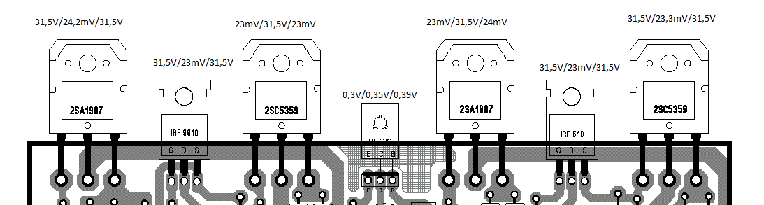

Please measure as many voltage potentials you can and put their values in sch. Than I can help you out. ;)
Vbe multiplier base to emmiter voltage is 90mV, so it is not in function, like it wouldn't be there. :rolleyes:
In this case you should have full Vgs voltage (maximum bias current!) on mosfets (across 1k gate resistor) but the reading is zero. So you probably don't have +/-15V on zeners or input/cascode transistors are mixed-up. Input cascode's collector current should be present so voltage reading across 1k gate resistor should be there. If the voltage on gate 1k resistors is zero that means you have some mistake in input stage cause input collector current is not present. Please recheck NPN/PNP positions, voltage across zeners, input pair colletor current (voltage across 10 ohm emmiter resistors should be app. 45mV, voltage across 1k gate resistor should be 4,5V), etc.
The correct start-up phase should be zero ohm between base to collector of the Vbe transistor and than slowly increasing resistance by turning trimmer to get app. Vce=1,2V (22mV across 0,22ohm output emmiter resistors). ;)
In this case you should have full Vgs voltage (maximum bias current!) on mosfets (across 1k gate resistor) but the reading is zero. So you probably don't have +/-15V on zeners or input/cascode transistors are mixed-up. Input cascode's collector current should be present so voltage reading across 1k gate resistor should be there. If the voltage on gate 1k resistors is zero that means you have some mistake in input stage cause input collector current is not present. Please recheck NPN/PNP positions, voltage across zeners, input pair colletor current (voltage across 10 ohm emmiter resistors should be app. 45mV, voltage across 1k gate resistor should be 4,2V), etc.
as far as a can see input transistors are ok bc550c/560c Q3 is BF471 Q4 BF472 voltages on zener diode will measure later
