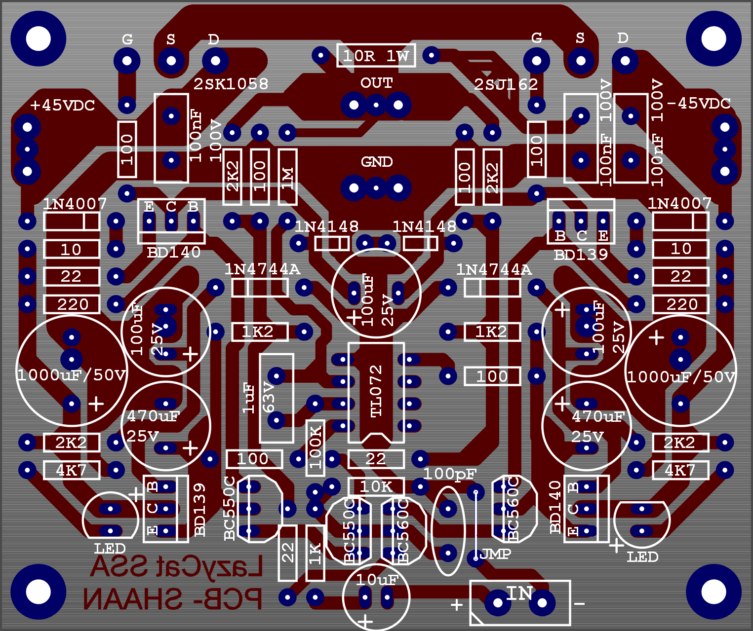

Hi naf.
The only problem I think is when one doesn't know the pin alignments of the TO126 package, which happened in your case too. That is why I pointed the "E C B" to each of them. Knowing the pins of the BJTs is a basic requirement and I think if one places the transistors following the E C B as situated in the silkscreen then all will be well.
The rectangular symbol is for TO220 not TO126 coz my stupid PCB software don't have it. The picture is just to show what the final think will look like. I will remove the rectangles in the final version(which I am going to build myself too). :)

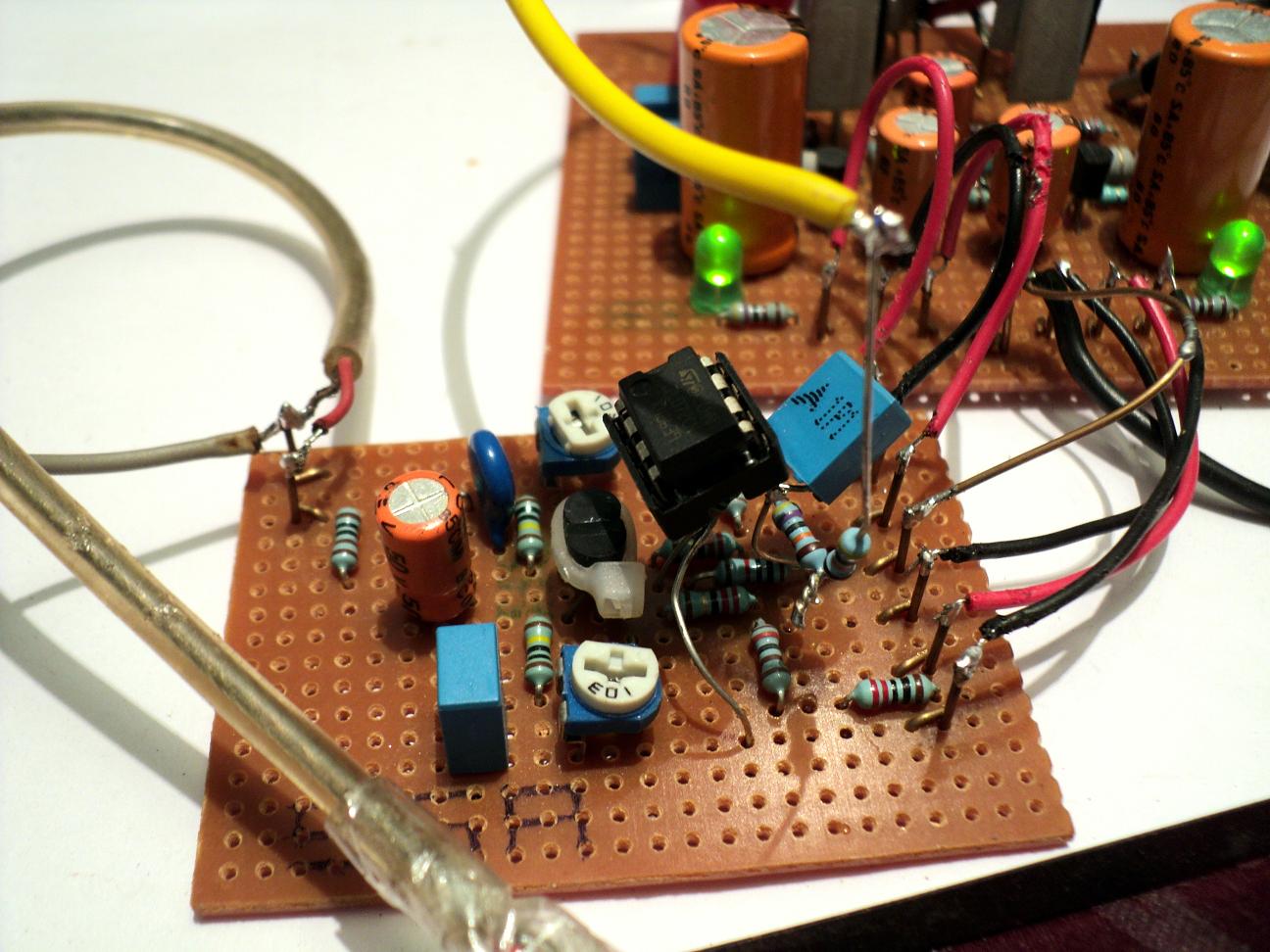

Test done. Offset +/-2mV. Opamp fed directly from Zeners(I know this is not good, that's why there will be cap-multipliers in the servo peeceebee :p).
Cheers!
shaan
p.s.- my veroboard SSA has become super ugly. Sorry for the bad looks!:p
edit:- 1. no sonic/bias change, 2. the pots are disconnected from the inputs.

Hi Christophe.
Yes I can do it.
Would you please explain the advantage? I don't know what bad would happen if the unused channel is left floating?
With no feedback, the OP Amp has terrific full gain (noise) and can oscillate With negative effects, both by capacitive coupling with the other one and its power supply rails. Just plug your oscillo to the unused output pin as it is...
.Did-you imagine to let your power amp with no feedback ? It is the same.

Thanks a TON for the explanation!
Unused inputs shorted to ground.
