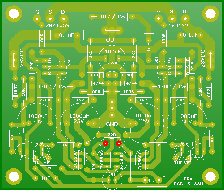

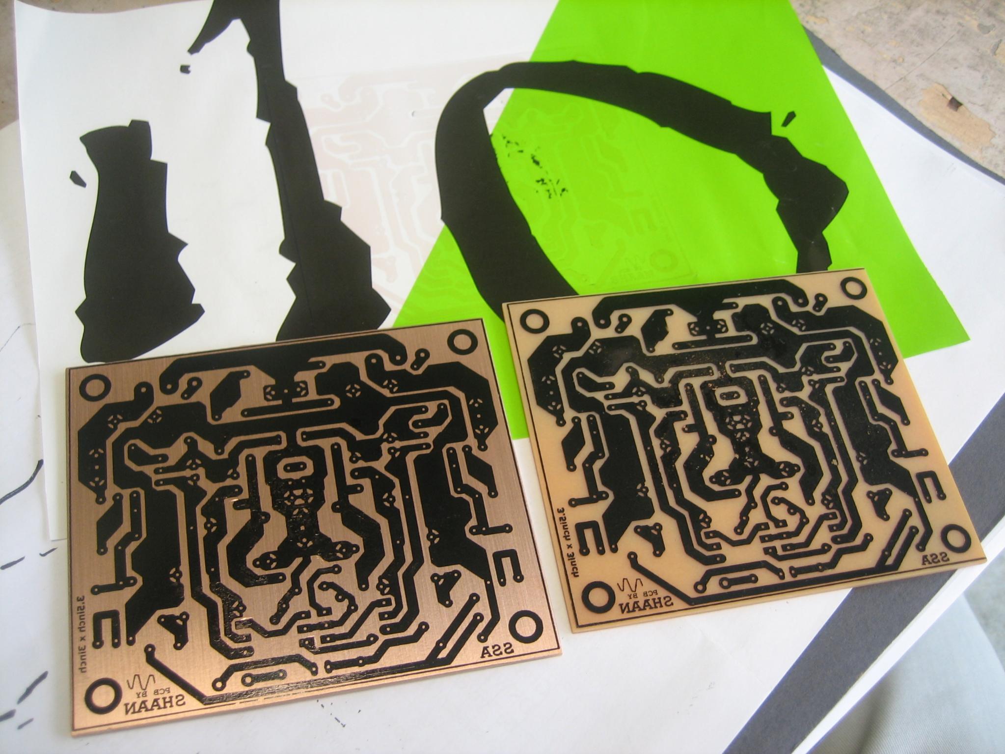

dear Shaan, if you want to just print and iron, i think this is the correct one.
left is your new corrected 10k resistor, right is my first board

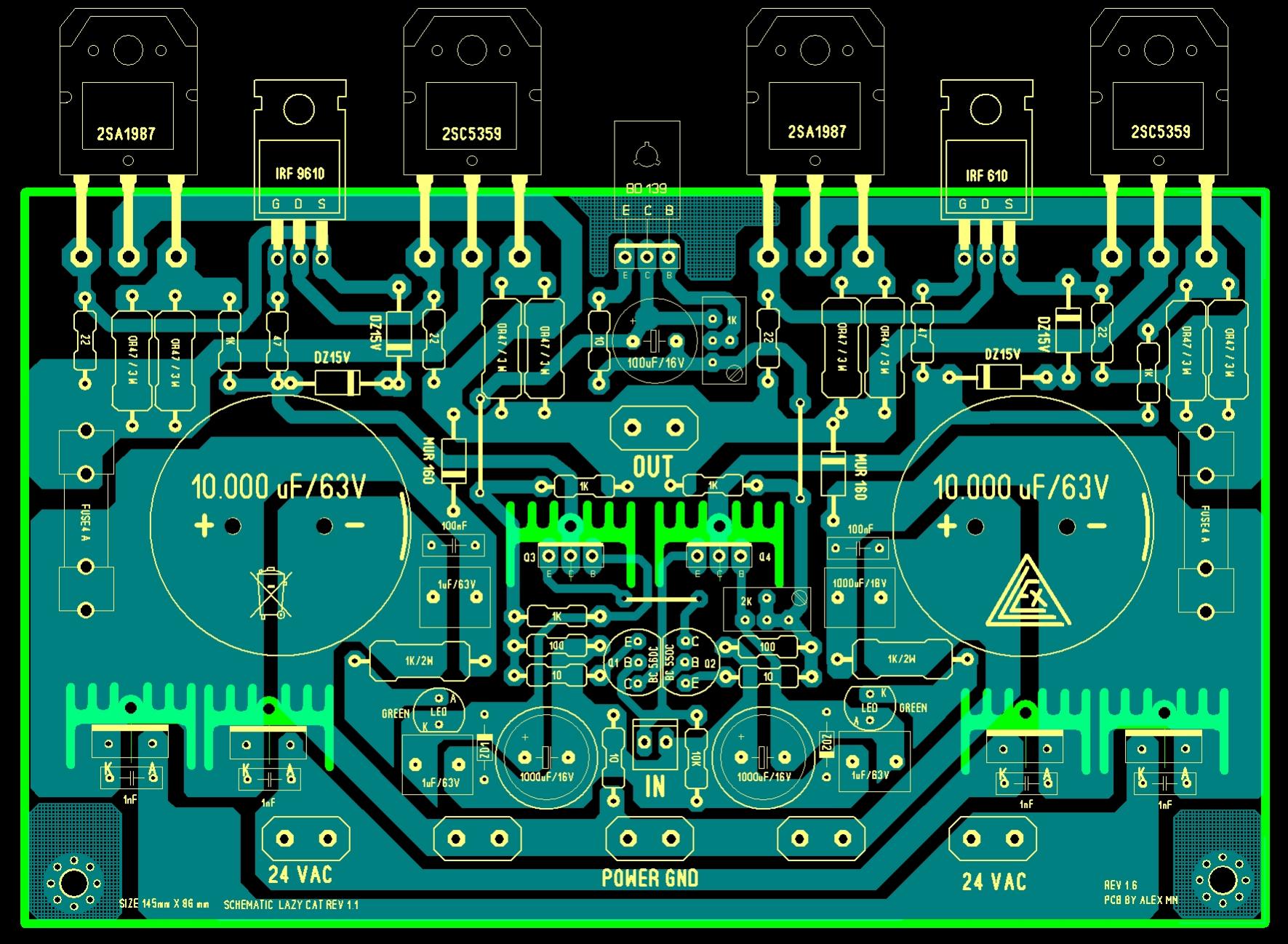

Finally, I am proud to announce that the SSA Low Impedance HP design project is prepared. It was a DIY community mutual project since there are ideas, knowledge, effort and of course time & energy of many involved, to offer free SSA amplifier project to all interested. ;)
Happy DIY, enjoy, regards Andrej :cheers:
P.S. Special thanks to Alex, you're the Man. :worship:

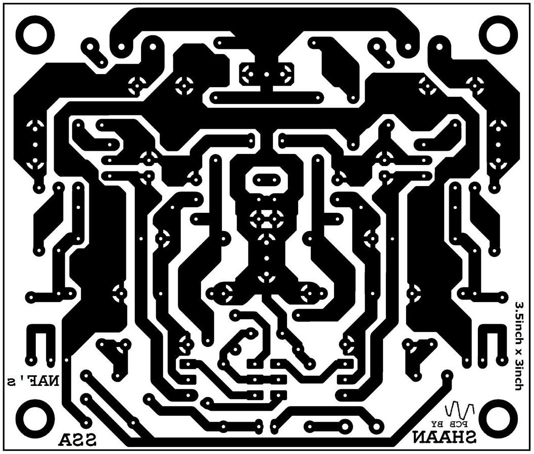

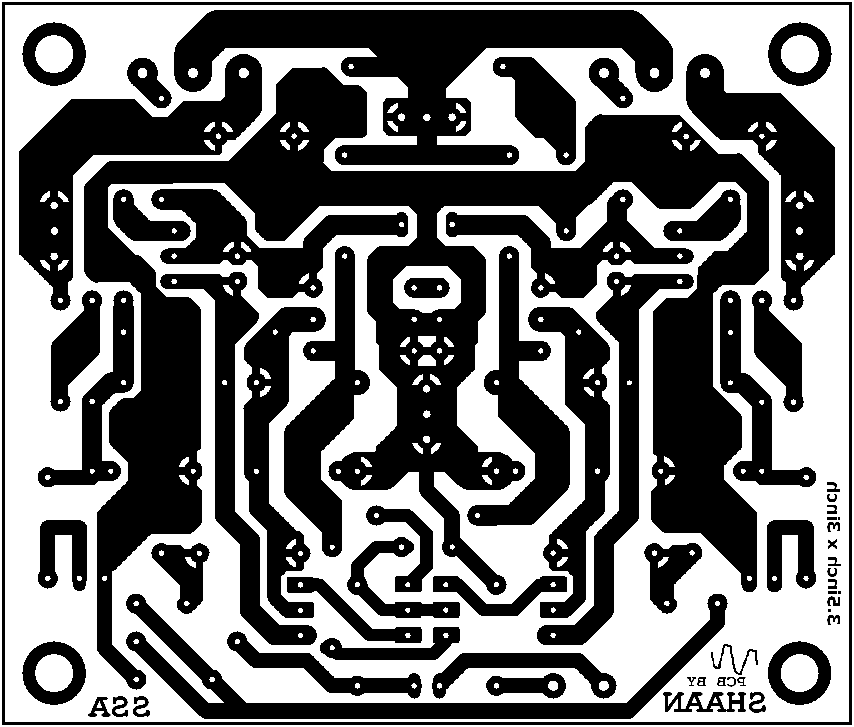

It seems, the text on Shaan's first PCB lay-out confuses others.
The corrected PCB with the readable text (left image) and Naf's posted corrected PCB with the reversed text (right image) are both correct for toner transfer. No need to mirror. See the components lay-out (center image), the imaginary copper tracks and both the b&w bottom copper tracks matches. Personally I don't mind the text but I look into a particular spot in the pcb artwork, and in Shaan's design the input. The input in the component lay-out goes to the right side and in both the b&w bottom copper (for toner transfer) the input was also on the right side, then that is good to go for toner transfer. Of course after the image has transferred to the pcb it will become reversed but then you will be flipping the board so that the parts sits on top of the board and not on the bottom copper exactly just like on the given component lay-out..:D
you've got it!, i'm always print it in paper and see throgh the light before toner transferring...and that's why i manually flip SHAAN and SSA text.
..pretty close Shaan..:)

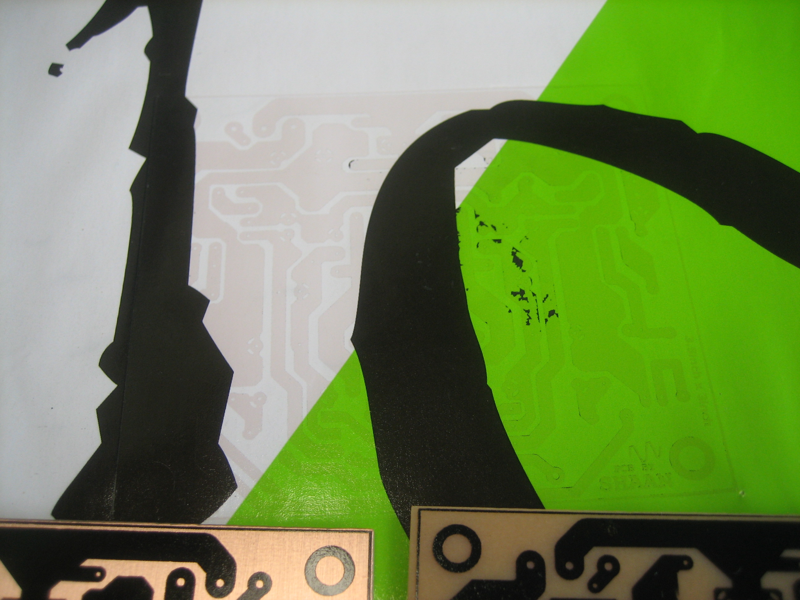

It's actually an A4 copy paper wrap.
boyet,
I was told the A4 size stickers being sold at National Bookstore is ideal for use on toner transfer method (you won't be needing the sticker of course just take the "backing paper"), better yet check on the "Staples" brand. I dunno' if you can find the "wrapper" that I've used, it was actually for office use, but I guess any glossy type paper that can tolerate heat without peeling off, should be good enough for the job.:)
In laserjet toner transfer method, "practice makes perfect":up:
Dear Lazy Cat ,
can you suggest what to change in schematics to adapt it to 40-45VDC regulated PSU or even 56VDC if not regulated (didnt decided yet)?
http://www.diyaudio.com/forums/atta...-symetrical-amplifier-ssa-bigbt-basic-pcb.jpg
And output transistors.I have MJL21194/15025 but theese are too slow i guess,only 4mhz. I have NJL3281 too which is 30mhz device but it's with diodes ,different pinout.But that's managable if needed.
