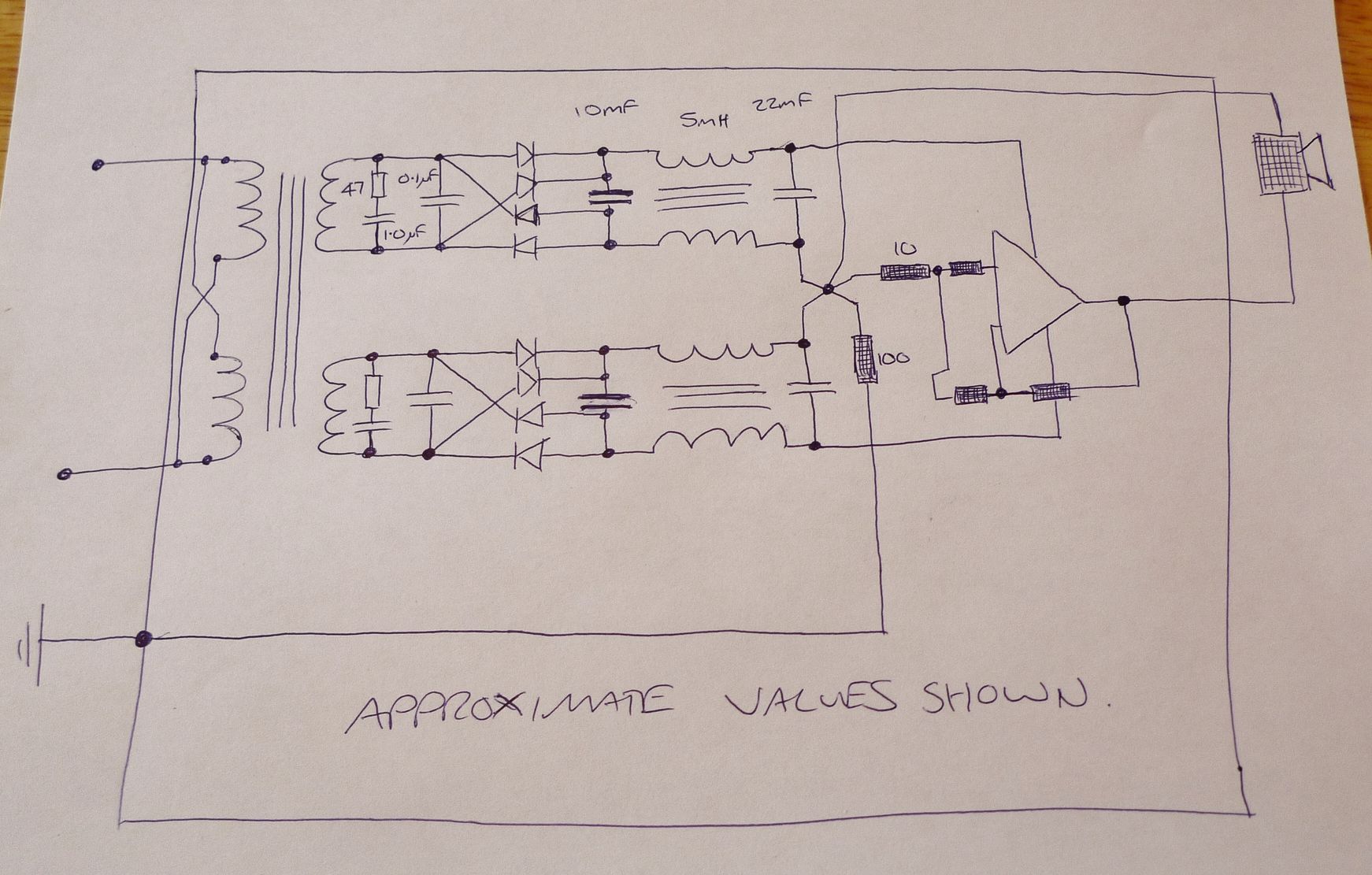

I usually have separated secondary & bridge & 1st cap for each rail and then follow each secondary with differential chokes in both legs before 2nd cap.
Only join the 2 secondaries together to make ground after the chokes. Do this throughout entire system so system ground is never connected directly to secondaries.
Also snub out the resonances in secondaries
What I have yet to do but will do next is some filter the supply ground before connecting to system ground.
I think the scheme you posted could be quite good if the secondary resonances are reduced in frequency & snubbed out but not sure if this is as comprehensive as full choke scheme.
I think full choke scheme is as close to the ideal isolated battery as is possible and probably quieter than some kinds of battery.
If the entire system can then be double insulated rather than grounded this would be ideal but if we have to add a mains ground I guess it should be as clean as is possible.
I just upgraded my regulation scheme to this.
The new feature is the 100R resistor between the full earth of the casing and the star ground of the amp - got this from a TI application note that Sonny gave out in his TSSA implementation.
Big thanks 4 that Sonny !
It never occurred to me to include that resistor but upon examination it comprehensively completes the filtration system of this design.
So far I just applied it to one amp but when I implement this throughout my whole system I'm hoping for a significant improvement as it will substantially decouple the mains earth from my system ground.
Might be a small choke here would be even better but in the meantime I think 100R & 22,000uF ( plus bypass ) will provide a fair amount of noise reduction !

Doesn't really affect damping, although the rails do dip during loud passages a little with the coils resistance - but the coils on my latest amp add up to less than 0.1R Total ( both windings added together in each choke = 0.1R )
I use chokes on all my amps and never had any problems with oscillation - don't really see what you mean - unless you refer to ringing at turn on in a poorly designed choke supply - that can happen but not if you design it correctly - easy to do in spice.

Chokes were used often in tube amps. And they present, like everything else in electronic pros and cons.
First remark, your 5mH coil have a Z of 3ohms at 100Hz (rectified 50hz) + the resistance of the wires. It makes 6.2ohm on each rail ! Far to be a dream to feed high power transients . All will depend on the value and impedance of the secondary caps. While mine will add the two capacitances reserves on demand at the price of a little voltage drop.
The advantage of coils are signal ripple they provide is more like a sinus, smooth, while it is more like a saw without.
Con is that, if you want to afford big amps, you need very huge and heavy coils. Plus shields against magnetic leakages.
About filtering diode's switching noise and hf, a coil or choke will perform less than a zener or any silicium active device . A lot less.
To resume, the reason why i prefer an active solution is just it is less noisy, filter any HF more deeply (up to Mhz), and provide a very constant voltage, for less money, and less weight.
Again, there is no difference between common ground at the middle of the coils or two bridges configuration with separated coils. And if you omit the AC coupling between your two coils, you can put just 10mH on the +and- side and nothing in the ground lines with exactly the same result.
Just a different order between serial parts, It is a matter of currents. Ground will be just at the outlet earth potential in both situations.
