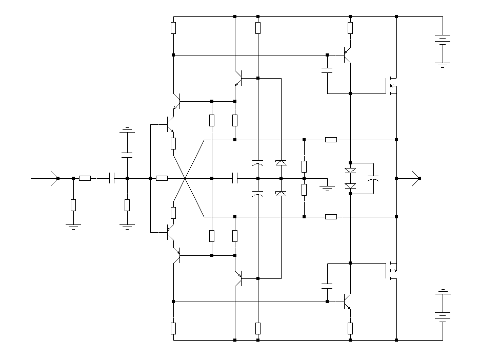

Simple Symetrical Amplifier
Today I put my ear over the speaker and...
There is HUM!:crackup:
Faint, but present... normally not detectable... but head too close and "mmmmmrmrmrmmmrmmrmrmrrmrm".
I increased the fb current-feed resistors from 1k2 to 1k5, and the hum almost vanished. But, Iq is now 70mA; and only 3mA through the VAS.
I suspected the PSRR. Off to my PC and simulated the following, a 15V capacitance multiplier. Seems okay in the sim. I was wondering whether others have experience with it, there. As it is known that the +-15V must be as clean as possible. Please. Or should I just double parallel-to-zener capacitance?
Thanks in advance.
P.S.- NO complaints about the music. It's as good as it was. With 1k2 current-feed resistor of course.

Few things to check for hum elimination
- one channel on, shorted input, check hum level, try different GND connections just to be shure that this is or not the problem
- after +/-15 V regulators (zener + BJT in your sch), connect 100 uF from each emmiter of regulating BJT (NPN/PNP) to GND, only elco parallel to zener at their bases is not enough
- if added 100 uF is lowering hum, you can further improve PSRR with use of TL431 for +/-15 V DC regulators
- further improvement is to use constant current generators from +/-15 V to mid feedback bridge points, this not only improves PSRR but immensely elevates the sound to the next level :yes:

Hi Andrej.
Already checked. Grounding seems okay.
- after +/-15 V regulators (zener + BJT in your sch), connect 100 uF from each emmiter of regulating BJT (NPN/PNP) to GND, only elco parallel to zener at their bases is not enough.
Yes, will do so.
I would pay double for those precision devices, but couldn't source these here. Trying to make the best out of what's available.
Yes I have that checked. This will be my next job. I have read through your CCS implementation posts. Very impressive indeed.
So, Shaan, a lot of experimenting ahead :up:
Yup, I'm on it.

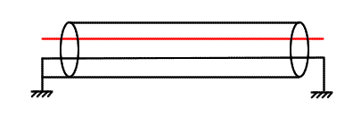

I use the following cabling method with symmetrical cable for all the modulation connectors (out is the left):
It prevent any current in the shield to leak in the the modulation wire, and prevent the hf to enter in the feedback loop of the source (IM distortion).
You will have to check all combination in the sens where all the power supply wires of the different equipments are connected the the AC outlets, to minimise the leakage, sensing the voltage between the chassis grounds (unconnected together).
The only ground cable to be connected to the ground outlet will be the Power amp one.
