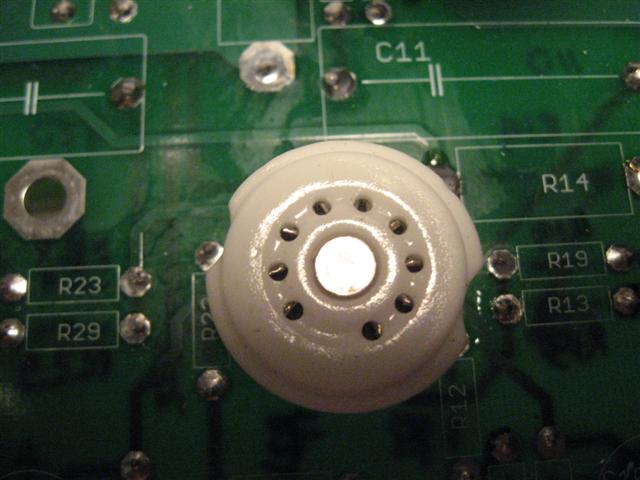

I don't think I got solder in the pins. If I look straight down into the socket, some holes look open while some look like there is some metal in there actually push against the pin. Unfortunately I do not have another old tube to work the socket in and out a few times. I actually have used quite a bit of force trying to get the tube in.
The tube seems to be lite, shouldn't I get some kind of sound out?
There could be some other pins not making contact. How far are you getting it in there? A picture would be helpful, specially of the base of the socket. The pins on these seem to be tinned, so solder will happily flow up into them if enough is applied. You have to use just enough where it starts to appear on the other side of the PCB but no more.

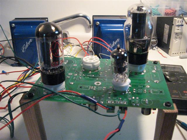

If you post a picture of the components side of the board we can look it over for ovbious issues. I studied the pictures that you posted previously and the only questions that come up are the colors of the wires going to the back of the board. I see yellow wires connected where the green ones should go. It they are extensions of the green transformer wires, then OK.
I have used the type of sockets that you have, and I did receive a bad one once. The tube wouldn't go into it at all, because some of the holes in the ceramic were too small. Replacing the tube socket is not easy either. I can explain the proceedure it it gets that far.
I can cut the legs off of that socket and remove the pins a lot easier...
If the main objective is to save the board and remove the socket, that's exactly what I do. Carefully cut through each pin with sharp cutters, remove the socket, then unsolder each pin one at a time, then clean out the holes with solder wick.

Here are a couple of pictures of the socket and component side of the board. The tube will not sit flush. Now I remember that when I first got my tubes, I did try to fit the tube on the socket. It did go in but I had to apply a lot of pressure.

Here is a pic.

Ok, I finally got my 12AT7 tube to sit flush on the socket. I bought an old 9-pin tube to try to work it in a few times but I was having the same problem of trying to get it in.
So, what I did is I stripped back some 20ga solid wire and worked it in each socket pin hole. I also tried 18ga but could not get it to fit in all the holes. I must have loosened them up a little because I did get the tube on with still a lot of pushing effort.
So, know all my tube are lite but still no sound. I measued the R29 voltage and it was 212V and I measured the R13 and it had 227V.
