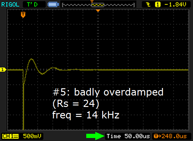

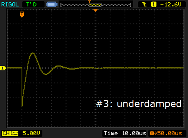

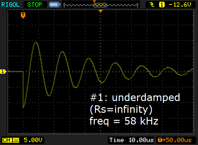

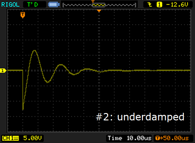

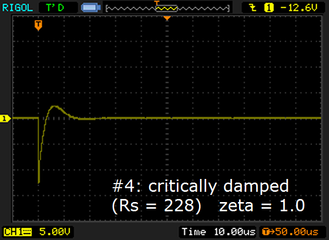

FdW, I like to smoothly dial the snubber from very-underdamped to critically-damped, watching the oscilloscope the whole time. I've attached 5 photos showing the time sequencing that I prefer. I took these measurements today on a little 5 volt-ampere transformer that happened to be laying on the bench.
Picture #1 has the snubber resistor Rs removed from the board ("infinity ohms") so the secondary is extremely underdamped. Then I installed Rs and sloooooowly dialed it lower, lower, lower. This gave pictures #2, #3, #4. Picture #4 is critical damping (zeta = 1.0); the waveform "trough" at time=2.5 divisions, has been completely flattened.
Then, for the sake of this informational post, but NOT RECOMMENDED in real life circuits, I continued to dial Rs even lower, giving OVERdamping. When I dialled Rs down to ridiculously small values, producing ridiculous OVERdamping, I got picture #5. You'll see that it exhibits oscillations, at a lower frequency (scope sweep 5X slower). This is because Rs is now so small that the impedance of Cs is no longer negligible compared to the impedance of Rs. With a CRC snubber, it is possible to have too much of a good thing (damping). Picture #5 shows what happens when you try to set zeta to approximately nine. Don't do that!
