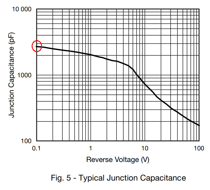

For diode capacitance, the lowest capacitance rectifier I've encountered is the lowly 1N4005, at 8 picofarads. The highest capacitance rectifier diode I've encountered, is the VF30100S, at 2700 picofarads (!!), pictured below. Remember that a bridge rectifier includes four diodes and remember that at the instant of ringing (when it matters), all four diodes operate at different bias conditions hence different capacitances. So you'll need to figure out the four bias points, grab the four capacitances from the curve, and add them up.
Use all of this information, to dream up your own "CharlieLaub No-Measurement Algorithm for Snubber Component Selection". It might be a single Universal Snubber, where the same component values are used for all power supplies. No matter what transformer the designer picks, no matter which rectifiers the designer picks, the recommended snubber components are always the same: Rs=VALUE1, Cs=VALUE2, Cx=VALUE3 (V3 might be zero! It was for Morgan Jones.). Then run that through the loopety loop calculation again, with all possible transformers and all possible rectifiers, and calculate what the damping factors turn out to be. Maybe they're great.

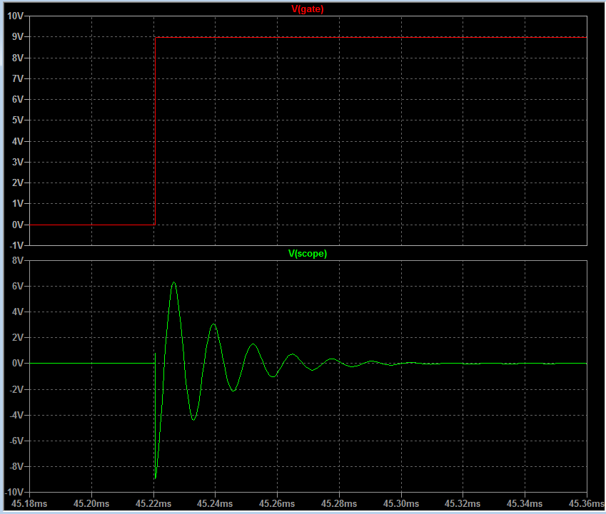

In my experience with real Quasimodos and real transformers, very often there is quite a good match between real life and LTSPICE simulation. So, it may potentially be a time-saver (or a handy "verification using orthogonal inputs") to fool around with different values of secondary leakage inductance, rectifier capacitance, etc., in simulation.

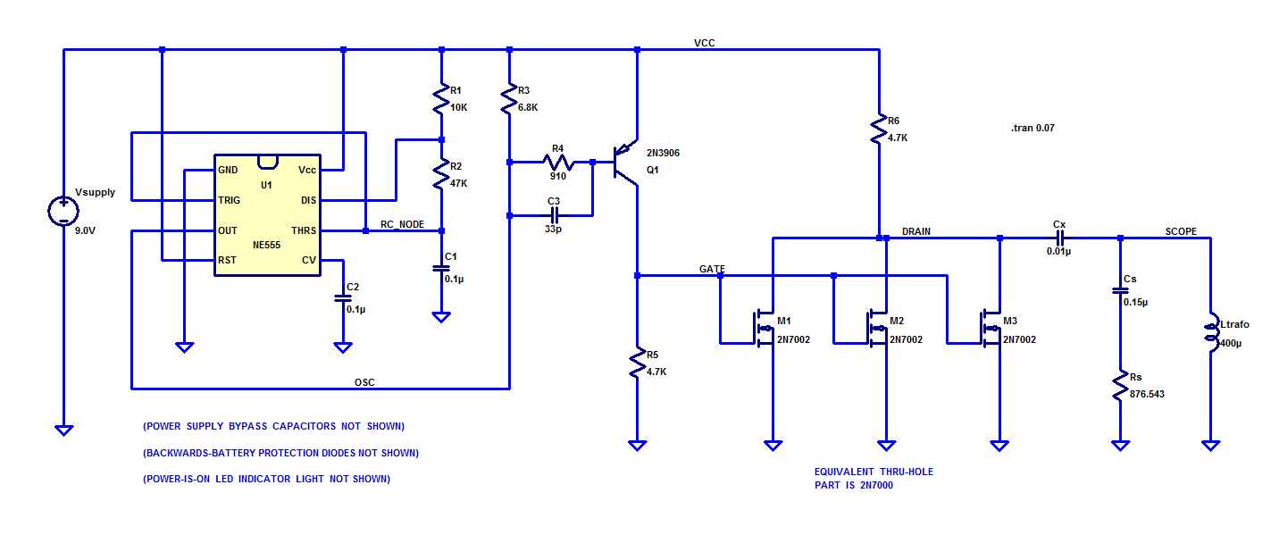

Shown below is the minimalistic "Cheapomodo V3" circuit. I honestly believe you would get equally good answers by eliminating everything to the left of M1 except Vsupply, and just driving node "GATE" with a square wave voltage source having < 20nsec rise time. Simulation results are attached; pretty close match to the real thing in the real world.
For what it's worth.

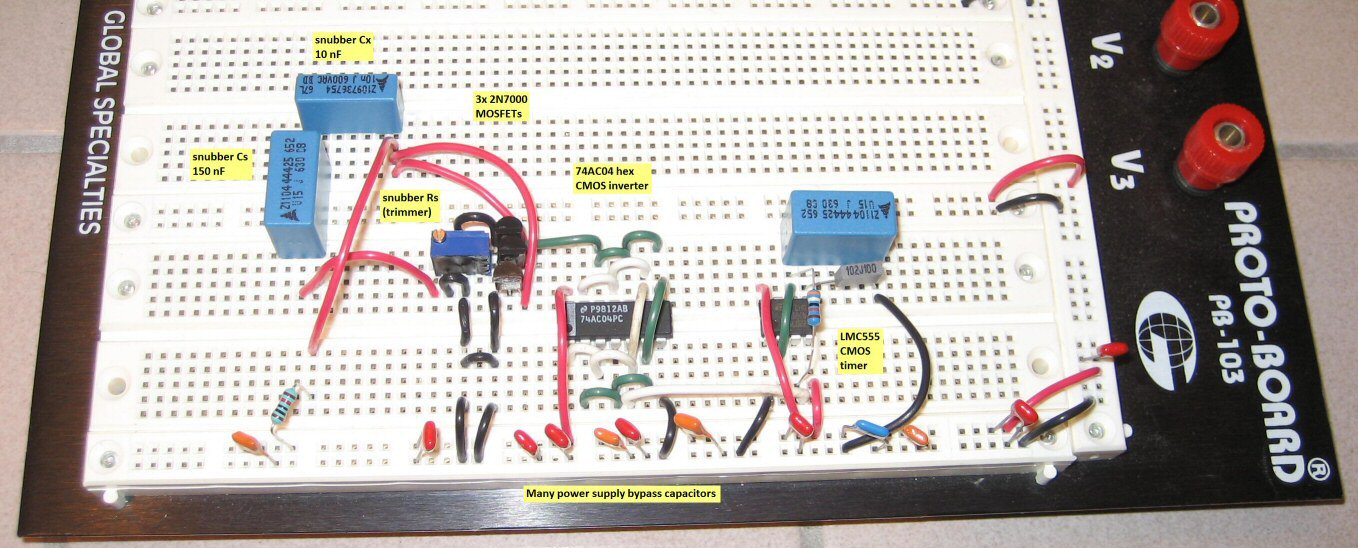

I've attached a photo of the grandfather of Quasimodo, which I slapped together on a protoboard in an hour. The optimum snubber is an hour away.
