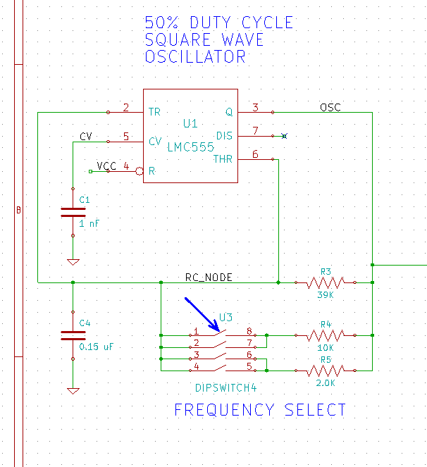

Change the DIPswitch setting on V4; this changes Quasimodo's square wave oscillator frequency. You can measure the oscillator's new frequency by counting grids on your oscilloscope face (some scopes have frequency measurement already built-in). Find out whether changing the square wave oscillator frequency, changes the optimum value of snubbing resistance. Maybe the optimum snubber remains optimum and unchanged, no matter what oscillator frequency is used. (as long as it stays well below omega_n in equation A.10 of the Quasimodo design note).

I have highlighted DIP switch 1_to_8 in the schematic fragment below.
The LMC-555's oscillation frequency in this circuit is: fosc = 1/(1.4*R*C) , where "C" is capacitor C4 and "R" is the resistance that charges and discharges C4. If we arrange the switches such that R=7.96Kohms and C=0.15uF, then fosc = 598 Hz.

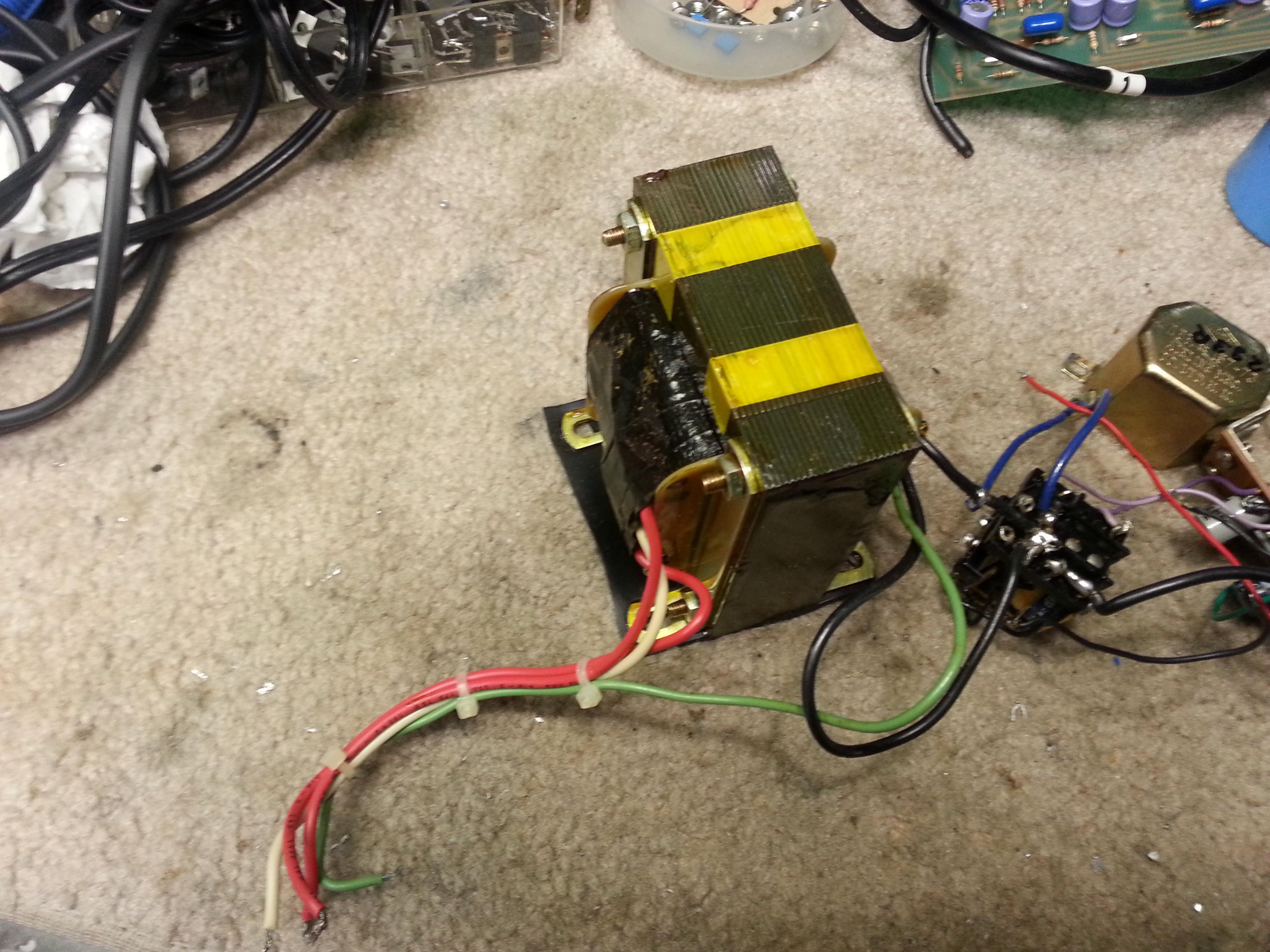

I found an interesting thing when using Quasimodo on this center-tapped PS Audio power transformer. The correct resistance value for one of the windings turned out to be 30 ohms, while the other winding required 68 ohms. Ignoring the center tap wire and checking the entire secondary at once yielded a value of 92 ohms.
So it looks like the two secondary windings on a centre-tapped transformer can have different optimum snubber values. I suppose that this makes sense, since one secondary would be wound over top of the first, resulting in a different coil diameter and therefore a different inductance value. So I will be checking *both* secondaries individually on the center-tapped transformers that I test with Quasimodo from now on.

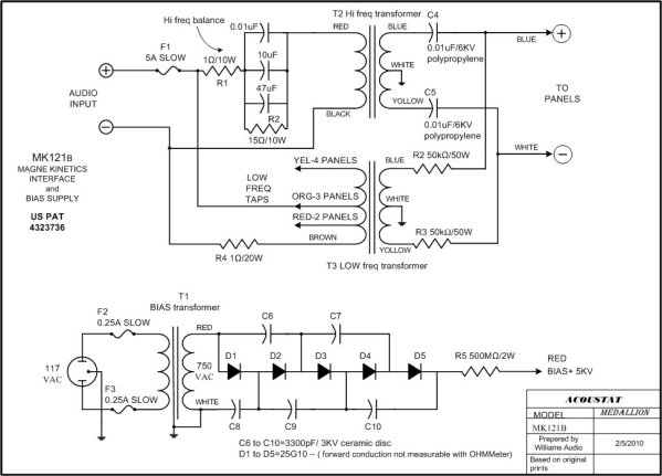

Has anybody used Quasimodo on high voltage power supplies on electrostatic speakers? I am thinking of trying to snubberise my Acoustat interfaces.
Other than compensating for the very high voltage rating needed for the capacitors, it seems like it should be straightforward. But I am wondering if the capacitors in the voltage multiplier would effect things at all. They are connected directly to the transformer on one side of each capacitor as shown in the below schematic.

I imagine that running a simulation can tell you whether the voltage multiplication capacitors do, or do not, influence the secondary's oscillatory ringing. Run it once with C=3300pF and again with ten times larger C. If the ringing frequency changes by sqrt(10) = 3.1X, you know the V.M. capacitors have an influence. If the ringing frequency doesn't change, the V.M. capacitors have no influence.
I've never attempted to snub a 750VAC transformer myself so I have no specific advice to give, except perhaps: be sure to calculate the power dissipation in the snubber resistor! It might be surprisingly large.
