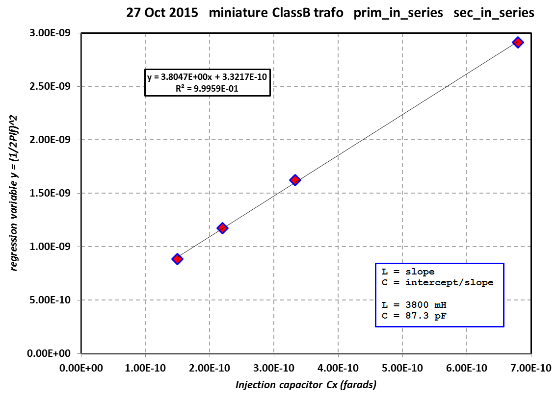

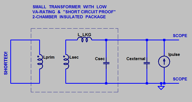

To my great surprise, I found that the secondary leakage inductance of these tiny transformers was almost four Henrys (!). I used the linear regression method to measure this inductance; it is discussed in the Quasimodo Design Note {attached to post #1 of this thread}, Appendix C.
We short out the primary which effectively shorts out the secondary, leaving only the Leakage inductance active. Then we apply a current pulse and measure the frequency of oscillation. We do this for several different values of Cexternal, and then use linear regression to extract the Leakage inductance "L_LKG" and the secondary capacitance "Csec".
Shown below are my measurements. The extracted leakage inductance was 3.805 Henrys [call it 3.8] and the extracted secondary capacitance was 87.31 pF [call it 90].
Here's an amusing result: if we connect this transformer to a PCB and rectifiers whose total capacitance adds up to 150 pF more, then the optimal value of snubber resistance which gives perfect zeta=1.00 damping, is
  • Rdamp = (1/2) * sqrt(3.8 / (9E-11 + 1.5E-10)) = 62,900 ohms
Wow! If the secondary RMS voltage is 88 volts, then we can connect this resistor directly across the secondary (with no series "Cs" capacitor), and the power dissipation will be (88*88/62900) = 0.12 watts. An eighth of a watt! And if the secondary RMS voltage is less than 88 volts, the power dissipated will be even smaller.

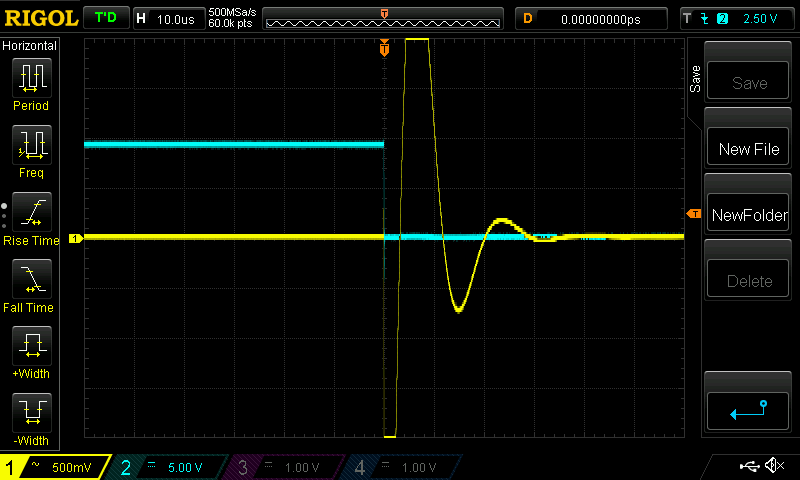

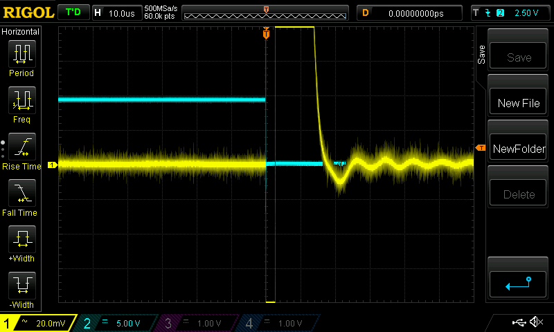

Small PCB transformers - using Quasimodo with C2 and C3 shorted

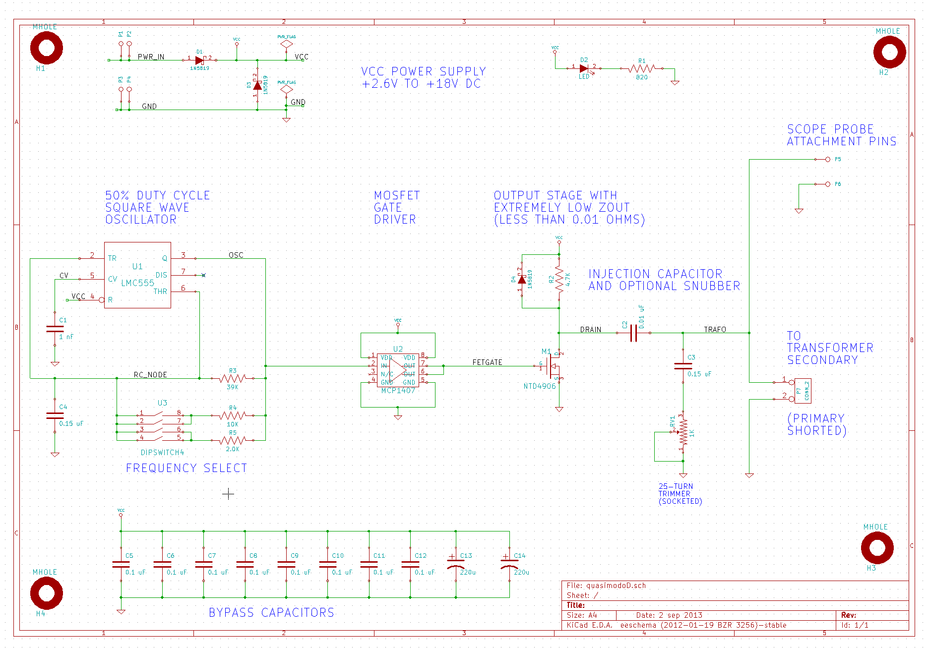

I recently purchased some PCB transformers from the Block range. Today I coupled up a PT series 7.5VA 2x15V transformer to my Quasimodo jig to look at snubber optimisation without the use of the series capacitor "Cs" and the parallel capacitor "Cx" as per the conversation above and also mentioned here.

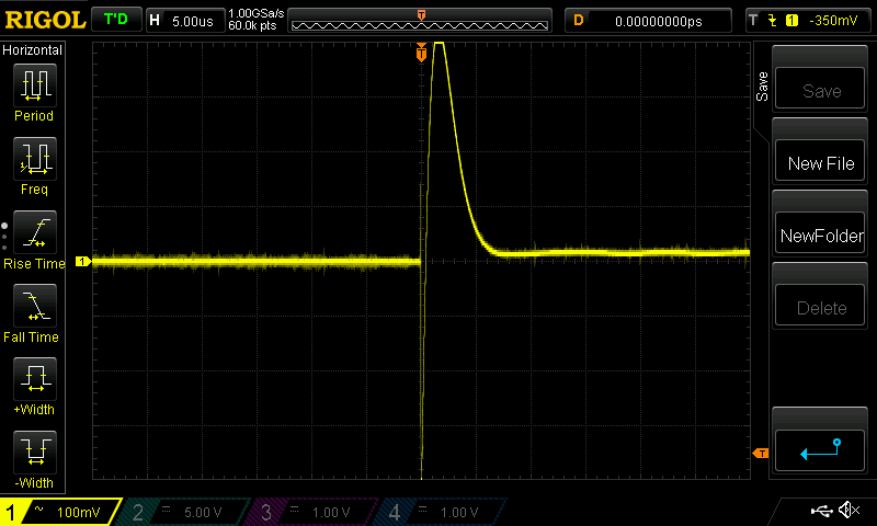

Using Quasimodo with just C3/Cs shorted was straightforward. I could trigger off a pin connected to the left side of C2 (see Quasimodo_V4_TH_sch.png attached here for ease of reference) in the usual fashion. Ringing from the transformer was most prevalent when the driving FET drain went low and so I focussed my optimisation efforts there. Attached are scope pics for Rs 345R, 165R and 154R, respectively. The latter value seemed a bit more optimal when viewed with much greater vertical resolution.

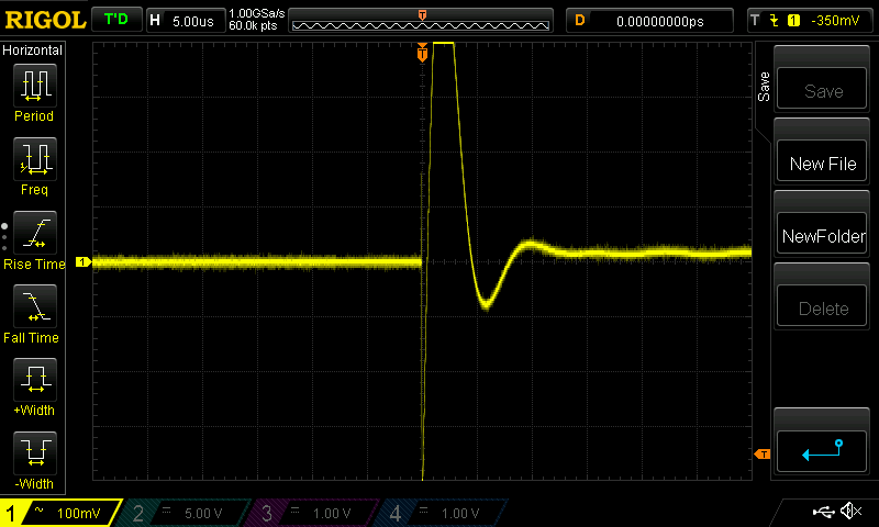

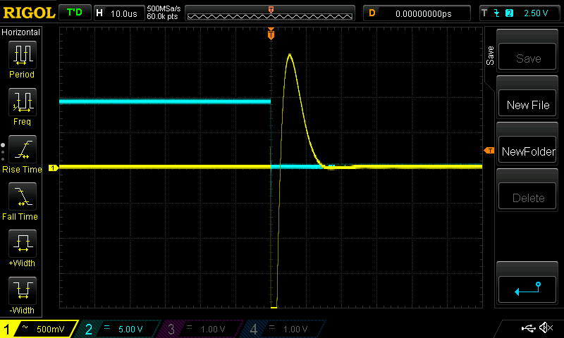

Shorting C2/Cx, however, was a little more problematic. I immediately lost my ability to trigger the scope as before and so had to trigger from Channel 1, the transformer secondary waveform. Attached are scope shots for 912R and 415R, respectively.
Clearly the dissipation of Rs for the latter scenario is considerably more than for the case Mark examined above and attempting to snub without Cs and Cx is likely inadvisable.

The Quasimodo design note pp.12-13 talks about how to use Quasimodo to optimize a 2 element snubber (Rs and Cs but no Cx). Allow me to suggest that you consider this approach ... using Cs=Infinity. An infinite capacitor is of course a short circuit. This little trick was also used in the Appendix of the Soft Recovery article in Linear Audio; it simplifies the analysis.
Following p.12-13 you can use Cx=(summation of terms) when dialling up the optimum R on a Quasimodo board. In fact, that's what I would do. That's what I have done, myself, more than once.
I'm not sure I see a compelling reason to discard the CRC snubber. The potential to drop two caps per secondary from my PCB was worth pursuing but dropping one per secondary gets close to being neither here nor there. (Incidentally, with this little transformer and Cs=150n and Cx=10n, Rs came out at 176R or so.)
