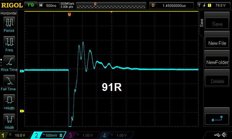

I measured about 5-6 my transformers by now (all are toroids and one is R-Core 30VA) and all measurements are directing me to use resistors in range of 5-10 Ohm. I see guys used here 120 Ohm and some times higher values for some tranys. I curious my be I'm doing something wrong...? I use 18v DC for our jig and try to copy your procedure correctly... Please advise.

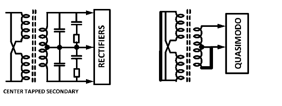

Every time someone posts this request, I give the same answer: If you don't like or don't trust the no-math answer, your only alternative is to use math.
I suggest you begin this effort by measuring the leakage inductance of the transformer secondary (in Henrys) with each primary winding shorted and with each other secondary winding shorted. These shorts are shown as heavy black bars in Fig 13.d of the Quasimodo design note.
Once you know the measured value of the secondary leakage inductance, and once you know the values of Cx and Cs you will use to snub it, then you can calculate the value of Rsnub which gives zeta=1.0. If the calculated value of Rsnub equals 5-10 ohms, everything checks out.

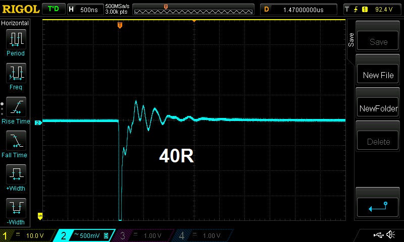

Alexkosha, it appears you have misconfigured your scope probes AND misconfigured your CH1 & CH2 settings
Did you notice that photo#1 of post 706 says (upper right) that you are triggering the waveform capture, when channel 1 rises through +79.0 volts? That seems very unlikely to me, since you are powering your Quasimodo from a DC source less than 20 volts -- probably a 9 volt battery. Where oh where are you able to find +79 volts in a less-than-20-volt circuit?
I recommend that you invite a friend who earned a four year Bachelor of Science degree in electrical engineering, over to your house for pizza and beer. Halfway through the meal, ask her to show you how to set up your probes AND your CH1 & CH2 settings. Ask her how to hook up a probe to the calibrator and then use the AUTO feature to make the scope automatically set its vertical and horizontal systems to something approximately decent.
(Your .txt files say that CH1's settings include 10X attenuation, but channel 2's settings include 1X attenuation. One of these is wrong.)
After you've got your oscilloscope probes configured correctly, and after you've got your oscilloscope's CH1 and CH2 settings configured correctly, I recommend you perform the confidence-building Quasimodo experiment described in post #487 of this thread. Then read post #257 of this thread.

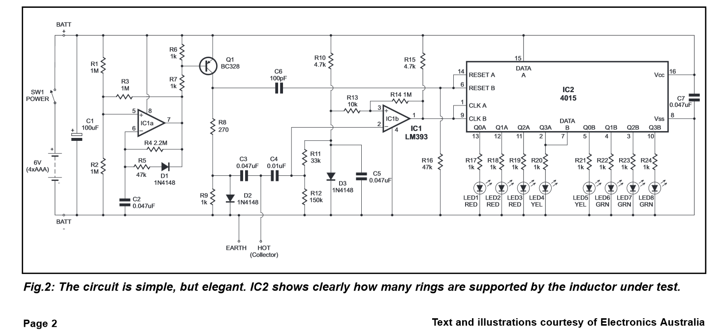

A quick google search revealed more than one way to skin the cat, and therefore, more than one circuit schematic. I grabbed this photo of one person's build, of the "Dick Smith Australian" design variant; it's quite well constructed.
