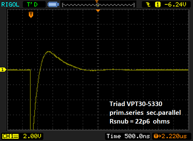

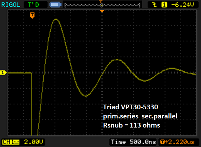

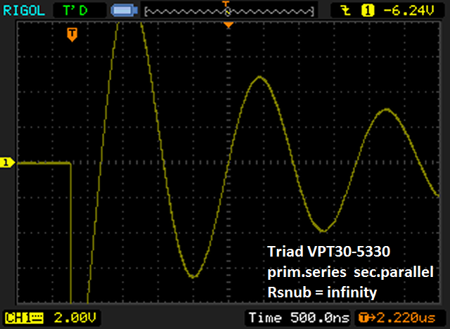

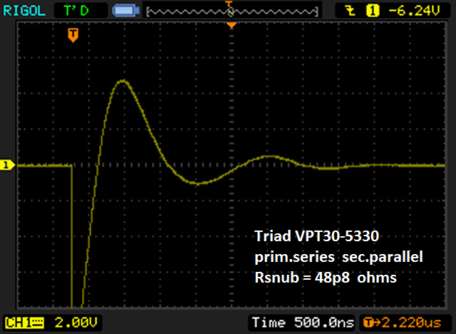

It took some strenuous negotiation, and a plate of cookies, but I was able to borrow a copy of SGK's transformer that he used in posts #230 and #235. A scan of the product packaging is below, showing the model number: VPT30-5330.
I verified that this transformer's phase dots were marked correctly, using the procedure in the design note appendix D.
Copying SGK's setup (series primaries (230V), parallel secondaries (15VAC)), I connected it to a known-good Quasimodo and a known-good oscilloscope. Capacitors Cx=0.01uF and Cs=0.15uF were measured with a capacitance meter, and inserted into the Quasimodo sockets.
As I slowly dialled the trimpot down, I got the sequence of photos below. In my opinion, this particular transformer was critically damped (zeta = 1.0) with Rsnub = 22.6 ohms. This Rsnub is lower than I measured for my Avel Lindberg toroid with two 35V secondaries in series; but the lower voltage and the parallel secondaries probably explains the difference.
SGK, I recommend that you measure the ringing frequency of your transformer when Rsnub = infinity, and compare that to the ringing frequency of this borrowed transformer on the Rsnub=infinity picture below. If the two ringing frequencies are about the same, the two optimum Rsnub values will be about the same too.
