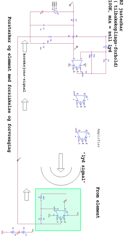

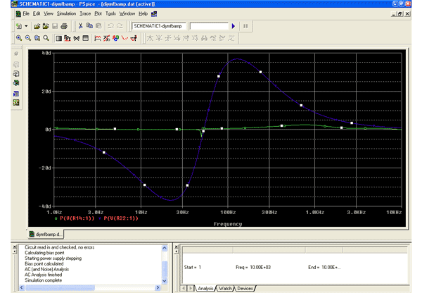

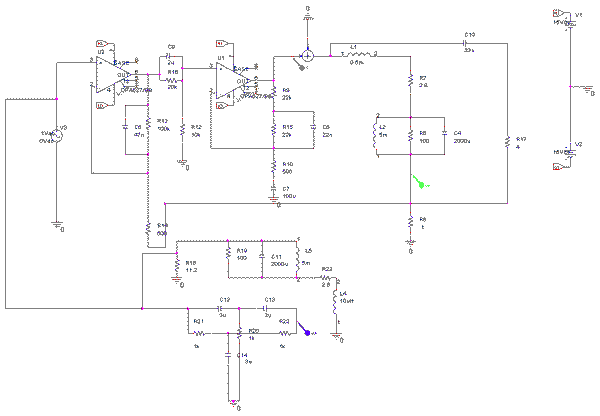

🙂 As K increase "it" will come closer and closer to current feedback. The main thing abt this that it is possible to easily increase the sub performance, must say a lot! say you have 6dB feedback only, then som improvement for the fase, and som dB' at corecting frequency response. Togheter this is a lot! It definetly sounds like a lot. I've tried dvc feedback on my four 12" underhung tc-sound With a K of 150 (without the correct correction sircuit, but a aproximation). There is nothing even close, exept real life.
Currently adjusting my new circuit with accelerometers. There the possible feedback increased as the amplifier driving the speaker was made current feedback. There is limmits for the current fedback, open loop etc. but more of it seem to improve performance for the total circuit.
A real element is 3.rd order, makes the PID (Proposjonal Integrator Derivator) circuit more difficult to make and adj. But after all current feedback has near the same freq response above elements resonance. Then i think integration from the resonance and down. Then a small amount of D but high i mean 100-300 hz region as D also improves phase you dont want to much at low or resonance as fase is ....... Therfore i vant to know: How abt a BIQUAD filter in front of the amplifier, here the adjustments have better range ? compared to PID? ( P= K proposjonal gain)

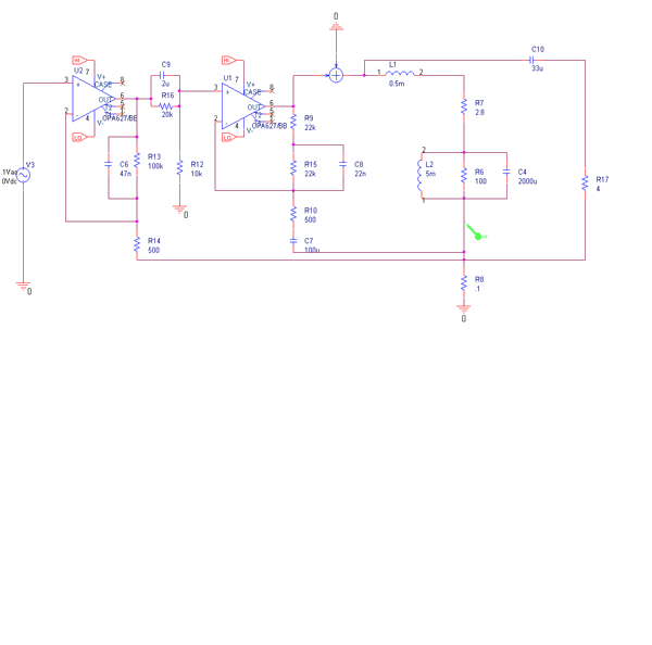

Making The amplifier a current gain amp :In this example the element's "Q" at resonance is high, thus high voltage output is needed. So there is still a kind of requierements for high power (Voltage swing) amplifiers. To lower this "Q" the volume of the kabinett neads to bee increased. but this will lower q only to a certain ekstent.
Current drive removes phase problems :

The "conjungate nettwork" C10 R17 is there to increase stability.
C9 R16 is there to increase fase margin near elements resonance.
In my case im using buffered accelerometer inserted at R14, and the R14 repleased with 3k and 10u series cap.
As the current is the force needed to corect for distorted acceleration the phase of the current is important as this also gives/tell us the direction of power
The fase in the current drive circ:
As for the voltage feedback at the secondary coil of dvc elements the phase shift at resonance needs to bee compensated for. It will then bee somthing near the nettwork attached to R14, L4 beeing the secondary voice coil.
Alternative is replacing the nettwork with a "doble T filter" as this can bee made a good aproximation to the "stupid" values in the compensating nettwork.

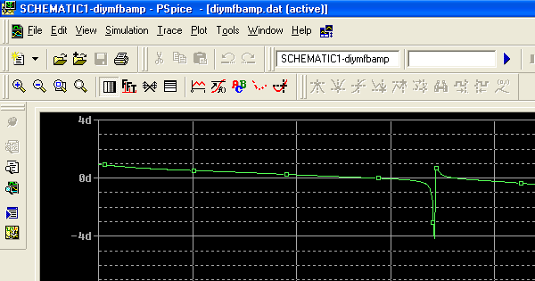

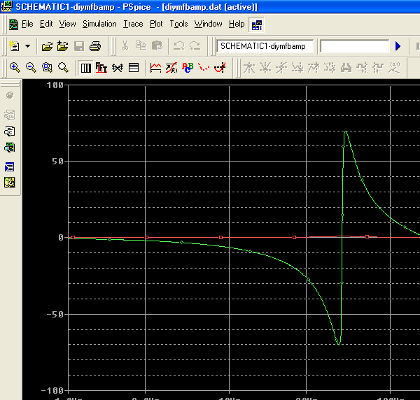

fase of T filter :

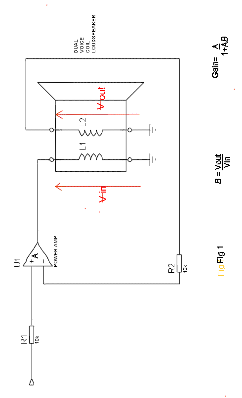

Designing Motional Feedback Loudspeakers
I did a fair bit of work on this subject, using dual voice-coil speakers, and I would like to share it with you. I will need to do a few posts, so please be patient. Tell me what you think, it aint perfect, but it is simple, suitable for DIY.😀
The first thing with a feedback system is to ensure that it's stable. At low the low frequencyend I direct-coupled the amp. The only phase shifting device at low frequencies is then the loudspeaker itself. At high frequencies I had to start the roll-off at 1kHz. With these precautions, the d.c. open-loop gain of my system is about 150dB, and it’s perfectly stable.
The analysis of a speaker system can get very complicated. At the time I had neither a computer nor sophisticated test gear, so I adopted a different approach.
In the attached image, the gain equation is the same as that of an op-amp. The gain is set by the feedback transducer, whatever that may be, rather than the pair of resistors usual in an op-amp circuit. As in that case, when the open loop gain, A, is very large,
The equation becomes;-
Gain = 1/
End of part 1🙂
Gain = 1/B

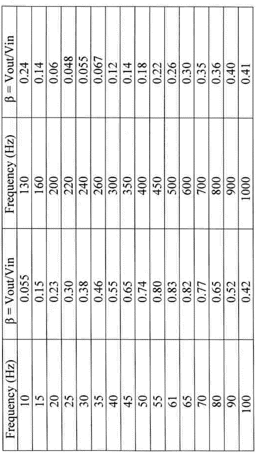

I measured Vout and Vin at various frequencies using my sig. gen. and ‘scope, and calculated â for each frequency. The results are given in the table below.
The maximum feedback voltage occurs at 61Hz, the bass resonance of the speaker mounted in its box. This gives maximum damping at resonance, which is what we want. The problem is what happens when the feedback voltage is small? The system gain becomes large, and the response peaks at very low frequencies and at the minimum impedance frequency, 220Hz in my case. The size of these peaks is proportional to the open loop gain.
If current feedback is added to the voltage feedback, then when the feedback voltage is small, the current will increase, and the voltage developed across the sensing resistor will prevent the peaks. Previous posts have suggested using current feedback,
but how much?

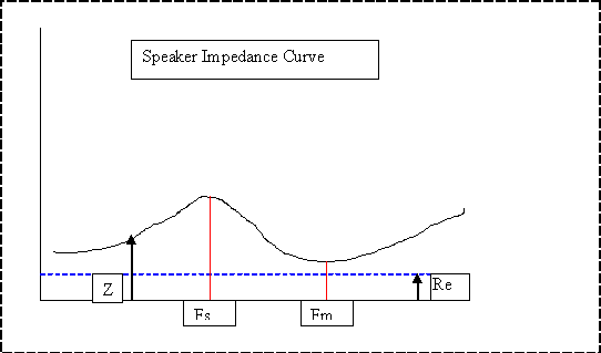

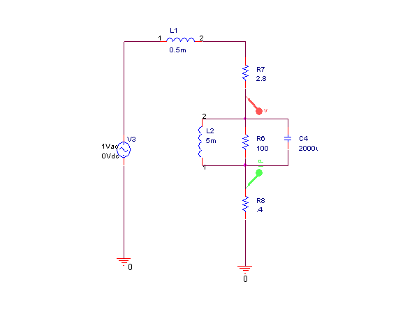

I have attached a freehand sketch of the usual speaker impedence curve to illustrate the following points;-
Fs is the usual mass- compliance resonance of the speaker in a box. It is a parallel resonant circuit with a maximum impedence at resonance.
Fm is the mass-inductance resonance. It is a series resonant circuit with a minimum impedence at resonance.
The phase shift at both Fm and Fs is therefore zero.
The e.m.f induced in both driven and feedback coils due to motion must be the same, the coils are identical and they move together in the same magnetic field. The impedence curve reflects the induced emf. If we assume that the errors are small, we can write;-
B = (Z-Re)/Z
There are problems because of the phase shift in Z, it should be a vector subtraction, but if only two points are chosen, Fs and Fm, then phase shift is not a problem. This is good, only two measurements🙂
The expression above can then be used to combine the gain due tocurrent -feedbakk with the original expression for gain due to feedback from the second voice-coil.
An expression for the complete system can then be derived.
