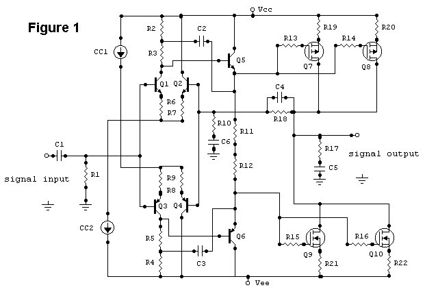

Greg,
HEXFET's, do you use (IRF) vertical FET's in the output? In such cae I wonder wethere you have Q5 and Q6 thermaly tied to the output FET's Q7, 8 9 & 10 because of their positive tempco, if thermaly tied together it will compensate a bit for thermal runaway in those output FET's.
When thinking of thermal compensation, it hits me that also if Q2 and Q4 would be thermaly connected to the output transistors mentioned above will give thermal compensation as well.
And there's more posibilities too actually when one get's passionated thinking over it...
The above applies to the attached schematic here below fetched from your link in your earlier post in this thread, hope that's ok for you Greg.
What is the overal gain for the whole circuit before FB is applied?
Tell me about C2 and C3, are they small values in order of pF's or so, or is it such a high value it can be considered as a bootstrap capacitor?
Cheers Michael

Hi Michael,
I designed it around IRFs! The 3-4V gate voltage. In fact the tests I did covered 100 prs of 2 batches and determined tempco which are compensated for in the final. Yes - looking for the tempco comps was fun and, if you look at the blurb on my website I indicated a variety of tempco comps. At least three.
Q5,6 only provide a fraction of the measured tempco so I have devised simple, largely existing, alternatives.
The C's 2 andf 3 are serious bootstrapps. They are larger than needed for response boost , for PSRR boost!

Hi Greg,
I really like your topology. I believe it solves many of the usual problems...... And the use of emitter followers to drive the gates is very appealing to me, and the simple use of a bootstrap enables constant current operation, high linearity, while accommodating very good offset control.
Try using different values for the complementary bootstrap caps. It will sound quite different and you might even like it.......

Konnichiwa,
I rather like it in many ways.
But I retain that the differential Amp's are troublesome.
If you can do me the honours and just forget for a moment that they are "differential amplifiers", which in your case is not the case.
Let me restate for you your Input/VAS topology:
"A pair of rail symmetrical single ended amplifiers are used as voltage amplifiers with the feedback signal applied to the emitters using emitter followers."
One may ask why not return the feedback signal to the emitter without buffering? And why use BJT Inputs?
If do that we arrive at any one of a number of variation of Mosquite/Buzzquito/Zenquito et al which are popular with the French, with rail symmetric differential or rail symmetric single ended frontends....

Konnichiwa,
It will work if we do it that way....
There is BTW a very neat possible qiescent current compensation scheme possible in this circuit (not drawn), by making the current sources suitably active with a DC loop back from the source resistors, bootstrapping could also be employed, but is probably not needed.

Hi Guru,
This topology was obviously designed for Fet outputs, I am using BJT's, mostly because I have plenty of them. I have grown fond of the EF stage instead of feedback pair(although yours is not exactly FP) for lower impeadence and thermal stability because of the very positive tempco of BJT's. But your topology idea could be used there as well i suppose. Drivers could probably be smaller. and freq responce will be higher. With FET's you loose the Vgs with SF, which is much greater than Vbe in EF, so it makes lots of sense to your design.

Kuei Yang Wang said:Konnichiwa,
I don't think so. This time the feedback is okay, but your biasing is in
no way defined ! You can't have work 2 currents against each other
and expect a defined voltage... It would work if you replace the 2 ccs
with simple resistors or use your mentioned "dc-servo".
Sorry to be annoying,
Mike
Konnichiwa,
First, the circuit as drawn is meant as "simplified principle" diagram (as are all the others), secondly, if I select the CCS J-Fet's for sufficiently identical and appropriate Idss (the frontend FET's BTW also would need selection) I CAN expect defined biasing just fine. The exact biasing would then be determined by the frontend source resistors.
You are not annoying, you are merely completely wrong, which is no problem to me.
Sayonara
