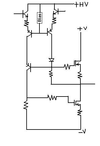

Hi Austrailan Babe,
Yes i have heard it ....but if you want, send in the details too me...
Take a look at the attachment ..it also features PSRR greater than 120dB
K a n w ar;) :D :D
