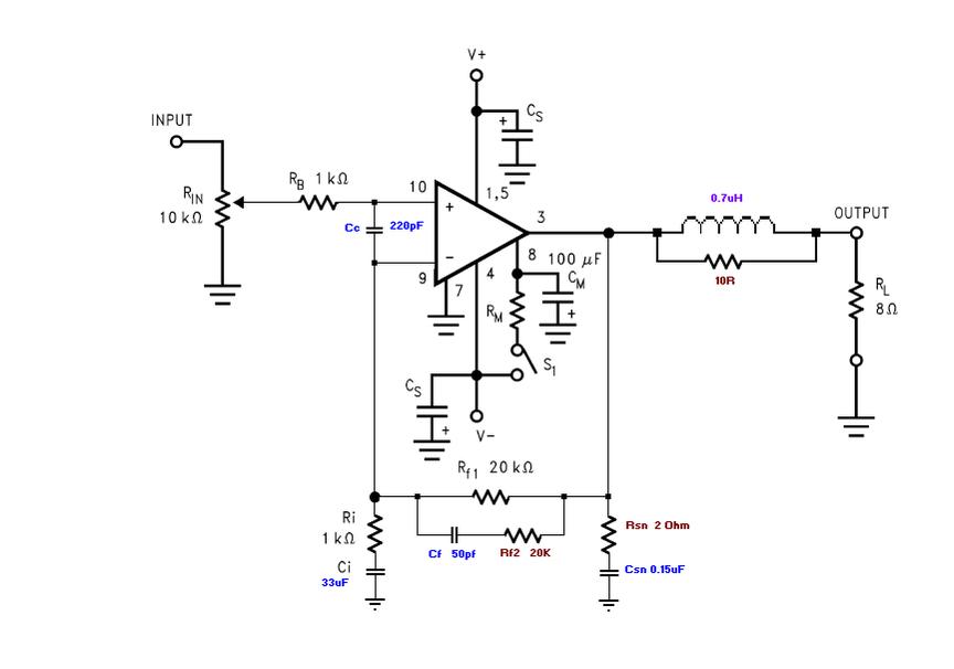

Any way here is what I have come up with,
I intend to power it with 200VA Antek 22V torroids. One torroid for each channel. Once I have it running in a way that I like I will probably also power the tube with a torroid for symmetry on chassis.
Where to buy the .7mH inductor or can it be made with a few turns of wire over the resistor?

The torroid is probably a good choice. It seems that you have inbuilt some amount of tolerance for 4 ohm speakers, considering that 22vac voltage, per each bridge rectifier, per each rail.

Turns of wire over a round resistor works well. Um? Can we use a 4 ohm resistor? Personally, I have better luck with that.

10 turns of enamelled 18 or 20AWG copper over the body of a 10 ohm / 3W resistor.

10 to 12 turns of approx 6mm diameter using 0.8mm or 1mm diameter enameled copper wire.Where to buy the .7mH inductor or can it be made with a few turns of wire over the resistor?

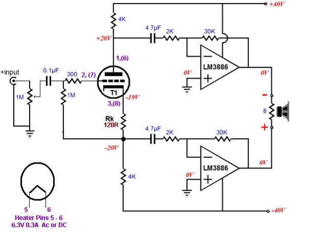

You have the components needed for this, Rk is 120Ohm for the 6922.
This configuration will not have all the gain you need. We can add another tube gain stage in front of it, OR we can increase the gain on the chips. Broskie is only running the gain @ 15. I am sure we can increase this but the chip guys need to confirm.

I had the idea of a "Push Pull" amp in the back of my mind for sometime. Push Pull Triodes give excellent power and VERY reduced Distortion on the even order harmonics. Bear in mind a couple things. MATCHING the gains on both chips will be important. You will need to hand match some very low tolerance resistors in the feedback path. The output taken from the plate of the tube is INVERTED copy of the signal. At the cathode the signal is IN PHASE with the input. In effect we are building a Class A push pull amplifier.
What is nice is any nonlinearity in the tubes response cancels out.
Since I expect to be driving my amp with about 2VRMS signal this circuit will work perfectly. In the case of low input signal we can simply add another Gain stage with another triode.
There is also no reason why we can't run the tube from a separate supply voltage. The tube is only AC coupled to the chips via the 4.7uf caps.
The reason I say this is the sound of the tube will be determined by the regulation in the powersupply to the chips in this design. So any variation in the voltages presented by the Power Supply changes the Operating Point of the tube. I also do not like Broskies math. He shows that there is 8mA thru Rk and 5mA thru each 4K load resisitor. I have no idea where that other current comes and goes. It is probably just his "rounding" but I would rather recalc my own operating point and use a separate supply.
We will need 6.3V 0.3A supply for the tube heater so a small transformer for B+ a Tube Rectifier and filament supply is no big deal.

If you do not mind being a "Guinea Pig" can you try this circuit as I drew it?
I am interested in the grounding scheme. I assume we "float" the speaker since it is returning to ground alternately thru the chips.
