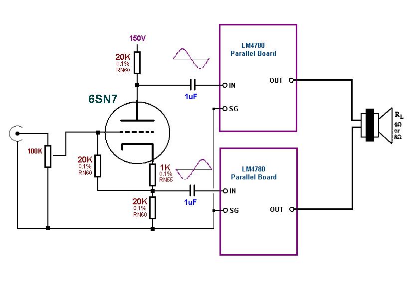

Goal is to take a relatively low level signal (in Daniels case a PC sound card or I-Pod) and Amplify it with a Tube, this will impart some of the "tube sound" into the signal. Since the tube is going to have significant gain, any gain in the chip circuit MULTIPLIES that gain. Now for Daniel, a gain of 20 is probably not all that bad since he is looking for a total gain of 50 or so.
500mV x 50 so if we can keep the tube to about a Gain of 3 then we are Ok.
Tubes do not like to be run with such small loads, voltages and currents.
One option might be to NOT amplify the signal but simply put in a phase inverter (Split Load) which has almost Unity Gain (but since we are splitting into to Inverse Signals it has the effect of a gain of about 2)
In may case I have a preamp that is feeding about 2V RMS signal so I REALLY cannot afford too much gain. But If we use the tube inversion method I can keep it under control.
What is the thought of using a gain of about 17-18 on a NON-Inverting Parallel configuration?

Think of it like this

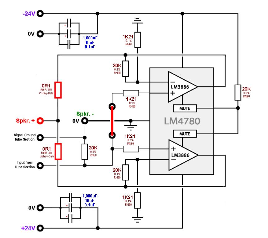

The signal comes in and enters the Grid of a Triode Tube.
I take an "in phase" signal from the Cathode and an "Inverted" signal from the Anode (plate) They are identical except for phase and the amplitude will be about 90% of the input.
So overall we get a gain of about 1.8, the signals will be fed to LM4780's in parallel on their own boards.
The outputs of the Pairs will be "Bridged" to the load.
see attached

This layout I think is overall the "optimum" design for bringing the tube and the chip together. Point to Point is an option but would be rather difficult with 4 chips per channel. I like the layout of the PC boards and Zobel components can be added later if I feel the need.
I look at it as, each board is essentially a parallel pair of power triodes. As I delve deeper into system design and loudspeaker design I might even go as far as raising the Low pass point of the crossover at the front of the system and then run a "Subwoofer" channel and a "Woofer channel". Letting a pair of 8" woofers roll off naturally below say 60hz with an upper low pass of 200-300hz, I can insert another lowpass in this amp to put the subs at 80 hz and down.

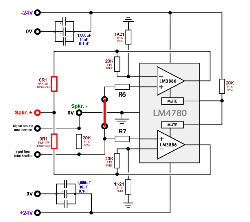

A pair of 3886 chip will perform better than a 4780.
A 4780 operated in bridged mode will operate better than a 4780 operated in parallel mode.
Choosing to use 4780 in parallel mode guarantees the poorest performance of all the options.
If you must use the 4780 then adopt bridged on the one chip. Then parallel as many as needed to suit the driver load and PSU voltage.
+-28Vdc and bridged will work badly into 4r0 and even worse into 4ohm.
+-28Vdc and bridged will work reasonably into 8r0 and poorly into 8ohm.
+-28Vdc and bridged will work well into 12r0 and reasonably well into 12ohm.
+-28Vdc and bridged/paralleled (BPA200) will work well into 6r0 and well into 8ohm.
+-28Vdc and bridged/triple paralleled (BPA300) will work well into 4r0 and well into 6ohm. It may perform well into 4ohm but you are stretching it when you read the specifications.

I have chosen a gain of about 18 for the chip amp.(20K/1K21)
The configuration is basically like that shown in Fig 7 of the BPA200 sheet.
Except that the bottom pair (LM4780) is not Inverted. The signal feeding it is inverted.
Supply will be 24V + or -
Load will be 4ohm or higher possibly as I design the system.
The performance is not the best, but the configuration, ease of build, availability of reasonanble priced boards, ect fits my requirements.

Correct me if I am wrong but the parallel pair "sees" double the load presented to its output correct? So each have of the chip sees the same load. The bridged sections then see half the load so 2ohms.
Each of the 4 sections of chip are now operating into a 2 ohm load which is not ideal but since we are halving the current is should be OK?

I suspect the sensitivity is actually 88.7dB/2.83V @1m rather than 2V for 1W into 4r0.
The actual sensitivity may be ~86dB/W/m. To get 110dB @2.5m from a pair of these you need ~850W per channel into 4r0.
Now to the chipamp datasheets.
The load impedance is critical to the design of the chipamp.
You must select supply voltage and heatsink capacity based on load impedance and desired power target.
The advantage to using +-24Vdc to drive a 4ohm speaker from a parallel set up is that the heatsinking requirement is much lower and this will suit the 4780 better due to it's inherent lack of ability to dissipate heat to the sink. A parallel 4780 will need about 1.8C/W @ Ta=25degC.
If you decide to bridge a pair of these paralleled 4780 the whole ballgame changes. Instead of each amp seeing 8ohms as it's speaker load they each see 4ohms and each 4780 now needs 0.7C/W and will be noticeably hotter than the simple paralleled device. But for this the power increases from ~40W/channel to ~120W/channel.
