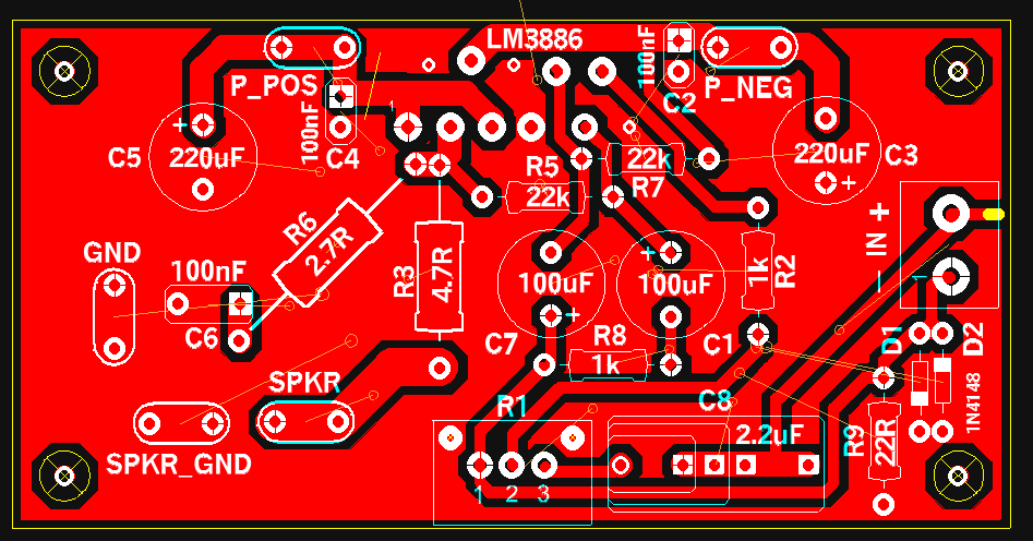

Anyway...this pcb is not DIY-friendly, because of the difficulties of heatsink mounting AND a man should show his tube, instead of hiding it in an amplifiers case.

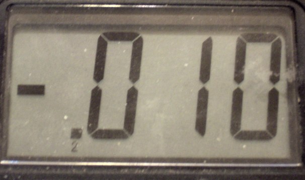

First test was this Building a Gainclone chip amp with T-network feedback. by Franz G, Joe Rasmussen and Nick Whetstone.
I just adapted it for LM3886 and connected it to the power supply posted earlier. A 4.7uF 250v polyester (normally seen on tweeters) was added to the output of that power supply at V+ to V- to short noise that would have otherwise increased with frequency. Caps at the chip pins are 470uF//100nF (perhaps they should be 330uF and/or perhaps the input dc block cap should be slightly smaller).
Curious results:
1). First time that I've ever heard an LM3886 not screaming, shouting, or otherwise misbehaving like a poorly compensated op amp. Yes, it sounds perfectly acceptable. Very decent large soundfield too. And the pretty bass sound of LM3886 is present (otherwise, I think that nobody would spend so much time fooling with this little chip).
2). Far too much gain!!! Not even the weakest MP3 player needs so much gain. I'd be the last person to complain about too much gain, but this really is too much.
3). Practically no power--it didn't play a bit louder than LM1875, until. . .
4). Since there's no NFB cap, I tried an output cap, and ended up with partial success up until the output cap trial and error became just like a copy of one rail of the power supply. . . then (only then) there was appropriate output power. Apparently, 0mv dc offset works much better than 10mv dc offset. Weird.
5). Maybe there is too much bass. You certainly wouldn't need a bass booster with this one.
The T-network design had too much gain and a few other oddities. It sounds surprisingly nice.

No time like the present: I changed the gain in one of my LM3886 amp boards to nearly 5 first with no signs of instability and then to 4 with the same result: no sign of instability.
I used the recommended schematic from National and there is a Zobel and output inductor in place.
Hope this helps.
Hope this helps.

My layout:
I changed R8 to make the gain lower.
