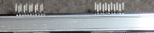

P.P.S. Additional design adjustment: Small U-Channel aluminum stock, available at most hardware stores, over the "face" of LM3886TF, providing additional heatsinking and a much more secure mount. Thermally couple to LM3886TF with arctic silver paste (gray TT paste from Radio Shack local availability) to complete a plastic-to-metal thermal interface.

Local availability of very small aluminum U-channel is Lowes, Home Depot, the hardware store, etc. . .
This provides a slight pressure, which makes the thermal interface on the back of the chip thinner and more effective. The U-channel itself also adds to the heatsinking as well. This doesn't require a crushing pressure, but really just enough to squeeze the thermal paste.
This adaption helps LM3886 with 4 ohm woofers. Of course a more effective thermal interface is for causing the heatsink to be about the same temperature as the chip. The heatsink is hotter but the chip is cooler.
Here it is shown although mounting screws aren't added yet:
EDIT: needs screws at both sides of the chip to prevent accidental chip spin.
