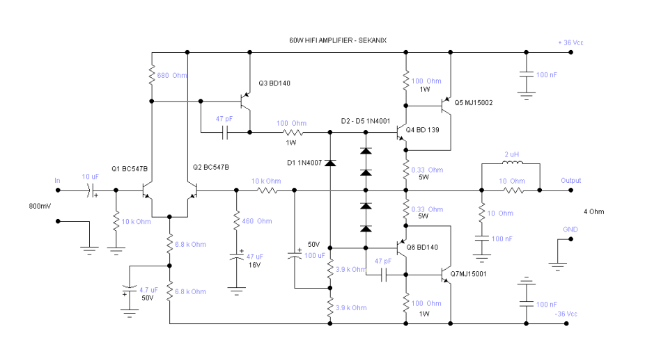

Thanks a lot for your comment. The protection diodes will be removed and BIAS re-adjusted this week, some friend will give me a oscilloscope for some days Now I'm making a VUmeter + Phone amplifier PCB using LM3915 in DOT mode with "analogic-like" display...

Andy L. Francis said:
I mean the protection diodes.
You can remove them without any problem.
Anyway don't forget to install fuses in the supply rails.
Hi!
I already have fuses installed on the power supply.
I think if diodes remover I can change the PCB design and save some space...
