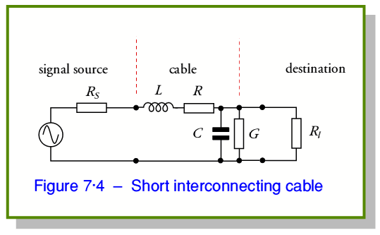

Your only telling 1/2 the story, first put numbers on the dielectric losses (they are tiny) and consider the R/L/C/G circuit. The cable/speaker system can and it has been easily shown to display simple frequency response anomalies due to basic circuit issues. In extreme cases the cable+speaker as a load can make the amplifier oscillate, sometimes only at certain levels. IME parties making the most extreme claims stay as far away from instrumentation and measurement as possible.
. . . consider the R/L/C/G circuit.
This is also worthy of discussion.
By R/L/C/G circuit you are referring to a real world, short length of interconnect cable.
In this case we can forget about transmission theory and analyse the 'lumped' section of cable as a filter placed between the source and the destination.
This filtering action can explain such observations as the increase or loss of high frequencies upon changing an interconnect.
