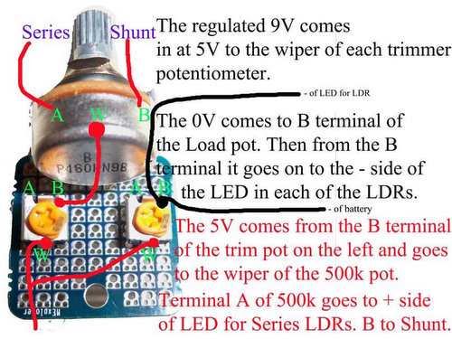

A Pic
Here.
Now you can adjust it to whatever makes your attenuator work well. It also adds a small load to the power supply.
Uriah
