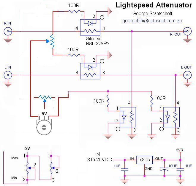

Is this how you suggest to connect the mono pot ?

Hi T,
no,
You have the signal lines OK.
one series LDR in each line and one shunt LDR for each line.
To get these to work as an attenuator you require that the resistance of the shunt LDR moves in the opposite direction to the resistance of the series LDR.
eg.
shunt LDR=1k0 Series LDR=50k Rin of load 50k, Rs=200r.
The 1k0 & the 50k load are // effective R=980r4
The series resistance is 50k + 200r = 50k2
Attenuation = 980.2/{980.2 + 50k2} = 0.0195 = -34.4dB
Now adjust the LED supply current to reduce the Series resistor and increase the shunt resistor. Say the adjusted values are
Rseries=10k Rshunt=12k
attenuation is based on 50k//12k and 10k+200r
giving 9k677 for effective shunt and 10k2 for effective series.
Attenuation = 9k677/{9k677+10k2) = 0.487 = -6.3dB.
For attenuation to work correctly the series and shunt LEDS must adjust in opposite directions.

Right
Seems Im a bit too lazy, and should have measured on pot
Then its quite obvious
to my excuse, I have only mounted a pot once in my life, many years ago
But wonder why George use a stereo pot, but probably just a matter of convenience and durability, I guess
btw, many of these small high impedance pots seems to be made especially for el-bass/guitars
Another point
Why not use a pot for channel balance, instead of multiturns
Will it be too sensitive, and hard to adjust

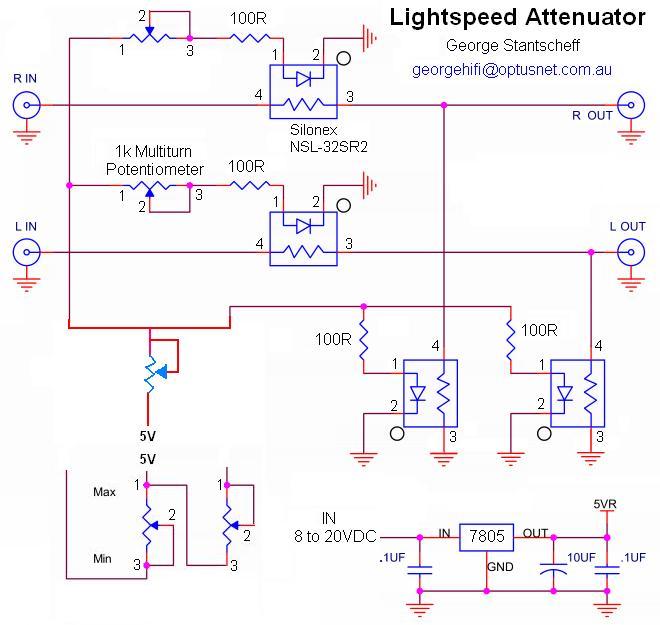

Some suggestions:
If you are concerned about the durability of the pot then put the protection resistor in front of the pot rather than behind it before the LDRs. Just stick any 100Ohm resistor on the wiper and then give the resistor the 5VDC.
Now the pot will only see 50mA. Pretty easy to implement.
Before this change the 100Ohm resistors are in front of the LDRs and after the pot. They are in series between the pot and LDRs but in parallel to each other so we have 100/4=25Ohms giving us 200mA or 1W if it were possible for each variable resistor to be at 0Ohms at the same time. Since thats not then the extreme would be about half of that or 1/2Watt. I have a 1/2 watt dual gang pot running on mine and have no issues, but I also have a near endless supply of LDRs so I am not so concerned about losing an LDR or 4. You might try that mod.
YES! I fully agree that a pot instead of a trimmer is nicer to use for balance control. Thats what I use. I had a 10 turn 5k pot in a drawer and thats what it gets used for. I like the multiturn but on the other hand it would be nice to notice the difference in balance changing quickly with a single turn pot. Its a little fiddly with a multiturn.
George has used both dual and single gang pots. If you think about it the way I described it there is really no difference between the single gangs and modifying the dual gang EXCEPT the power load that the pot can handle. The pots I sent out are half watt pots. AndrewT had expressed concern that they wouldnt work well because of their low wattage but I tend to disagree with him. As a caveat, the guy is hardly ever wrong and I am often wrong, but it makes sense to me that this pot is fine since we are using it as a dual variable resistor rather than a pot that is referenced to ground. These dual resistors we created tame down the current rather than acting as a small load and with the 100ohm resistors in place your LDRs are safe if anything nasty happens but feel free to bump them up to 100-1k if it bothers you. Or if thats what you have in the parts bin. Especially with these LDRs 1k wont make much difference in the resistance of the LDR but will take the amount of current down to near nothing.

I dont know where my head has been. Those 100ohm resistors are NOT in parallel to each other since they terminate into the LEDs. Since only two of them will be getting any significant mA at a time, either series or shunt depending on position of volume control pot, then we just add the max possible amount of mA through the two. 5VDC through a minimum possible 0Ohms on a fully on or fully off volume pot to two 100Ohm resistors. 5VDC through a 100ohm resistor gives us .05A or 50mA. This is an extreme folks and its only if your volume pot if full on/off. So two resistors doing that will pull 100mA through the pot and at 5VDC thats .5W. The max rating for that pot.
If we were to put a 100Ohm resistor in front of the pot rather than following it we get only 50mA or 250mW through the pot.
So I have to say that I have had no problems with the Lightspeed circuit AS IS and I have been running it for over a half a year. That said, next time I build one I will be putting a 680Ohm in front of the pot.
Uriah

I tested. At full blast, the 100R limits the current drawn by the LDR at approx. 30ma which exceeds the specs. I found upping the 100R to 500R would drop this number to 6ma which is more than enough to lower the LDR output resistance to lesser than 100R (BTW, use a 330R will limit to 9ma). As Uriah said, there can be only 2 are in full blast (one pair at full attenuation, and one pair at wide open). Remember, the series and the shunt are see-saw-ing the current demand. So, the pot will only see 2X of this limit passing through all the time, not 4X.
I also found that 1ma was enough to drop the LDR's output resistance to lesser than 1K. So, feel like more protection? Up the 100R all the way to 1K, then the total current through the pot will never be exceeding the spec, 2 x 3ma = 6ma < the safe limit that AndrewT computed!!! If you have a 5K balance trimpot in series with each LDR, simply crank each one of these up a few hundred ohms. This will have the same effective protection.
