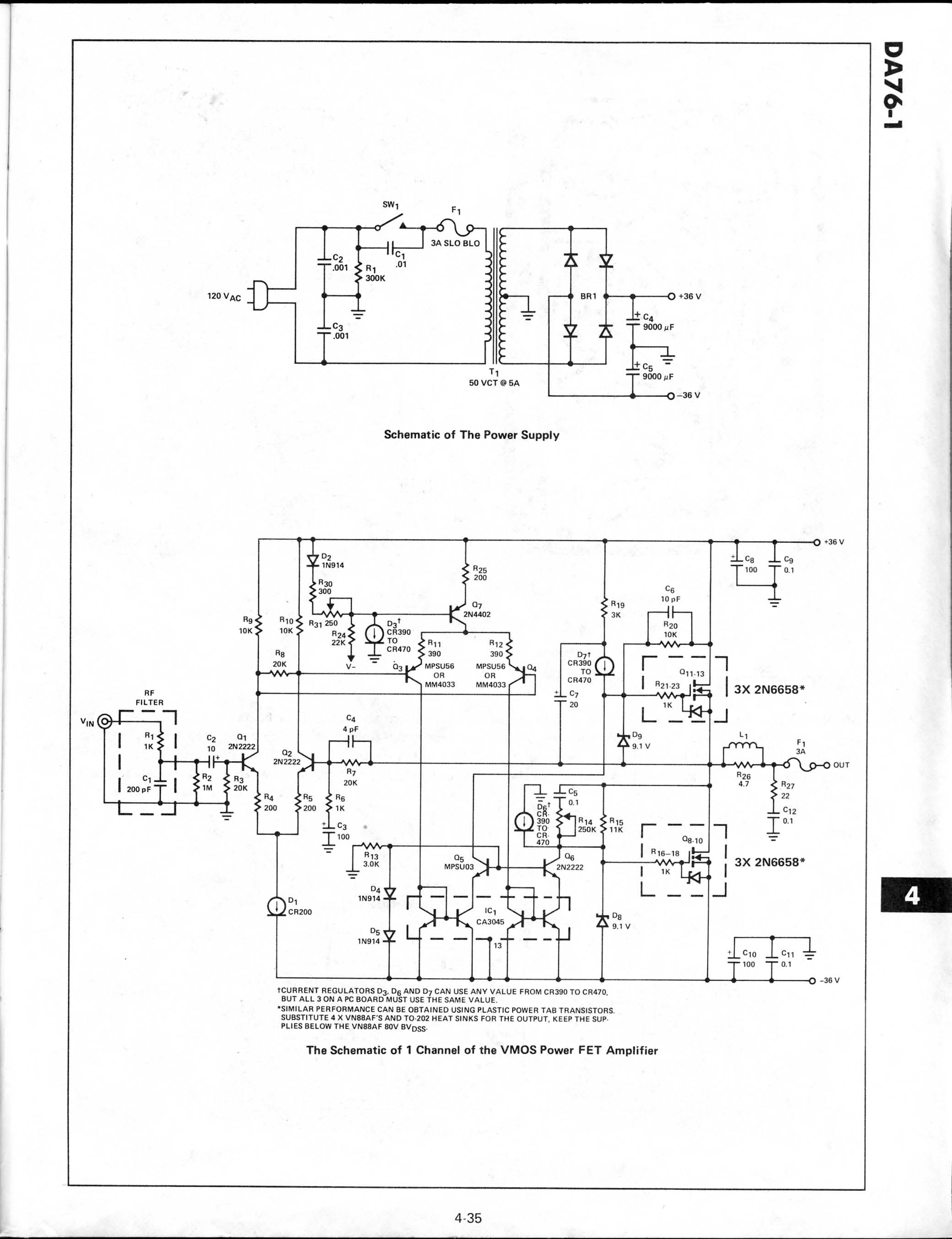

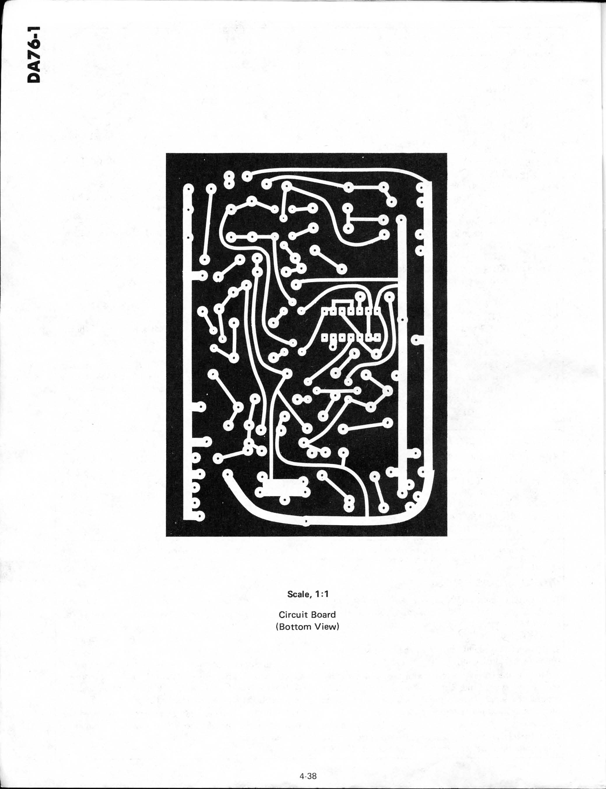

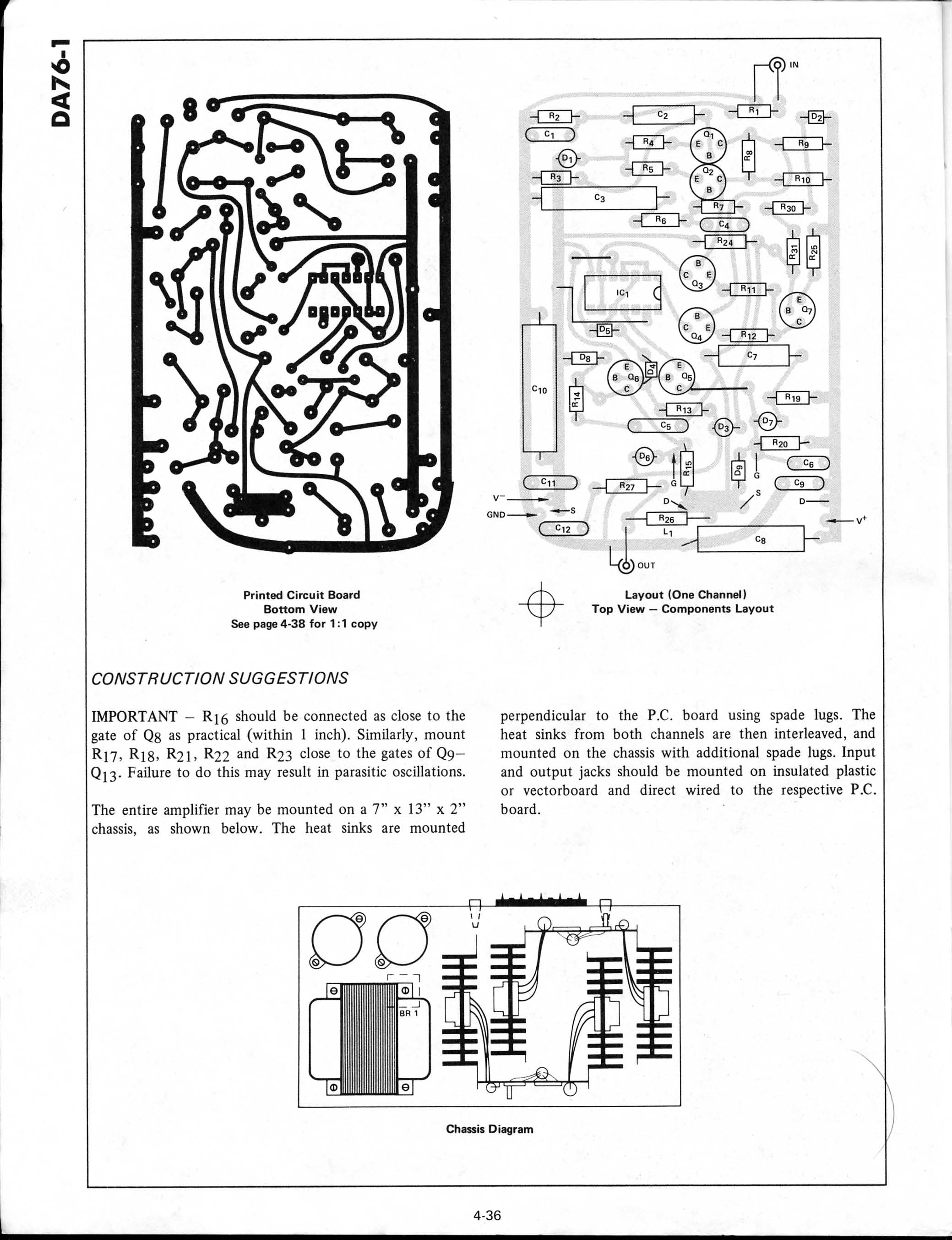

Siliconix & Siemens NMOS amplifiers
Here it is, hot off the scanner. Message me if you'd like the pdf instead (these jpgs were exported from the pdf since it was too big to attach here).

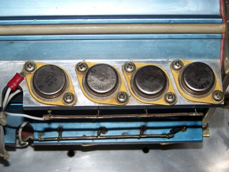

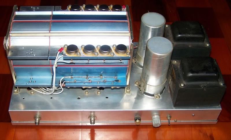

I built several of the audio amps ala Siliconix 1979 app note DA76-1. I still run the MOSfet amplifier today. Sounds as good as any tube amp even driving difficult complex loads such as Magnaplaners or full range electrostats. The 2N6658 are very linear and the Siliconix design used very little negative feedback. Closed loop BW was 800Khz. The extremely wide BW and very low negative feedback means this amp has the transparent sound quality of the best room heater tube amps. I used eight 2N6658 MOSFets instead of the twelve suggested by DA76-1. Here are a couple photo of my amplifier I built 30 years ago and still use.
