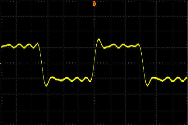

... today i have started to take some measurements over the DSC2.
everything seemed perfect.
until i player (trough hqplayer) a 10k square signal.
Not sure if that is supposed to look like that.
the transformer (chinese Black 300+300ohm) is properly loaded to get 6k. Outputs configured for singled ended operation.

looks fine...

Looks fine. I suppose you are using one of the MP filters in HQP, right? This waveform shows the ringing of the filter used in HQP for oversampling to DSD. This looks like an MP filter response, with the ringing after the impulse.
Can we see the schematic.

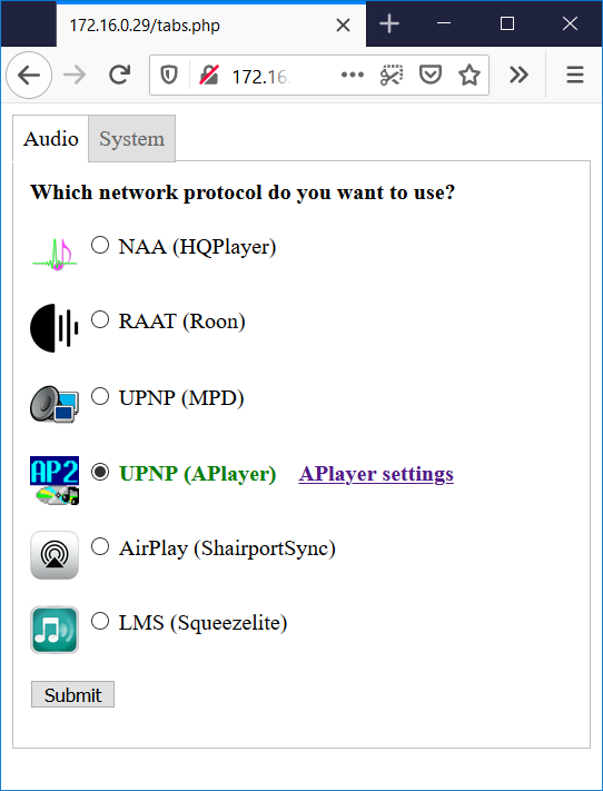

Functionality extension (beta) in micro audiorender for BeagleBone:
  1. New audio renders of the LMS and AirPlay protocols have been added. (no DSD support)
  2. Added support for wpa WFi.
Linux kernel remains the same - 4.9.146-Botic7-rt
http://puredsd.ru/buildroot/sd_botic7_V2.img.gz
ssh root/root
I think that You have "ringing". It is not supposed to look like that. The goal is to have as much squared as You can. And this "type", have always sound signature.
Try to use RC notc filter at secondary. Use same 10K file signal and if You have 15K and 20K to check...
R value should be as higher as can be C value opposite, lower as can to make output signal right squared. First step is higher Values of R say more than 6K to lower values, C from 33pF-100pF and up to higher values.
* You have some aplication for that in Jensen papaers, about RC notch filter...
After that You can Terminate with R and that larger values than 6K and optionally get smaller.
Do not "round" edges too much - will cause loss of Sleeve Rate.
Also bear in mind IF the trafo is at very end without buffer, the next Rin of the preamp say, will make lower value load in parallel with load resistor at the secondary... (Also capacitances of cables is factor in that case.)
Also check the phase IF You have some sweep software and hardware to generate DSD from I2S or so. (because I think that we dont have any software for DSD out?)
(I am using ComTrue board for that)
Cheers and happy building :)

thanks for the suggestion.
just tried a R+C on the secondary... until i got to 10k and 100n. effects are rather small/pointless.
i have tried adding 100n to the primary side... and things got "better"... far less rining... but 100n is too much... 47n seems good...
but still with or without capacitors/RC networks... on 15k/20k the output seems more a sinusoid rather a square.
i must think that the problem is else where...
or maybe is just my probing tecnique.
There is not a problem, that is the ringing of the digital filter. Take a look at some of the DAC measurements at stereophile.com, you will see similar ringing on the top of the squarewave. This ringing is not entirely filtered out, and is, perhaps, one reason we can hear differences between different digital filters.
