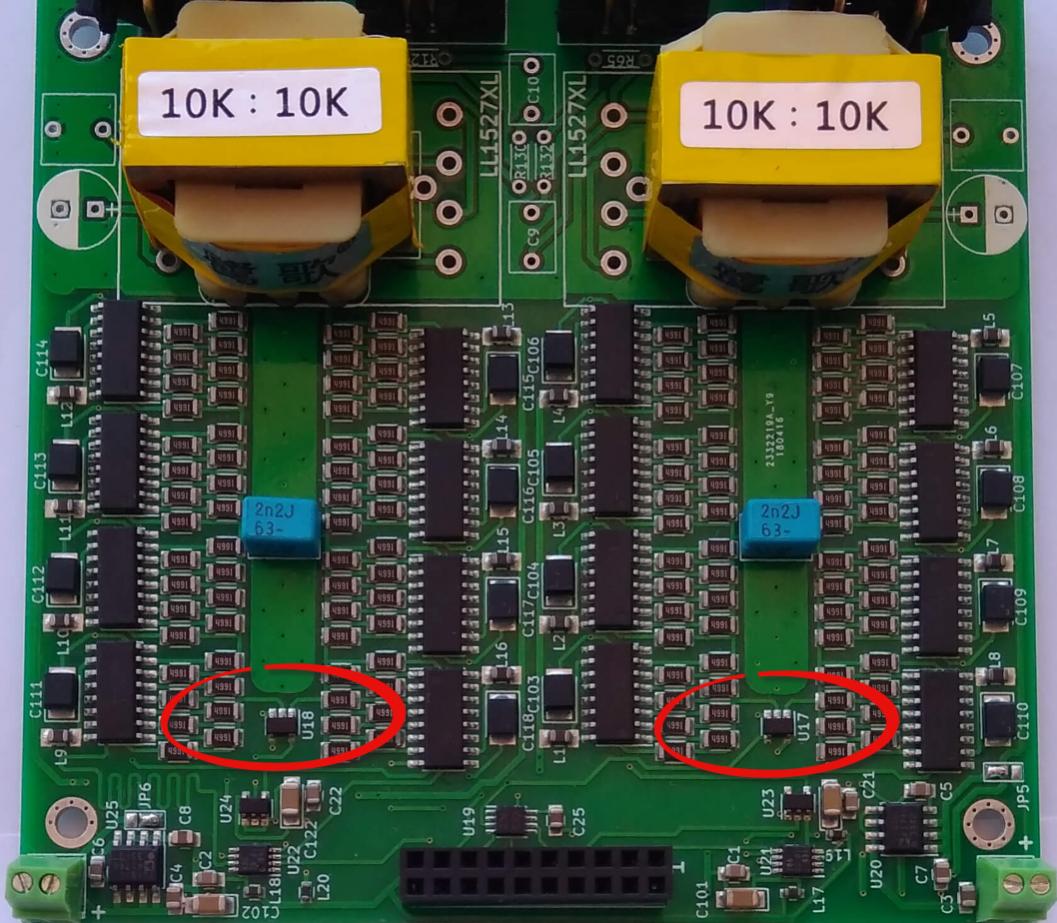

Wondering for guys who hand assembled the DSC2 cards, did you use a solder iron, solder paste and a hot air gun, solder paste and a controlled oven, or some other means?
I don't have a hot air gun. I'm trying to get the parts for an oven, but that may take a while. Could use this as an excuse to get a hot air gun lol.
I was looking at the pwb, and while I'm pretty sure I can hand solder, not sure if I want to spend that much time soldering.
Seems like using solder paste will be faster, but never tried it.
mine and ones i made for others was prepped with a stencil(and solder paste) and then reflown in a pid controlled oven.

Well for my DCS2, I partly did the job with solder paste and hot air and hand solder. I am a absolute novice (and an old shaky guy) dealing with solder paste and hot air gun, so I had to do a lot of error correcting on the assembled board after finishing it. I have a lot of experience in trouble shooting and measuring, so I was able to correct all of the solder defects I made, but it is not an easy job, if you have limited experience in soldering SMD or have limited experience in trouble shooting circuits.Wondering for guys who hand assembled the DSC2 cards, did you use a solder iron, solder paste and a hot air gun, solder paste and a controlled oven, or some other means?

I'm fortunate in having a friend with a reflow oven and he does an excellent job for me with more complex smd boards. I have also done some assembly with a hot air rework station.
With both an oven and a hot air station using a stencil to apply the solder paste facilitates a much better job and should avoid having to do remedial work because of solder bridges and the like. You can get reasonably priced solder stencils from PCB fabricators like JLCPCB.

I've done a fair amount of surface mount work, been able to solder some fine pitch ic's without bridges or other problems.
Most of the parts on the dsc2 don't look bad, its just there are a lot of them and really close together in some places.
I'm sure a stencil will help, but I think I going to cheap out and try it buy hand applying the paste. I watched a couple youtube videos and I think I can handle it. Maybe do the resistor boards first for "practice". Since this is a hobby, I can spend time on it but have a limited hobby budget.
The parts with the ground pads under the part would worry me, but I'm not planning to use them, will generate a really clean 5V using ultracaps instead.

Hi guys , quick question : If I am using the dac in rca output mode do I short the unused phase of the balanced output to ground
The reason I ask it that output seems very low compared to my dacs with opamp output stages.
Yes, you short the side of the transformer secondary to connected to the rca shield (return path) to ground.

ppy's build documentation has a section on connecting the output transformers, which includes schematics.
So + connected to rca hot and -ve and ground connected to ground?
Thanks NB , had a look but I am using the original (Chinese) DSC1 board and being a novice I can't figure out what to do. I am using the recommended 10K:10K Chinese transformers.
Yes.
