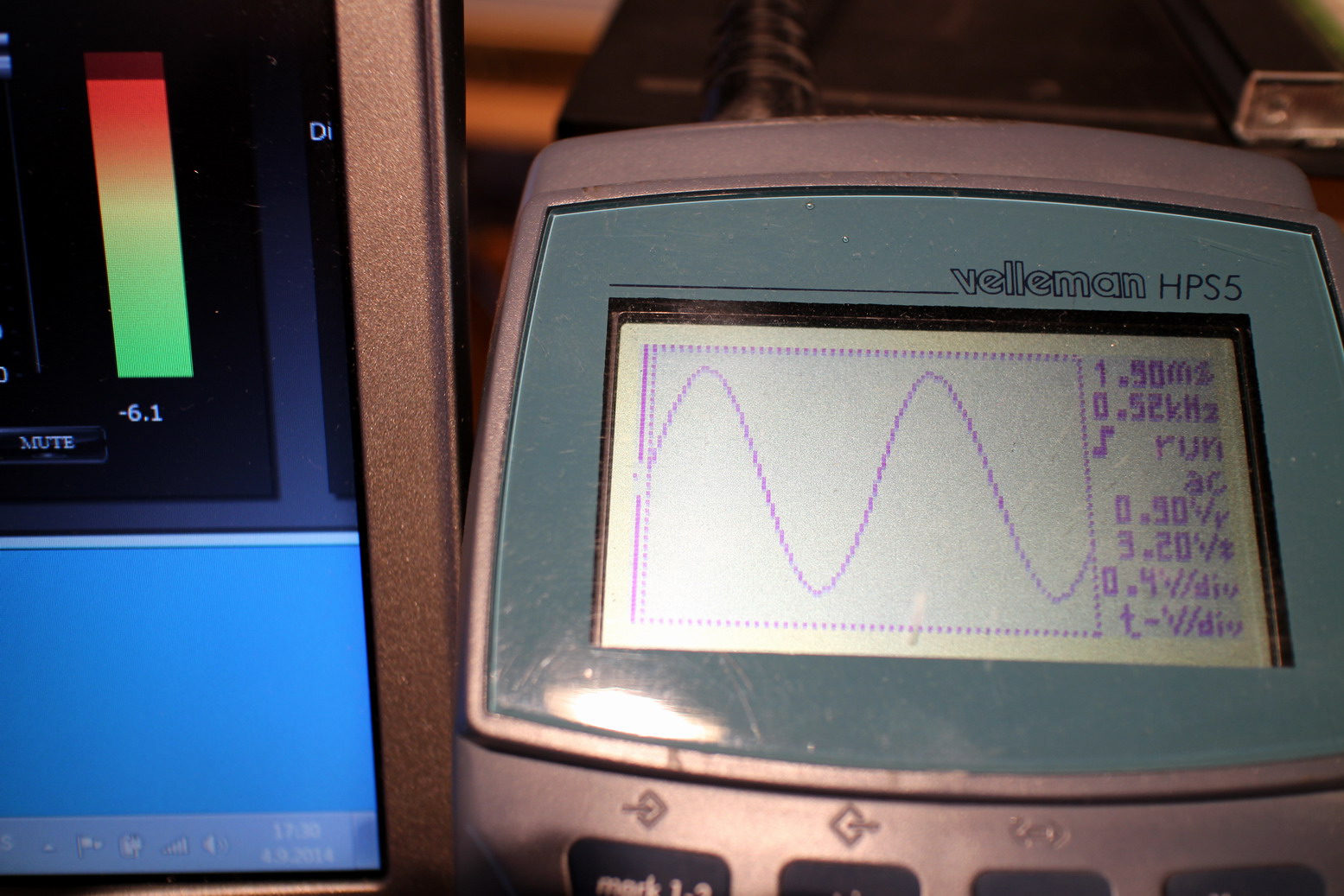

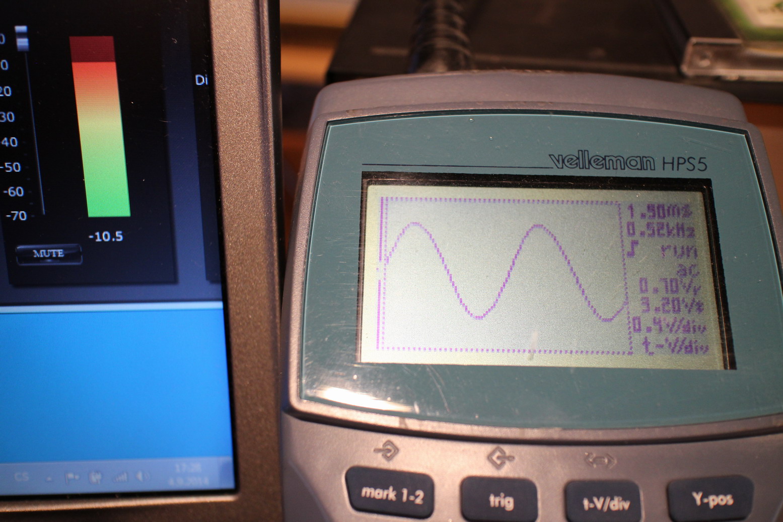

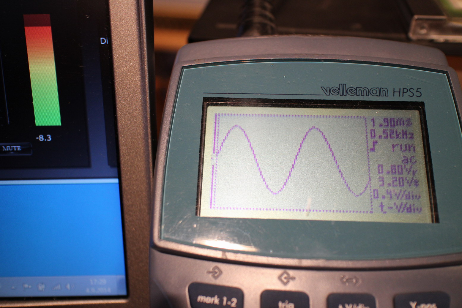

...and here are some screen pics

I don't think you're using the latest plugin that has the meter fix implemented.
When outputting sine signals at the clipping point the miniDSP meters will indicate "0".
If you reduce the voltage by half, they will indicate "-6", etc, etc.

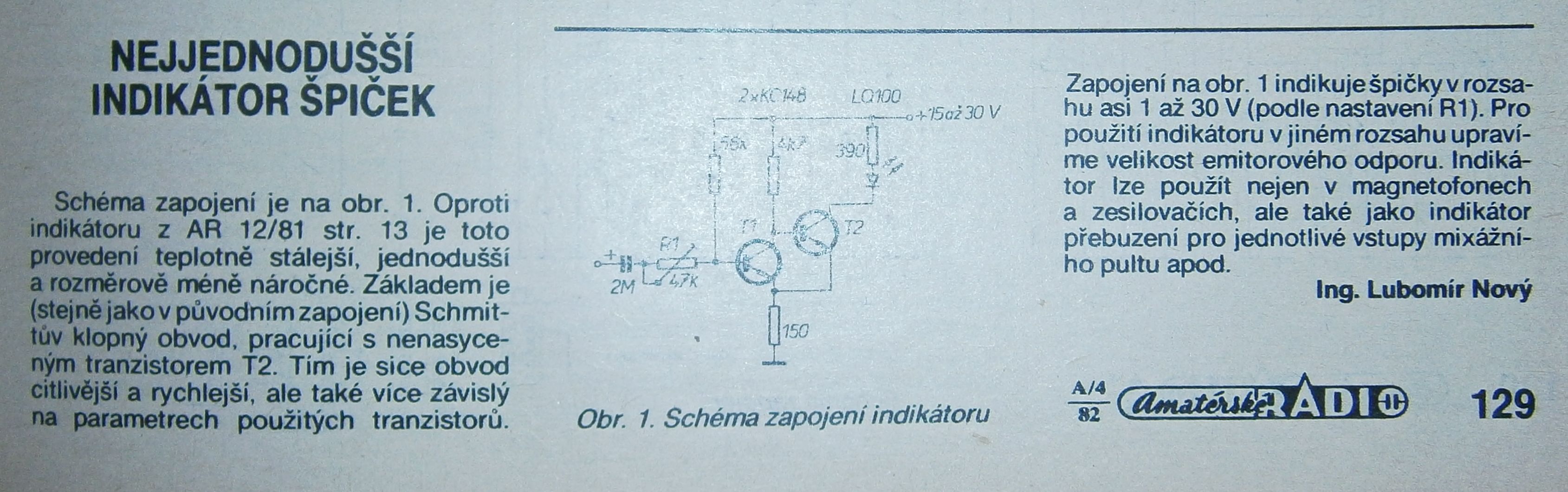

Just in case anyone is interested, i actually made few of these simple indicators, they are quite sensitive (depends on transistors used), appr. 300 mV with pot at 0, and the led flashes long enough to be noticed.
It makes tiny but noticeable pop, when it flashes, which is not good...or may be it is, since besides visual, it signals clipping even sonically.
Since new plug in, and the level indicators behaving just fine, plus volume pot at input, no clipping issue anymore, so i dot even need the clipping indicators.
They are fun to watch if you set the level just to hit the peaks...
