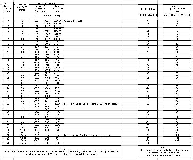

I start with the “Input Signal RMS meter.
Measurement set-up:
Signal Source Hameg Function Generator HM8030-3 (Rout:50 Ohm)
Sinusoidal Signal Frequency:1281 Hz.
Instrument for mVrms and db measurement : Keithley 175 True RMS Multimeter
Instrument for mVpp measurement and clipping monitoring: Hameg Oscilloscope HM203-7
DUT:
MiniUSB kit: 2xIn, 4xOut. It is the 2V Input version. (5 Vdc supplied through the USB port. Output loaded with 10kOhm).
Plug-in: MiniDSP 2 Way advanced (Release date 17/02/2011)
I applied the sinusoidal signal to Input 1. The path through the outputs is flat.
X-over and filters are bypassed. Zero attenuation on the gain sliders.
Input 1 and Output 1 are monitored for level and waveform clipping.
On the attachment you can see the results of the measurement.
Two thinks are of importance here:
A. The flat output starts clipping when the Input RMS meter of the plug-in SW reads anything above the “–6” reading. (the output RMS meter for flat settings reads the same as the input meter).
The sinusoidal signal amplitude corresponding to this clipping threshold is 2.228Vrms (or 6.118Vpp).
B. The law that governs the input RMS meter of the plug-in does not follow the db law of neither voltage nor power measurements.

Some more hours spent today on measurements, checking the operation of the input attenuation slider.
I connected the signal source at the input. Input signal was the 1281 Hz sinusoid held fixed at the clipping threshold of 2.228Vrms. Attenuation was accomplished by the Input slider from the plug-in software.
The db meter and the oscilloscope were connected at the flat Output 1 (which is loaded by 10kOhm).
Input RMS meter and Output RMS meter agree on their indications, when the path from input to output is flat.
Each step of the input (and output) attenuation slider corresponds to one db of attenuation. That’s good.
The not so good thing is that, for one db of attenuation through the slider , two are registered by the input (and output) “RMS” meter of the miniDSP !
Detailed measurements (Table 2) and some head-scratching , revealed the law that governs these “RMS” meters (see top of Table 3).

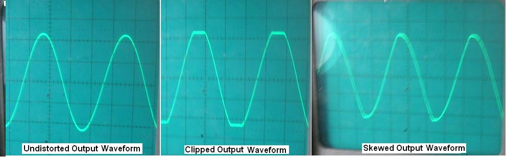

The Input attenuation slider is implemented in the digital domain, past the input, after the A/D conversion. So, when a signal applied at the input has an amplitude greater than the clipping threshold level, it overdrives (clips) the A/D converter.
Adjusting the input attenuator to a lower click, will not attenuate the analog input signal that would prohibit the A/D clipping. It will attenuate the digital clipped signal which will be further processed and furnished to the outputs in it’s clipped form.
If the signal applied to the input has a high amplitude but still below clipping level, it may clip during processing if excess boosting is applied through filters.
E.g. A signal 6db below the clipping level is applied to the input(remember, this signal will be read by the input meter as “-18”).
Then If a filter is added with a gain of anything more than 6db -or a succession of filters with total boosting greater than 6db- the digital signal will “clip”. This will manifest itself at the Output meter which will read above the “- 6”.
This clipping due to filter “overboosting” can be canceled by applying attenuation through the output slider. The amount of attenuation in db has to be equal to the excess gain applied by the filters.
This trick has a limit. This limit is 24db. If the excess gain is more than 24 db, the output attenuators are not able to render signal undistorted. In this case the output signal will not look clipped but bent and skewed, looking like a slew limited signal.
http://www.diyaudio.com/forums/attachment.php?attachmentid=332122&stc=1&d=1361568128

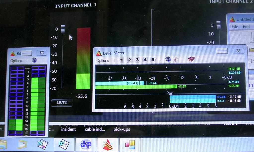

Strange behavior indeed. But this made me look at the ADAU1701 data sheet http://www.analog.com/static/imported-files/data_sheets/ADAU1701.pdf which verified this 24db overhead.
Now things became clear to me. The internal flow is as follows.
1. Analogue signal entry.
2. A/D converter.
3. Input attenuator.
4. Pre-filter bank.
5. X-over filter bank.
6. Post-filter bank.
7. Output attenuator.
8. D/A converter.
9. Reconstruction filter.
10. Analogue signal exit.
Everything between A/D converter output and D/A converter Input (digital domain) gets an +24db max overhead, while the A/D and D/A operate on 0db max level. The RMS meters monitor each A/D digital output and each D/A digital input respectively (there are 2 A/D and 4 D/A converters). I repeat here that this “0db max level” is the “-6” reading of the RMS meters.
For the limited case of steady state input signal, all one has to do to ensure “overload free” operation, is to observe both input and output meters not to exceed the “- 6” reading. ( Warning. This does not cover the case of filter boost above the 24db).
The sad truth is that the x-over kit will never work with steady state signals when installed in an audio system. Music signal is dynamic.
The meters are not true peak meters, not even quasi peak meters. They are db FS (digital Fulll Scale) monitors, albeit with a peculiar calibration and an unspecified -but certainly long, close to VU meter -response time .
http://www.diyaudio.com/forums/attachment.php?attachmentid=332123&stc=1&d=1361568128
Thus , I am inclined to treat them as db FS monitors with VU meter ballistics, which means that for monitoring already processed speech and music signal, I should adjust for 14db -18db below the 0db level. This corresponds to max observed meter indications of “–34” to “ –42”.
Too low a level you will object. Not so.
Standard practice dictates a maximum of -20db level for VU meters (that would be a max “-46” reading with these meters).
In fact, the reason that I started this search was that, while listening to music (ok, on classic and opera recordings) I heard the sound to become harsh and bottomed when these meters were “peaking” occasionally at –24 –26. This has been shown now to be 9-10db below digital clipping.
“Harsh and bottomed” means a lot of distortion already.

To summarize the important points without going into difficult technical details:
1. Each input meter monitors the output of the respective A/D output.
2. Each output meter monitors the input of the respective D/A output.
3. The clipping threshold corresponds to a reading of “- 6” on miniDSP meters.
4. The numerical reading of these meters does not correspond to db values.
5. These meters are not peak meters, their indications do not fluctuate that fast to follow the peak envelope of the music signal. The output of the source that drives these miniDSP kits should be adjusted so as the meters show much lower values than the clipping limit of “- 6”.
How low, depends on the recordings:
I would suggest for heavily compressed music, the input meter long term indication reach not higher than “- 26” (10db headroom).
For uncompressed contemporary music not higher than “-42” (18db headroom).
For demanding recordings (jazz, classic and opera fall in this category) not higher than “-54” (24db headroom).
For live unprocessed takes, “-66” reading (30db headroom) may be high. Watch for lower settings.
6. The total boost of frequency bands through filters, better not exceed 24db.
No 1 and 2 are not problems. They implement proper decisions from the SW designers. But they have to be explained in the technical documentation in order to inform users. Ditto for No 6.
No 3 and 4 are real problems. As an interim action, they should have been addressed ASAP with bold letters in the technical documentation. They’d better be corrected in the next revision of the plug-ins.
Last, No 5 is a technical decision but IMHO a questionable one for this application.
These meters should be treated as an aid in establishing proper gain settings by the user.
VU meter types need knowledge and experience (not assumed to be had by a typical user) for to be used properly.
A choice of Peak type meters would be more appropriate there.
A compromise could be reached by retaining the chosen meters and adding a peak “led” indicator for each meter. But I thing that this “compromise” will require more computational resources than designing for Peak meters (with some hold-up time) straight on.

I think the problem here George as Curryman has alluded to is that the data transfer between the board and the software isn't fast enough to keep up with the peaks. And the peak hold would have to be done in the software.
The meters themselves whilst being more or less useless for music signals are, apart from reading 2db for every 1db change to the attenuators reasonably accurate for steady state signals.
So I just run the input attenuators at 0db and have adjusted the analog input level to the board so the meters read -9.3db for a 1khz 0db down (ie. flat out) signal off a test CD. As CD is my loudest analog source (only by a couple of db) this works out fine.
I don't apply any eq boost at all (just cut if needed) so this works fine and the 3.3db gives just a bit of extra headroom for safety.
For a typical loud "pop" track the input meters read just into the high 20's.
Obviously if your were applying large amounts of boost via eq you would have to take this into account and reduce the signal to the board by a similiar amount.

The question I would like to throw at you and others is the following: your measurements show how important it is to get the gain structure right. Too much input level and it starts to clip, and too little ... what then? The lower the signal, the lesser bits will be used in the AD-DA conversions. Since I run these prototypes from an analog signal with volume control, I must have listened to music coded with 8 bits or even less. The remarkeable thing is that this does not seem to degrade the sound quality perceptually that much. In other words, I would argue to stay on the safe side, and allow for more headroom than you instinctively would. Am I out on a limb here?
For a typical compressed material :D, you are marginally OK.

Apart from input level scaling, input anti-aliasing filtering and output low pass filtering, everything else is done in software.
