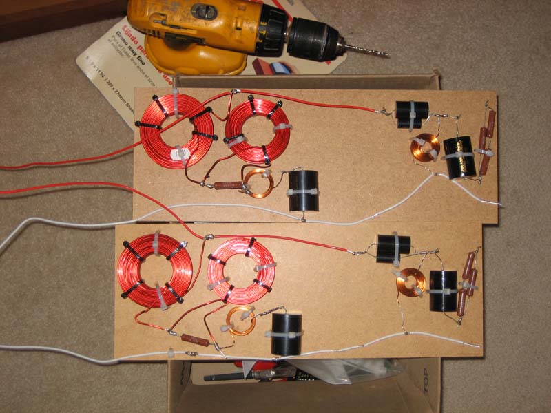

I'm almost done finishing the cabs, then I have to do the xovers. I've been out of work for some time, so I've been able to devote a lot of time to the project, but I only bought one tweeter and one woofer, to get dimensions from. I'll have to wait until I get a job to get the rest of the drivers, but they'll be all ready when I do!

That's how I built mine too. Still it's a PITA to have the Xo's inside. Experience speaking.
Ron
I also prefer to have the Xovers outside the cabinet.
I never put them inside anymore (although my Thors are now 3 years old) -- the XO is always getting tweaked.

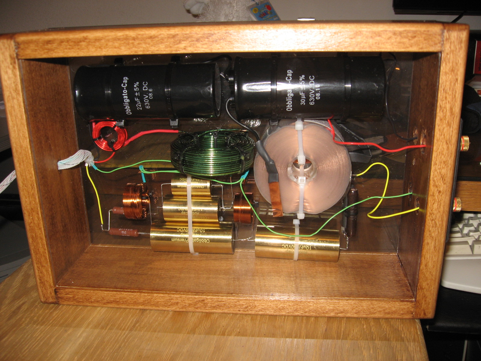

I finally got the xovers soldered up:

Mattmd,
Just something I saw on your Xover layout, you might want to stand one of those large coils (inductors)vertically, they could effect each other in a negative way otherwise.
If you look at the picture of my Xovers above, you'll see the green one standing proud.

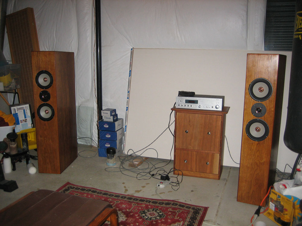

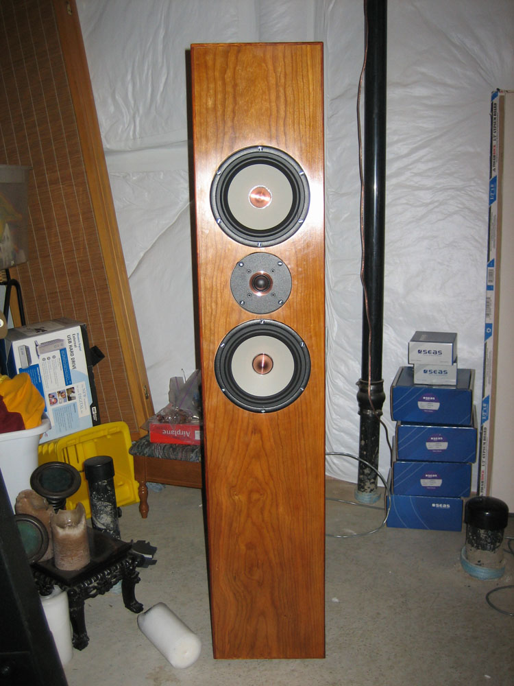

Here are some pics. I built the speakers before the listening room, so pardon the surroundings.
Damn fine job! How do they sound in your system. I bet they are grand
Hint: use plaster instead of sheet rock.
