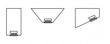

Now, I am confused about the shape of the array.
I came up with 3 designs, wondering which would be better for an array that will be placed close to the back wall.
I'm guessing the one on the right.

Middle option
Hiya,
I would go for the middle design, best acoustically for wall mounting and most flexible for re-sale later.

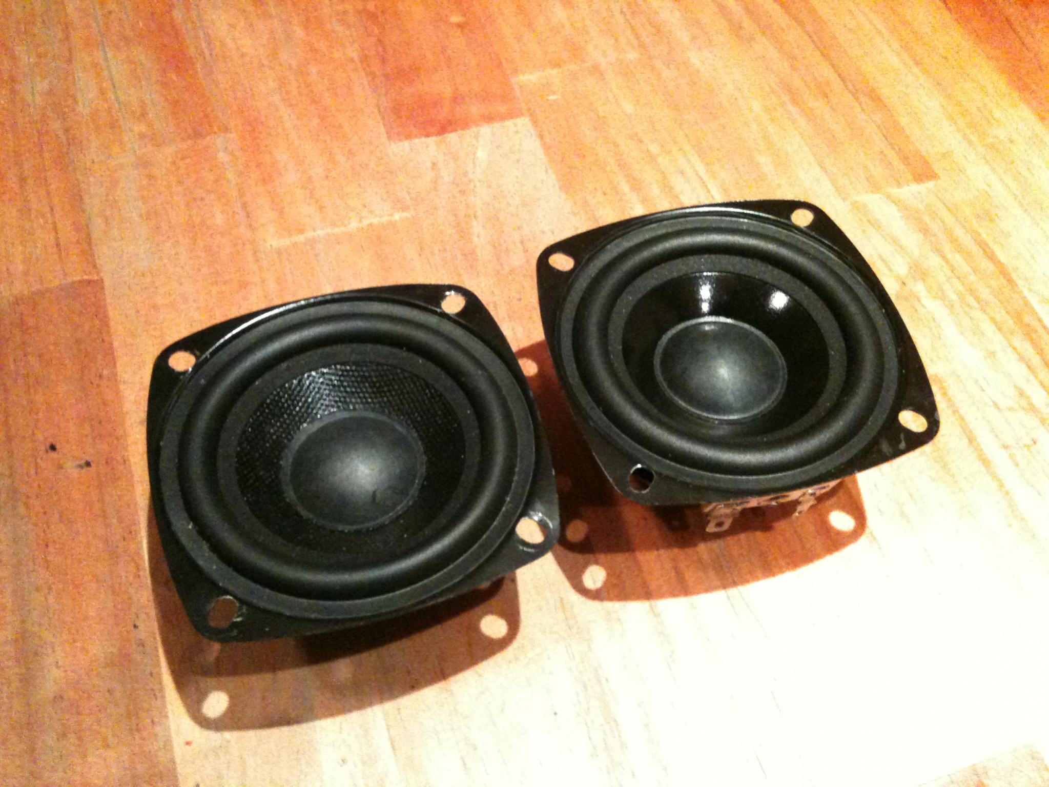

Thing is.... this driver is better! I put it in a test enclosure, and it responds a lot better to EQ tweaking... especially on the lower end. The curves are pretty good, and adding EQ makes it even better. Off-axis is very good as well.
I may have found a sweet little driver. Since it sounds so good, I think I will go back to 25-driver towers.
The only problem is that the mounting plate is very small, not much play around the basket, so it will be a pain to fit on a baffle. I thought of going with a plywood baffle made from 2 plys of thinner plywood, but I think it will be difficult!
Here's the new driver (on the right side) next to the original one. The original one had a fiberglass cone, this new one looks like a polymer cone.

Construction and stiffness of the surrounds feel the same, but it handles a bit better than the fiberglass one. The fiberglass cone sounded a bit muffled on the high end of the spectrum. This polymer cone has the crispness of the $20 paper cone driver, with the better low end of the fiberglass.

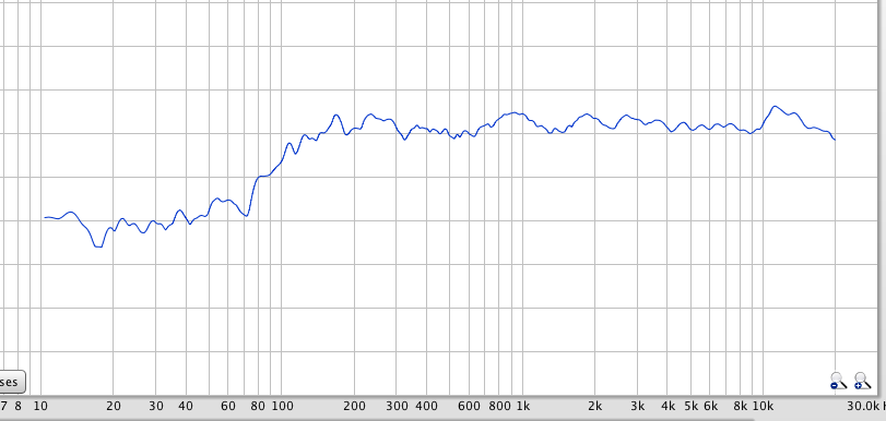

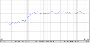

Here's the curve I got from one driver:
