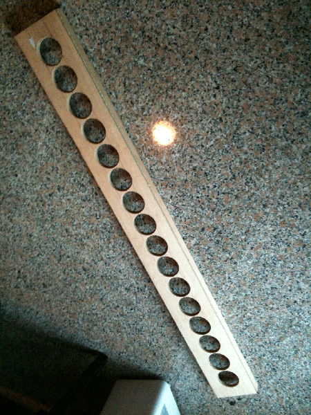

Hmmm... I had a go at it today. Made a template from a sheet of plexiglass and did a test cut to make sure it was ok. It went fine. So, I moved to the actual baffle, and on my very first hole, the router jumped a little and gauged my template... and the hole.
I stopped before starting a mess of things and will continue tomorrow... or later!

Looked at my router, it's a smaller one.
The base screws go directly into plastic, so I didn't try to mount it upside down on a table with screws in plastic. Didn't feel to confident.
But, what did help is the suggestion to cut as much material ahead of routing.
See, at first, I figured that since a router is a "super" tool with a bit spinning really fast it could eat through anything, one layer at a time if need be.
But, I followed your advice and used the jigsaw to cut away most material before engaging the router. That did it! It was so easy to follow the template and it went pretty well (some little mistakes here and there, but nothing major that sanding won't resolve).
So, I finished all 32 holes now. Not planning another set of towers anytime soon... That's a lot of holes!

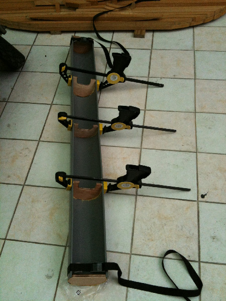

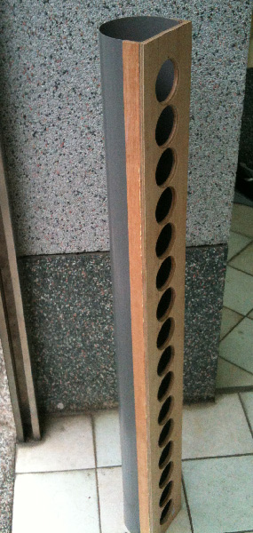

Baffles are coming along.
I mentioned I was going to change the design a bit.
I found some circular PVC pipes and decided I was going to use that. Only fools never change their minds, they say!
So, I glued up some "wings" on the baffles to be able to mount the cylinder behind. The wings will help to support the sides. I will also round the side edges later.

Net volume of a column is 0.9 cu.ft, or about 25 liters.
That's about 0.06 cu.ft (1.6 l) per driver. Not as big as I initially expected to go, but this is what it comes up to when using the tube I found.
