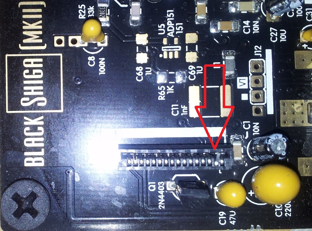

Where the red arrow to point is that the plus (+) side?
I would like a confirmation because I make my own black and red cable.

Yes, exactly, your arrow indicate +8V and is also marked near on J6.
With a multimeter you can easily check that other pin is ground by testing continuity with LA6541 heatsink.
On Shiga MKII LA6541 do not require a heatsink. You do not need to put one as LA6541 will dissipate in the double ground plane we have calculated and designed.

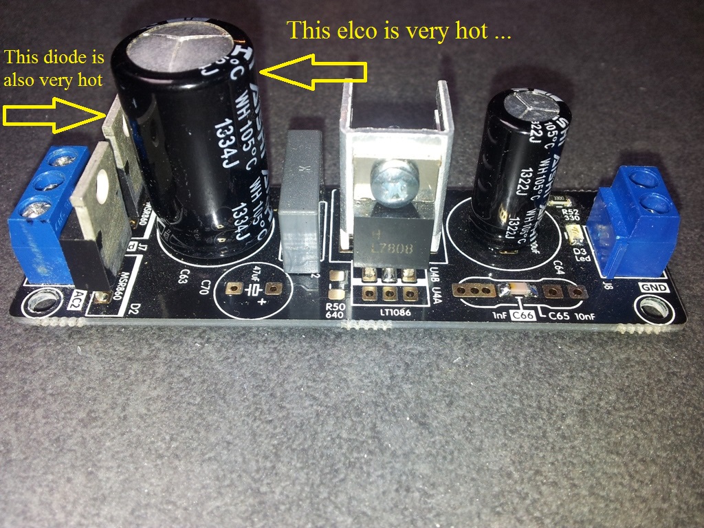

I always test first the power supply if there are 8 volt comes out and yes I measuring 8 volt
But the diode (MSR860) and the capacitor is way too hot.
Please tell me what piece is defect?

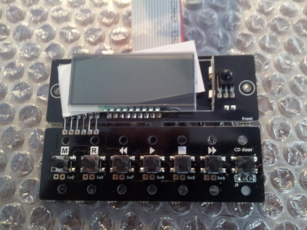

When careful unpacking I noticed that the display falling apart, see picture …
Also the board connector looks defect, where the ribbon cable of the laser comes in, this can never have worked see picture …
Tibi please tell me wat to do, must I sent the whole unit back?

Hi Rudy,
Yes, please send it back. In the mean time I'll ship another unit to you.
