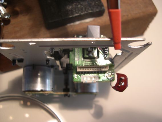

silver micas go to pin amp and trimmer, vishay goes to laser and Vref. pls correct me if im wrong but that's how i would use it.
Hi, Tubo
I just know three caps.
Bottom caps - 100nf and 1000pf
Top cap - 100nf
Where did the another cap go, or i miss somewhere else?
Regards
Clarence
Hi, Tubo
Top cap - 100nf
Regards
Clarence
One silver-mica 1nF across monitor PIN potentiometer.
Tibi
Tibi
Hi, Tibi
This is the one?
Regards
Clarence
