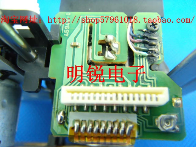

Today I did another test...actually the Siemens against the Vishay again.
The winner (Siemens with Siver Mica on board) has to battle a more equal situation now.....the Vishay with ALSO the Silver Mica on board.
I deliberately did not modify a laserhead with all four modifications in order to get a better understanding of each modification individual and of their synergy with others.
.............and yessss the Vishay played himself on top again...
This listeningtest gave me two anwers first of all that the Siver Mica is truly a nice upgrade and second that the Vishay is the better cap.....and that the synergy rocks....
No careful....I have a 100nF Vishay in our very first modification position (as Tibi suggested) and a 1nF silver Mica as bypass on the trimmer.
So far these two mods are staying...
The platform itself is ready for ditching because it skips very often....
I am normally not familiar with this phenomen since I mount new puck combo straight away but the failure rate of plaforms is seriously high.....
Nope just these two...
As a matter of fact I just ditched the laserplatform after removing the two ways modified laserhead.
I mounted the two ways modified laserhead on a " proven to be accurate" platform and voila better TOC reading and no more skipping.
A pity you have to take this parameter (faulty platforms) into the equation.....

After a complaint from Nbivol and Robert about skipping and poor TOC reading after implying the modification I tested this morning again on stability.
I discovered that I tested in the recent past with only two cds.
So after feeding my lasers (three modified ) a decent amount of cds indeed there was a modified laser which was having trouble reading TOC......again it was the 100nF Vishay even after swapping platforms (again).
So no problems (even superb) reading with the 47nF Siemens and 68nF Vishay.
It does not make sense to me but I report it anyway......maybe coincidence...
(I am talking about the very first modification)
As soon as my 100nF Vishays come in I will plug it in the socket of one of my modified and proper working laserheads and I will know for sure that the 100nF Vishay can present a problem in some cases.

I found this on buychinatao website states it is CEC CD SFP101-16P NO XR5 will this work, there are several versions on site (3) . SteveAn externally hosted image should be here but it was not working when we last tested it.
The X5R beast is right on the left side.
I think Dimitrios have a similar mechanic.
Tibi
