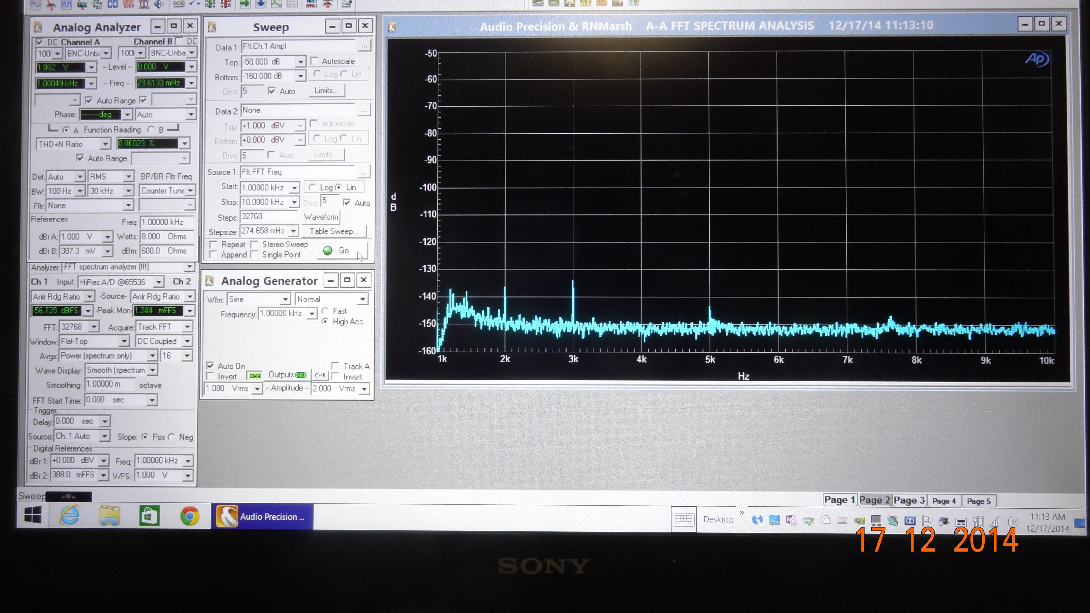

The osc section is quite good-- as I showed in a loop thru test a few lines back. Here it is on the AP-2722:

Trying to measure distortion of an MDAC multiplier is an interesting endeavor.
The clacking of the mos switches do a real number on a TT active filter. All sorts of noise lobes are created. At the valley of the lobe nodes is the true distortion. But the noise is not representative of what's actually output from the Mdac IV convertor.
The multiplier core for my generator attenuates the Mdac output by 10:1 and the output of the multiplier is decoupled from the oscillator by 20dB. The Mdac sees 40dB of attenuation to the oscillator core.

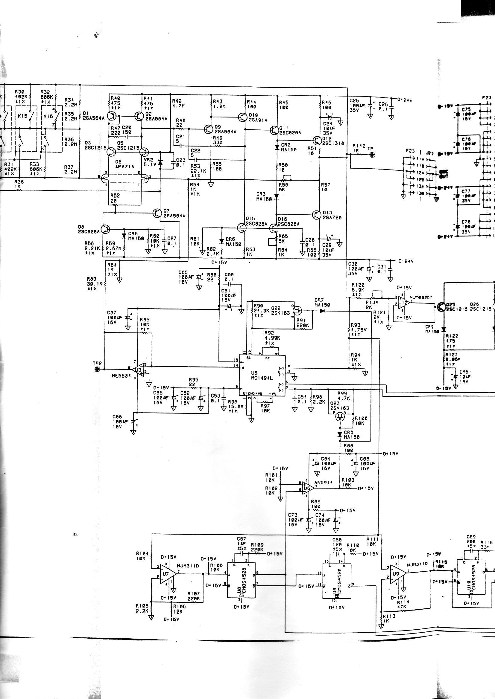

Does anyone know --- the Matsushita (Panasonic) has its monitor output coming from an 8 bit DAC.... does the ShibaSoku do the same?
8 bits limits the dynamic range of that port..... so I guess I wont attempt to lower it if that is the limiting source.
THx-RNMarsh
THx-RNMarsh
The ADC in the Shibasoku 725C takes it's input from a gain of 2 buffer which is driven from the final high gain stage.
The monitor port is decoupled from the gain of 2 buffer by an 2:1 2k2 resistor attenuator.
The meter input circuit is taken from the final high gain stage before the gain of 2 buffer amp.
This arrangement improves the SNR of the normal monitor port.

The normal monitor port is pure analog. It's a normal distortion analyzer.
The analysis monitor output port is off the filters for the analysis. These filters are connected to the DAC. The filters remove the DAC noise, limit the band width to the first 10 harmonics and select the individual harmonics. There is also high pass filter to remove power supply hum and noise. The ADC/DAC are included only to perform the noise reduction and fix the output reconstruction frequency to 488Hz. This simplifies the band pass filters because they can be a fixed frequency. No tuning required for all input frequencies from the DAC.
The Panasonic seems to be built on the same concept as the Shibasoku 725 but simpler.
It appears to be scaled down. If the Panasonic doesn't have a monitor port for the analyzer section, I'll bet you can add one in.

I have done some mods david wrote on my 725C which I got recently.
Thank you david and thank you demian kindly provide me a 725B manual and schematic.
I was able to draw DC out from data out connector referring the manual.
Replaced A3 QA2 and A4 QA5 to LM4562, yes it is dual opamp, because I don't have suitable single opamp in stock.
Rest one circuit is set to voltage follower and + input is tied to GND.
A7 mod done, by isolating edge finger with polyimide tape instead of cutting trace so that let it restorable.
I did not do other mods of opamps, resistors and A2 but got reasonable result, about -120dB THD+N at 1kHz BW30kHz .
At 10kHz input, 2nd HD is greatly reduced.At 20kHz, residual noise is far larger than 10kHz because frequency range of BEF transitions at 16kHz thus not significant improvement is gained.
I also tried to replace A3 QA1 to singled LM4562 to reduce residual noise further.
I expected replacing it may affect amplitude response upper notch frequency.
The amplitude response did not differ by the mod ,but the opamp weakly oscillate when inputting some specific frequencies such as 997Hz .I don't know why!oh no.
The oscillation occurs after top and bottom portions of swing.
I restored back HA2565 but will try again because A3 QA1 and A4 QA5 affect largely residual noise.
Next I will try to control AG16A with GPIB from PC via arduino and read DC out or VF out from 725C.
My 725C equips optional steep 20k LPF but sometimes got odd result when measuring distortion on delta sigma DAC even with that LPF.
It seemed clipping somewhere in the signal path.
I confirmed the LPF is inserted between A5 and A6 boards so it must be clipping at A4 QA5 x10 amp.
Routing the LPF before A4 or A1 will solve the problem sacrificing residual noise...
