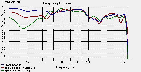

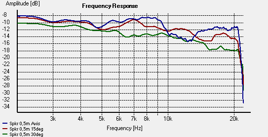

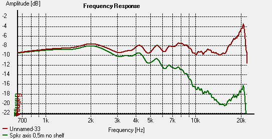

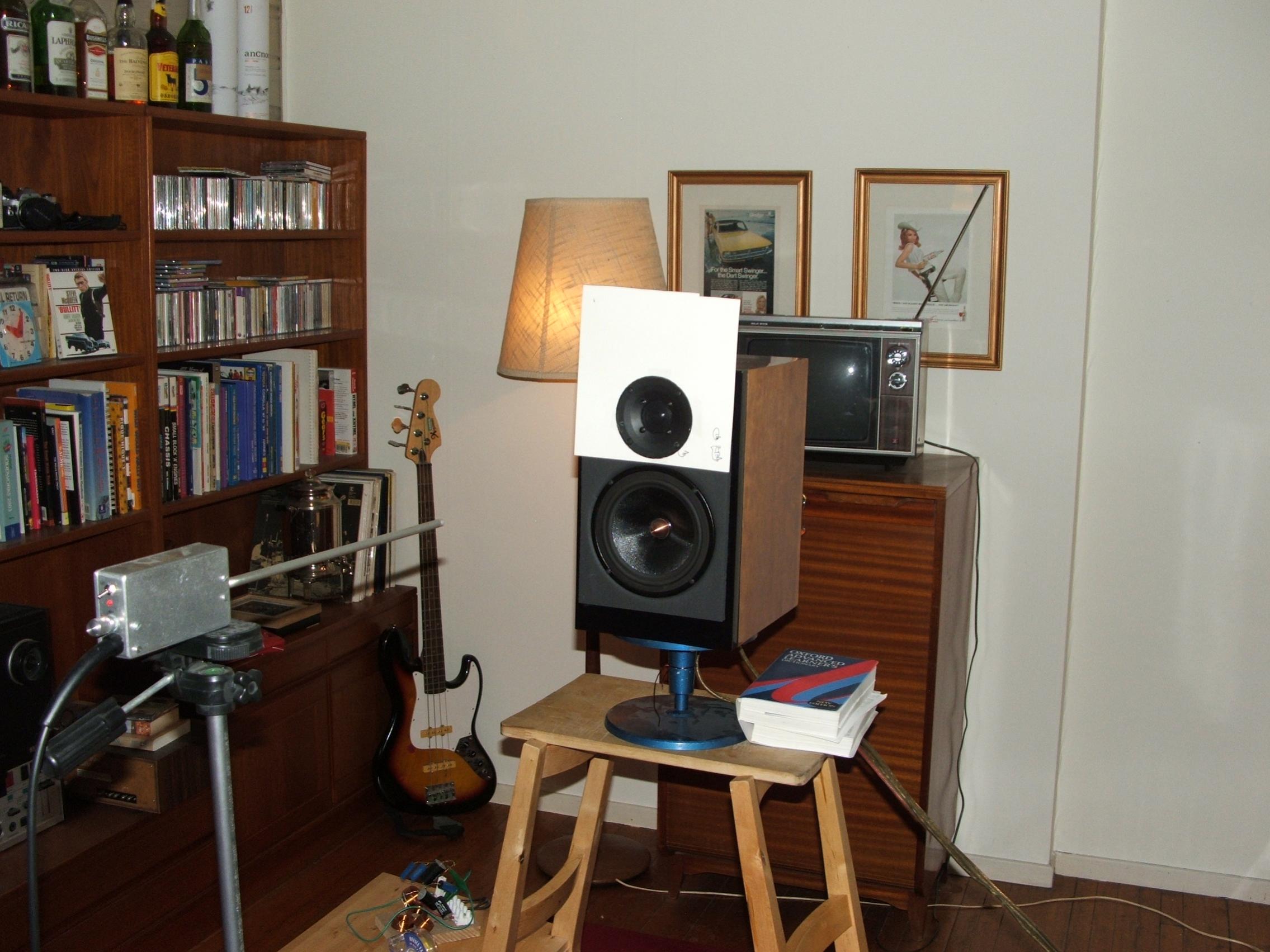

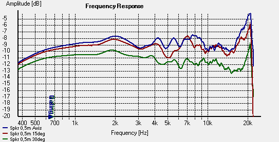

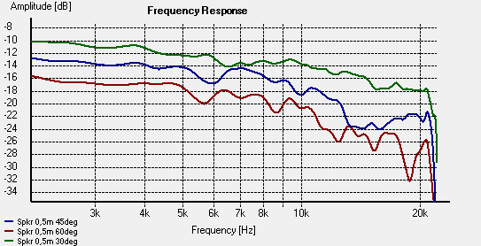

I decided that it could be interresting to investigate the "nature" of the tweeter response further with the aim to see if the anomality, in particular that 13k dip was only the result of a particular measurement (mic position) or if it is a problem consistently present throughout the sound-field.
I therefore did a series of off-axis measurements and some vertical ones.
All the horizontal off-axs measurements were made with the mic pointing between the woofer and the tweeter.
The measurements are allso done with the current HP shelf in place.
The turn-table I use doesn't allow me to have the axis of rotation coincide with the plane of the baffle, so as the loudspeaker was rotated, the microphone didn't point directly at the acoustic centre of the speaker any more. But for relative measurements, I assume this is OK.
As I can only display 3 measurements at a the time in Holm Impulse, I have split the measurements in to twoo images.
The first shows 0, 15, and 30 degrees, the second shows 30, 45, and 60 degrees
It should be obvious which curve is which.
The last image is on Horizontal axis, but with the mic pointing between woofer and tweeter (blue), on tweeter axis (red), upper edge of speaker (green)
The vertical measurements doesn't show that much change, but they were only made over a limited range. Having said that, the measurement with the mic pointing towards the uper edge of the box seems to have a more even level.
Looking at all thes measurements under one, it seems to me that there is no consistent peak or dip throughout the horizontal plane that can or should be targeted with a trick filter, and that on average the best thing to do would be to simply increase the shelving High pass gain 2-3 dB more.
What do you think?

What you are seeing is most likely diffraction, I believe. The position at which you have mounted the tweeter is close to being equidestant from the top edge and the sides of the cabinet, which encourages these types of problems. Even worse, your "foam" sheet with the drivers screwed on to them (to eliminate routing as you say) seems to have created a "ringed depression" around the tweeter flange which looks to be about 5-7mm deep, judging by the picture. If so, this is bad news. Even though it is not a sharp edge, you can probably still get diffraction off of this surface or reflections back in to the horn.
Here's how you can diagnose these problems:
1. Remove the tweeter from the speaker cabinet but keep it connected (or reconnect it via some extra lengths of wire) to the crossover.
2. Find a large piece of cardboard, e.g. at least 0.5m x 0.5m, the bigger the better.
3. Cut a hole in the cardboard and "mount" the tweeter in it (not yet flush mounted).
4. Take frequency response measurements of this, on axis (and off axis if you would like).
5. Now "flush mount" the tweeter. Find some solid material (like more cardboard, but not foam or felt) that is the same thickness as the tweeter flange. You want to use it to create a "flush like" surface around the tweeter flange. You could use the first piece of cardboard, and then you just need a small piece to mount the tweeter on and stick it on the back of the first piece so that the flange is flush with the large surface.
6. Now remeasure.
This will give you an idea of what the tweeter response is like without cabinet diffraction. The cardboard is plenty stiff and large for a tweeter's pressure wave to be essentially an infinite plane, e.g. 2PI space. Since the crossover is still connected, you can be assured that you are still measuring its effect.
The difference between what you measure when the tweeter is flush mounted in the large cardboard, and what you have measured in your speaker, is the diffraction signature. You may find that this is the source of your problem. If that's true, you can cut the cardboard down to a size that is the same as the front of the speaker, with the tweeter positioned in the same location but now flush mounted in the cardboard, to see what you will get if you change the mounting to true flush mounting in the cabinet.
Hopefully that will shed some light on how to possibly fix your response issue. If not, post the results and we can look for other problems. Luckily you have a good measurement system, so you can discover and diagnose these issues!
-Charlie
P.S. Here's Mark K's 2-way using the DXT tweeter, with a similar mounting position:
http://www.audioheuristics.org/projects_gallery/ER18DXT/ER18DXT.htm
The tweeter is flush mounted. Since there is no major diffraction signature from his baffle, I am thinking that the "ring" in the foam around the tweeter may be the culprit in your case...

Charlie,
A very interresting reply there..
Just as a quick check, I attached some old printed circuit boards (without components), on each side of the tweeter to se if that made any difference.. very little.. I allso placed a thick book on top of the speaker to simulate an upwards extension of the baffle, neglible effect..
But your comment about the depression in the foam creating a possible unintended difraction feature, perhaps like the difraction ridges in the actuall wave-guide, is very interresting..
A bit of a hassle to remove the tweeter with soldered leads and everything, but I could allways try and stick on a piece of cardboard with a cutout just fitting the tweeter, that should at least give some sort of indication..
Now to find some cardboard...

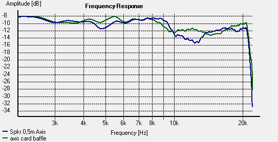

Charlie,
Hats off to you!
I found some cardboard.. did a precise cut and attached it with tape..
I guess the graph says it all.. blue is the original measurement, green is with the cardboard..
I must admit that I'm surprised that that depression had such an effect!
As it looks like now, All I need to do is to bump the shelving filter gain up about 3 dB.
But.. what the £$€$@€!! am I going to do about that groove!?
The foam is glued quite firmly to the baffle, and even with that gone, routing would be impossible as The holes have allready been cut in the baffle..

Well,
As I had nothing to loose, I took a sharp hobby-knife to the foam and made a cut arround the tweeter.
As the foam has been compressed by the tweeter flange for some time, it remains to see if it will swell back and give a proper flush against the tweeter.
There was some initial "swell-back" after I cut, and that alone was enough to improve the 13k notch by about 1 dB.
If the foam doesn't recover, I could allways get some new foam sheets and make a similar cut before screwing the tweeters home flush propperly.
It will be interresting to see what happens over night..

Glad I was able to get you going in the right direction.
-Charlie
You certainly did Charlie, I seriouslu doubt that I would have identified that issue my self!
Doesn't look like that foam is recovering properly, so I'll change the foam for new and "countersink" with the knife.
A bit of a hassle, but considering the very good frequency response obtained aside from this problem, it would be a shame to let that one anomality ruin it all.

I'm really starting to think that the 15-20k peak is perhaps more of an issue than I first assumed...
Looking at the frequency plots, what sort of filter/ slope would be best suited to attack this peak without messing things up further down?
I have so far assumed that a flat frequency response is the ideal, and disregarding the HF peak, I feel I have come close to this.
Having said that, I feel that some body and presence is perhaps lacking a bit.
Could this again be a consequence of the HF peak, or should I perhaps reconsider the balance of the overall frequency response?
Now, I'm not after "EQ'ing" my records through my loudspeakers, but something that will give a realistic and satisfying sound reproduction in my domestic listening environment.

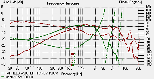

Bob,
Your comment on woofer break-up modes is interresting.
Looking at the SEAS data sheet http://www.seas.no/images/stories/vintage/pdfdataheet/e002.pdf, the W17cy doesn't seem to be horrendous in that respect, but I might well have underestimated the possible issue with this.
Enclosed, you see a plot with the raw response of the woofer taken from 190cm (did this last year in a warehouse at work so I could get some distance from adjacent surfaces), and a measurement with 3200 Hz x.over and BSC taken at 50 cm in my living room.
I thought this looked relatively OK with only a modest peak around 5 k noticeable.
I added phase response in the plot, hope this doesn't clutter things up too much!
My idea was to divide the midwoofer as high as possible without off-axis problems or breakup so as to move the x-over region outside the critical 200-2000 Hz area where the ear is most sensitive and uses time differences to locates sources. I had hoped that 24 dB /Oct filtering would allow me to push the x-over point higher than what would be OK with a more conventional 12 dB/Oct filter.
This was of course only an idea, and I might well have missed something.
Regarding reverse polarity Notch, it sounds very sensible to have matched phase in the crossover region. The linkwitz board I'm using for the filter has a configuration for an "allpass" filter for modifying phase, so this is perhaps something I should investigate closer...(but then I won't have any op-amp left for filtering out the 15k peak)
But first things first.. does the filtered woofer response look usable, or am I way off here??

That breakup peak is only 24 db down - It's nowhere near as bad as some but still quite audible. It also makes your effective slope on the woofer only ~2nd order. If you were to notch it down ~13 dB you'd have a 4th order slope. I'd still take it a little deeper, but that's me who likes quasi 8th order elliptical filters.
Notice how Seas' off axis response is seriously beaming by 2K? I think the "keep the XO out of the 200-2,000 area came from the prevalence of improperly implemented crossovers mucking things up in the dark ages before we understood the importance of power response. You're going to properly implement this XO. Head down to 1,500 Hz or so. Linkwitz did it with the Orions and it worked out quite well by most accounts.
