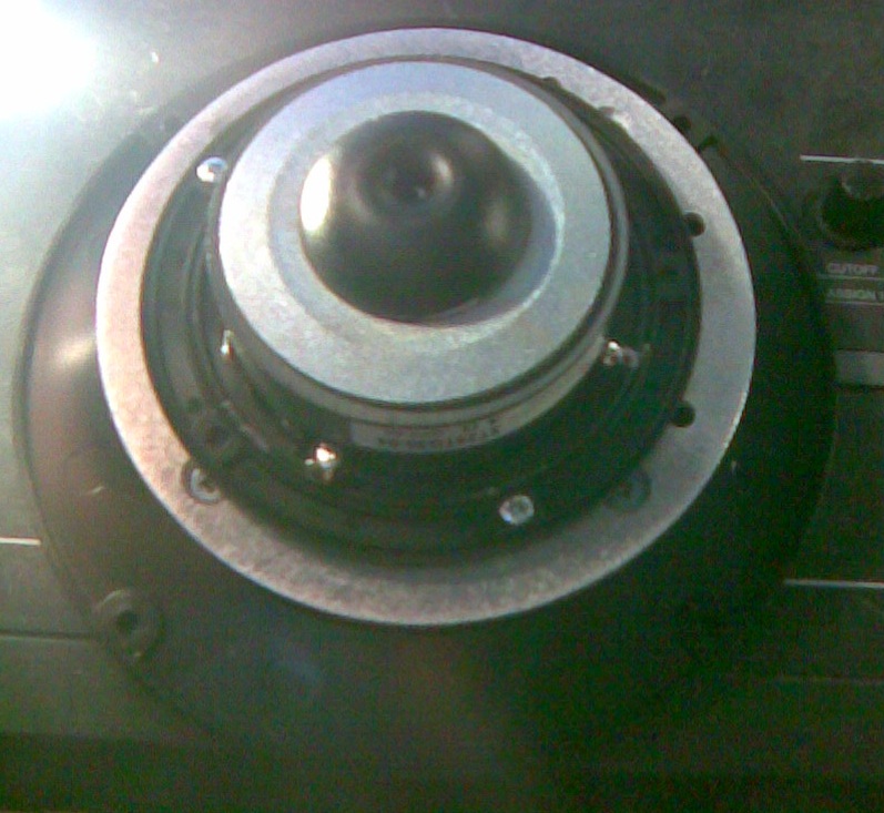

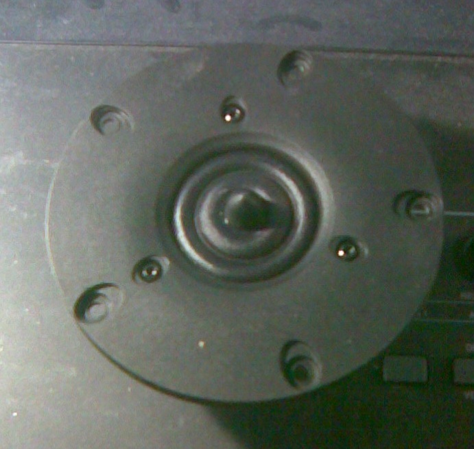

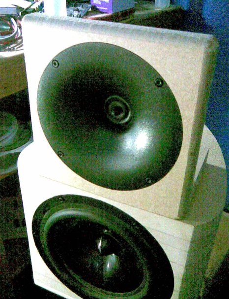

As it stands the WG300 arrived earlier on today, so I'm going to go play some! The WG by the way is about 16.5cms in diameter so just a bit larger then a W15 and almost perfect in size to mate with a 6.5" driver - makes that damned accuton look even more attractive.
With regards to removing the XT25s faceplate, it doesn't look like this is necessary, although it would probably mate up particularly well if done this way too.
A few hours later and we have some success. The pictures are of bloody awful quality as the three digital cameras we've got are currently elsewhere >.< I had to make do with the camera built into a mobile phone, pfft.

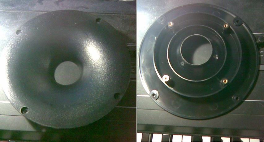

The WG300 is actually very easy to work with and due to the mounting holes that are already embedded and tapped within the wave-guide itself, it makes mounting stuff to it very easy.
The throat of the wave-guide matches the diameter of the XT25s diaphragm extremely well and appears that it would also mate fairly well to a number of tweeters without too much issue, the only problem is securing the tweeter to the wave-guide.

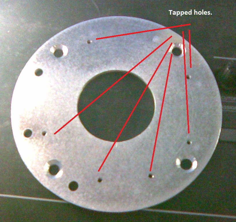

To solve this I made a mounting plate out of 3mm thick aluminium, this is fixed to the wave-guide by the 4 holes already described. Then to secure the tweeter I tapped 6 3mm holes into the aluminium so that the tweeter could be screwed into place. 4 holes are for mounting the DXT and the extra 2 are for mounting the XT25.
Three of the holes match up to the screw holes in the XT25s faceplate.

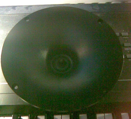

Now all that's left is to screw everything together and make sure everything is lined up.
Complete with test baffle.
Using this method it would seem extremely easy to mate any tweeter to the WG300 without too much issue, just tap more mounting holes and you're set.

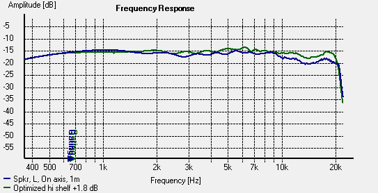

Now for the fun stuff the measurements.
First up is the XT25
The first thing to notice is the very smooth response. All these measurements were taken in unfavourable conditions, so some small room reflections show up making the response a little ragged, but overall they are pretty decent.
Like this the XT25 also has very good distortion performance too, excellent 3rd, 4th, 5th and 6+. Only the rising second harmonic @ 3khz lets it down. I originally tried running the test @ 2.8 volts rms, the tweeter wasn't happy like this at all, something buzzed around 600-900 hz, not that the tweeter would be used down this low anyway, but I had to turn it down a little for it to be happy. Due to the extra output provided by the wave-guide you could probably get away with 1500hz 4th order slopes. The buzzing sound at 900hz was caused by the phase plug arrangement and might not be present in the scan speak versions with their better quality control.
Now for the DXT.
Shock!
I thought this might happen The spacing described above is obviously not anywhere close to being adequate, this creating a huge suck out centred on 4khz. Not much to say other then that, distortion performance looks nice though.
Out with the plasticine! DXT version 2.
Ahhh much better. My 5 minute low tech filling in of the gap with plasticine has helped things considerably, the 4khz suck-out having vanished completely. Now however there's a dip in the top octave and as you go off axis another narrow suck-out appears. I am sure I could improve things considerably if I spent more time creating a better transition between the mesh grid and the wave-guide, currently it looks a bit like a 2 year old made it Distortion performance is excellent, it's clear that this is a better tweeter compared to the XT25. You might just be able to get away with a 1khz xover with 4th order slopes, this would have to be measured though to find out and I do intend on trying this out.
One thing that's interesting is the DXT distortion performance, here is a graph of the DXT in its own small wave-guide.
As can be seen there's a broad hump in the third harmonic around 1-2khz. This same hump can be seen in Zaphs measurements of the DXT too. However when using the WG300 instead of the DXTs own wave-guide this hump completely vanishes. I had assumed this was an issue with the motor/dome/chamber etc, but it appears like it's created by the wave-guide instead. Either that or the WG300 suppresses the peak.
The wave-guide appears to work rather well though, probably giving constant directivity down to around 2.5khz. The off axis curves can't really be directly compared as I didn't have a protractor around to give accurate angles, however the overall trend is easy to see. I probably went out to around 60 degrees.
This has me wanting to buy a pair of the scan tweeters I linked to before and trying those out. Tomorrow I'll probably pull some scan D2905/95s out of a finished design and test out those too.

But why would you add the waveguide to the DXT tweeter?? That would sort of be a waste of the DXT waveguide/ lens allready in place.
The idea was to use the DXT's motor + dome in conjunction with the WG300, effectively bypassing its own wave-guide completely. This did not work very well, even faffing about with the plasticine wouldn't get the top octave to come together, and although it did improve things a bit, it made the 5k region a bit lumpy.
Funny, I actually have a pair of the D2608/913000 on the shelf, bouthg them on impulse but then later decided to go for the DXT tweeter for my project..And since I allready have them, it would make good sense to try them for a future wave-guide/ CD project.
I'm going to hold off on buying any more tweeters until I've properly evaluated the wave-guide with the ones I've got. Between the D2905 and the XT, I should be able to draw some decent conclusions.
If it hadn't been for the relatively expensive shipping, I would have been happy to lend them to you for some testing!
Shipping can be a damned pain sometimes!
The short time i tried them, they did sound very nice, perhaps a touch bright in the top, you might say they made their precence somewhat more known than the very neutral sounding DXT tweeters, allbeit not in any objectionable way.
I think this has been said about them elsewhere too, they've got a very lively top end. The good thing about the wave-guide is that it should give every similar 1" dome tweeter, providing they mount to it successfully, roughly the same off axis response, making them perhaps easier to compare.
Very good mounting description by the way, and a nice adapter! Do you have access to a lathe or something?
Nah, a lathe would be nice, but we don't have the space for one really. I did all of that with the circle cutter on the router.
Will be very interresting to see what the result will be with the D2905/95s when you get arround to it!
See above The one thing that is nice though, is that the D2905 looks very use-able and it's dome/faceplate arrangement isn't anything special really. I think you'd be able to mate pretty much any 1" dome to the WG300 providing it doesn't have some complicated faceplate.
Im particularilly curious about what difference there will be between a phase-plug/ ring radiator design and a "conventional" high quality dome, so it will be great to have a comparison with the same equipment, not to mention any subjective listening impressions you might provide!
I am interested in this too, I must get the other DAC channels finished
Oh, what's that midwoofer unit I could see in some of the pictures by the way?
It's an RS225, it's an 8", which shows that the WG300 is pretty large 170mm diameter.

did a measurement without the HF equalisation as input to LSPCAD and ran some optimalisations. No huge changes, merely a 2 dB boost at 15k and about 0,8 dB at 5k relative to what I was allready running.
Modified the filters and put them back in; Perfect! Now there is no feeling of anything missing, and yet no signs of excessive HF or listening fatigue. things finally came together.
Enclosed, you can see measurements before and after this last tweak. Obviously not dramatic, but this was all it took to get it right!
(Bear in mind that as my mick is home-buildt running a "generic" calibration file, the measurements are not absolute in the upper frequencies.)
