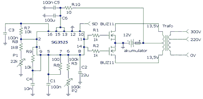

SG3525 for Inverter
norazmi said:
Hi N. Channel,
....Vcc is 12V from batt right?
Yes, from 12V Battery Supply.
norazmi said:
Ive seen on output schematic there is lots of irf1404 mosfet so can i just make it 4 of them, ie. irfz44N? because i just need 300 watts only.... and at output mosfet is IRFP250N i would change to IRF740 4 pcs is ok with it? because i would have 240 vac at output. About the ics tl494 is ok for me i`ve it on my hand, but as you mention it can be change to SG3525AN without any adjustment? i mean for the pin leg.
And what the function for VR1 and VR2 ? freq control?
IRFZ44n should do fine. IRFP250N is for 120VAC output. The IRF740 (Vdss = 400V) is appropriate for 240VAC out.
SG3525 is NOT a drop-in replacement. Obviously, there are some component- & value changes that will need to be made, but, for the most part, it should work OK.
VR1 controls output frequency (in this case 120Hz), you will want to adjust it for 100Hz.
VR2 is for sensing the 120VAC output to provide for voltage regulation.

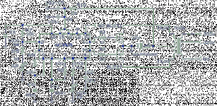

N-Channel said:
Luka-
I may have made a mistake, I think it is 100Hz. Sorry.
Azmi-
See the two attached schematice on a 2.5kW Inverter. First one is DC-DC boost converter driven by TL494. This can be easily changed to an SG3525, and it might be easier because of the '3525's outputs being totem-pole. The second schematic is of the DC-AC Inverter, driven by a second TL494, programmed to run at 120Hz (2 x 60Hz).
This should clear a few things up.

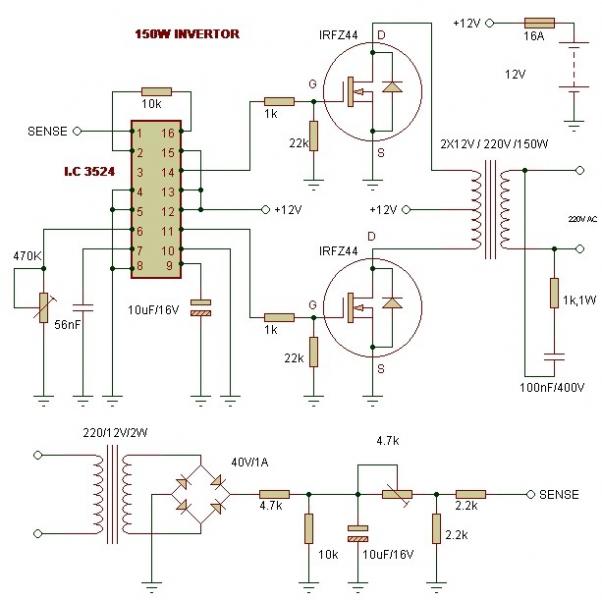

pls am working on a switch mode 1kva inverter,from given block diagram,its includes; 12volt dc source,oscillator (sg3524 @50khz pulse),mosfet swiches,ferrite core transformer (12V/350V @ 50KHZ),Rectifier,modulator,mosfet bridge,filter,wit an output of 230V @ 50HZ.i av bin able to work up to the switch but i rili dont no hw to go abt d transformer (no material,u can just help me post any material on it), also i dont no d component and d function of d Rectifier,modulator, and d mosfet bridge.also hw can i b able to achieve my desired output,pls i nid detailed explaination.
hi,
i want to make an inverter in order to use it at a diy ups for my pc...
i think that with 400 wattw i will be fine...
i want a swich mod inverter...
can you help me find a circuit?
i saw the 2.5 kw inverter circuit but it's to big for my needs and for the knowlege i have at elektronics...
i think i need a true sinewave inverter to run the pc...
can you help me?
