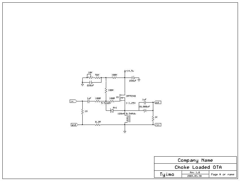

Here is the schematic.
I think it is as simple as possible!
I forgot some parameters:
Case weight: 15Kg
Temp: only around 40C. (!)
Greets:
Tyimo
P.S.: No CCS, No resistor! Choke Load is RULEZ!!

Thanks Mads!
Yes. I think it is very good for keep the amp noiseless. I used to built my JLH1969 the same way.
What do you think what could be better: to use two 100R gate resistor like i did or only one 220R?

Do you really need the 8R2 between GND and 0V?

Try to short them and listen if you can tell the difference. It will give you test of your grounding arrangement; you shouldn't need it
The two 100R's perform two different tasks. The first one is to shield the source (preamp) from looking directly onto the zener (also, it slows down the charge/discharge of its capacitance), the second to keep the mosfet from parasitic oscillation
If you want, you could place the first 100R directly in line with the zener, to have only 100R in series with the mosfet gate

Thanks. So I will leave as it is.The two 100R's perform two different tasks.
