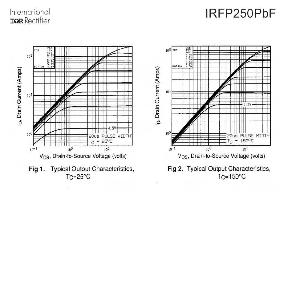

IRFP244 is a good choice. Low Crss, but high RDSon. Excellent linearity. I'd rather have a IRFP250 because of the lower RthJC and lower RDSon (lower heat and voltage losses) It is unlikely to sound any better than the 244 though (not much worse either, I don't think I could pick IRFP 040, 140, 240, 244, 250 in a blind test.
Yup, BOZ and SEWA is a very nice combo
Attached is IRFP250 curves. I'm runnig on TC=63'C
edit: I'm not afraid of using the newer "N" devices either. The reason I drew in the IRFP150N in the original schematic was that it is almost half the price of the IRFP240 when bought in small qty's.
But, left the choice I would buy non-"N" devices. They have smoother curves.
Also, I'm left with the sneaky feeling that, for SEWA, it does not matter very much wich one you choose. Input C (Crss) is very low, and does not matter much anyways, because we have no feedback. My guess is that if I had a distortion analyzer, I would't get much different results.
According to Nelson, one IRFP250 equals two IRFP240 in paralell.
I think I will recommend the IRFP250, since SEWA is Zen's big brother than CAN play the bass
